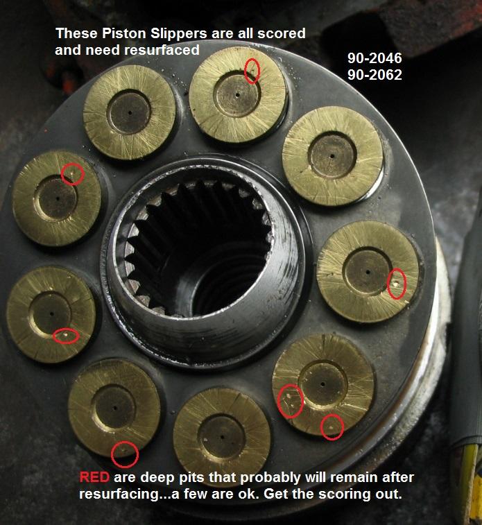

daveoman1966 3,884 #108 Posted April 16, 2019 (edited) That looks like a new Parking Pawl....nice weld-up. The reason this gets 'ground down' is from yanking up the Parking Brake while in motion. Every time someone does a 'panic stop' like that, a bit of the pawl gets chipped off...worn down and...guess where the filings go... floating thru the entire system, scarring and damaging the soft BRASS components like the piston slippers and valve plates. It is kinda like throwing your car into PARK, while moving. Don't get me wrong...I'm not lecturing, just want to get this out there in Red Square land...so all will know. Don't EVER pull up the Parking Brake lever while moving. There is even a decal warning of this. Edited April 16, 2019 by daveoman1966 2 Share this post Link to post Share on other sites

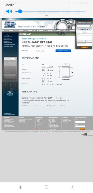

gt14rider 1,268 #110 Posted April 18, 2019 Next issue, transmission 5070 bearing M 16101 1 x 1 1/4 x 5/8 is unavailable,was suggested to use, M 16081, 1 x 1 1/4 x 1/2. Having trouble finding, any suggestions on where to purchase. Thanks Share this post Link to post Share on other sites
pfrederi 20,924 #111 Posted April 19, 2019 I just reuse the originals . never found one that was in bad shape. Share this post Link to post Share on other sites
gt14rider 1,268 #112 Posted April 19, 2019 Found this place, asked for a quote, but not herd back yet Share this post Link to post Share on other sites
gt14rider 1,268 #113 Posted April 20, 2019 11 hours ago, pfrederi said: I just reuse the originals . never found one that was in bad shape. Check out the bearing seams ok, I'll probably go a head and use it. I'm a little anal to always replace with new bearings Share this post Link to post Share on other sites

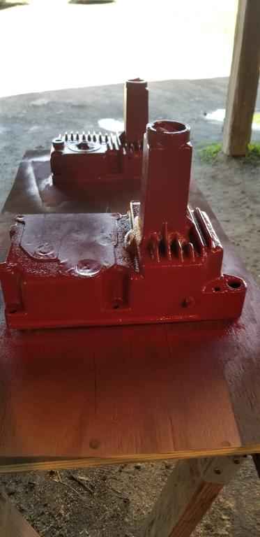

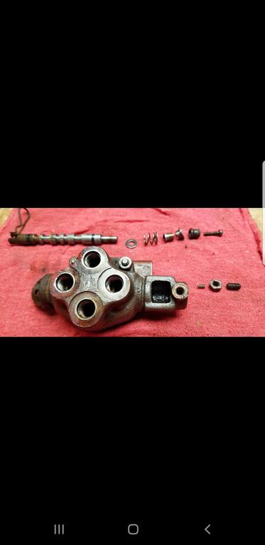

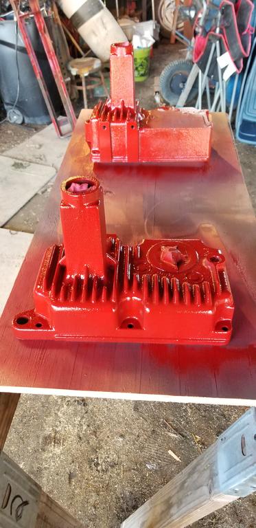

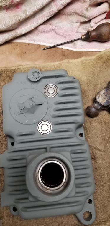

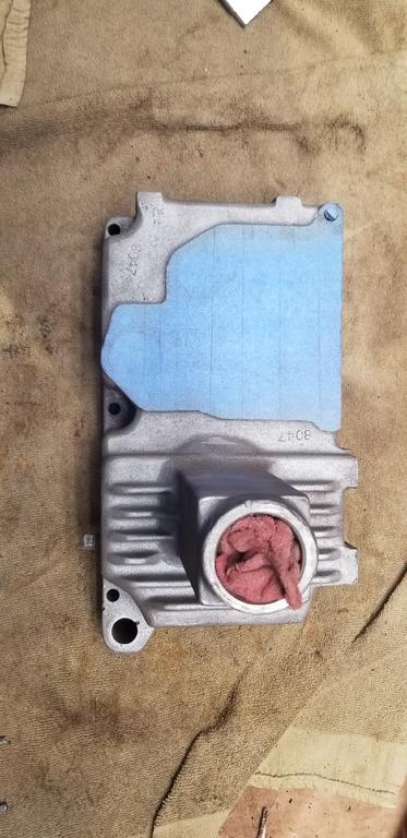

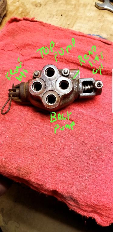

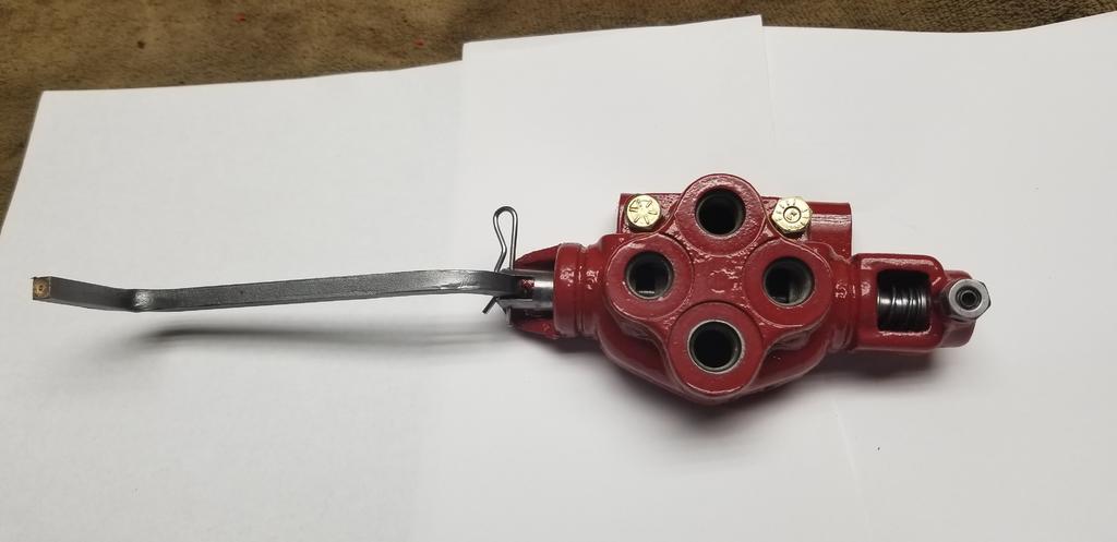

gt14rider 1,268 #114 Posted April 29, 2019 Little progress on tranny, cleaning things up. Got the lift valve cleaned up with new seals. Cleaning up cases, seals and bearings should be here in a couple of days Share this post Link to post Share on other sites

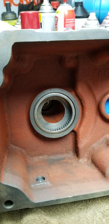

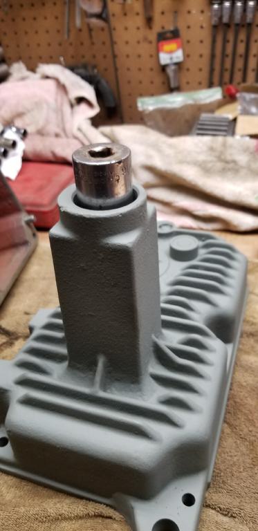

gt14rider 1,268 #115 Posted May 7, 2019 Got the bearings in and some paint 1 Share this post Link to post Share on other sites
19richie66 17,930 #116 Posted May 7, 2019 Looking good Share this post Link to post Share on other sites
