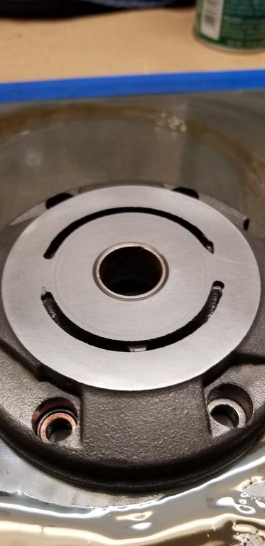

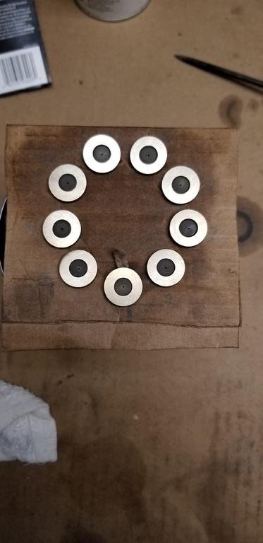

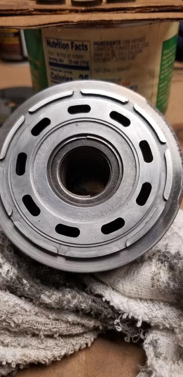

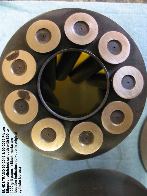

gt14rider 1,278 #31 Posted March 15, 2019 Hay all been trying to work on the pump but wife has other plans up to my eye ball in a bathroom remodel. Can someone chime in on what grit sandpaper to stop at. I'm at 800 and the pistons and pump don't look to bad Share this post Link to post Share on other sites
19richie66 17,932 #32 Posted March 15, 2019 What is it with gt14’s, wives and bathroom remodels 4 Share this post Link to post Share on other sites
pfrederi 21,095 #33 Posted March 15, 2019 Nice job!!! I went to 1000 and then crocus cloth but yours look good maybe just a light dose of crocus cloth to shine them up a bit.... Share this post Link to post Share on other sites
Aldon 4,832 #34 Posted March 15, 2019 Likewise I went to 1000 1 Share this post Link to post Share on other sites
AMC RULES 37,259 #35 Posted March 15, 2019 1 hour ago, 19richie66 said: What is it with gt14’s, wives and bathroom remodels Precisely why you won't find that model in my collection. 3 Share this post Link to post Share on other sites

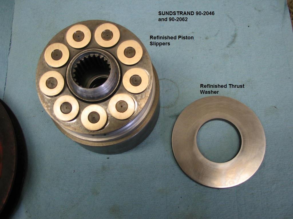

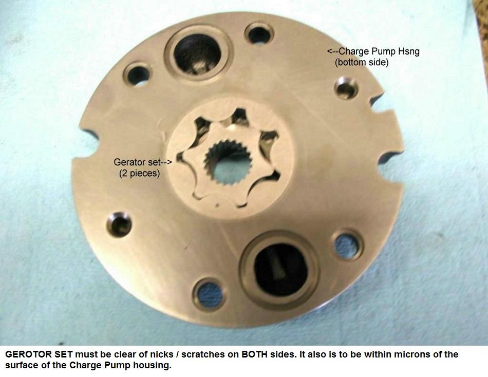

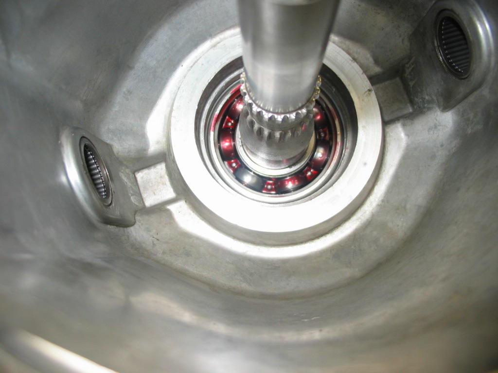

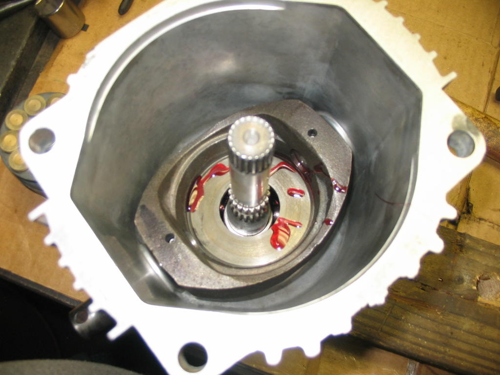

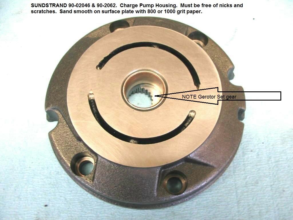

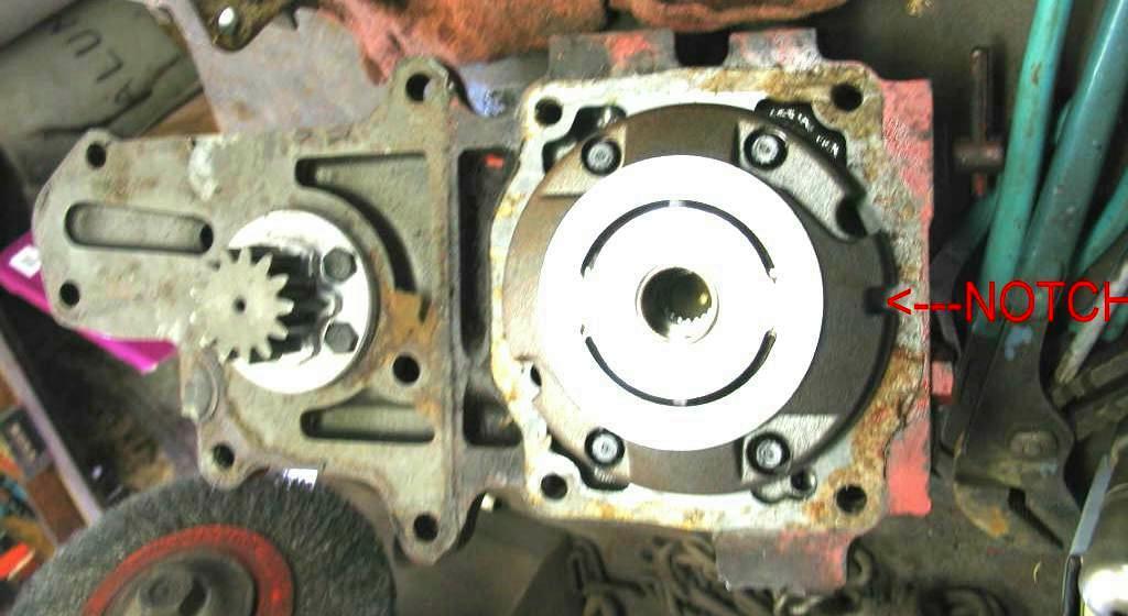

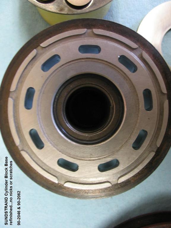

daveoman1966 3,884 #36 Posted March 15, 2019 From these 2 pics your Piston Slippers and Charge Pump Housing face look good. You MUST also resurface the Base of the Cylinder Block and the Thrust Washer. Be sure to locate the charge pump housing correctly...note NOTCH location. Here are a few helper pics... Keep EVERYTHING clean on reassembly and use ASSEMBLY OIL on any and all contact surface to prevent 'dry start' of freshly finished parts. (Thats the red oil you see.) 1 Share this post Link to post Share on other sites

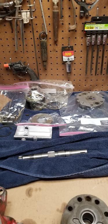

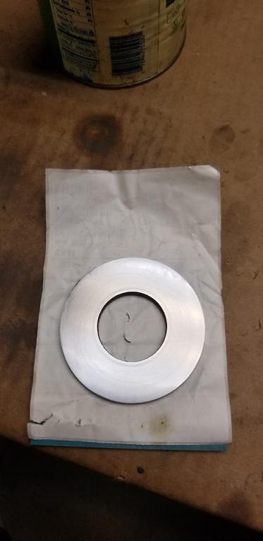

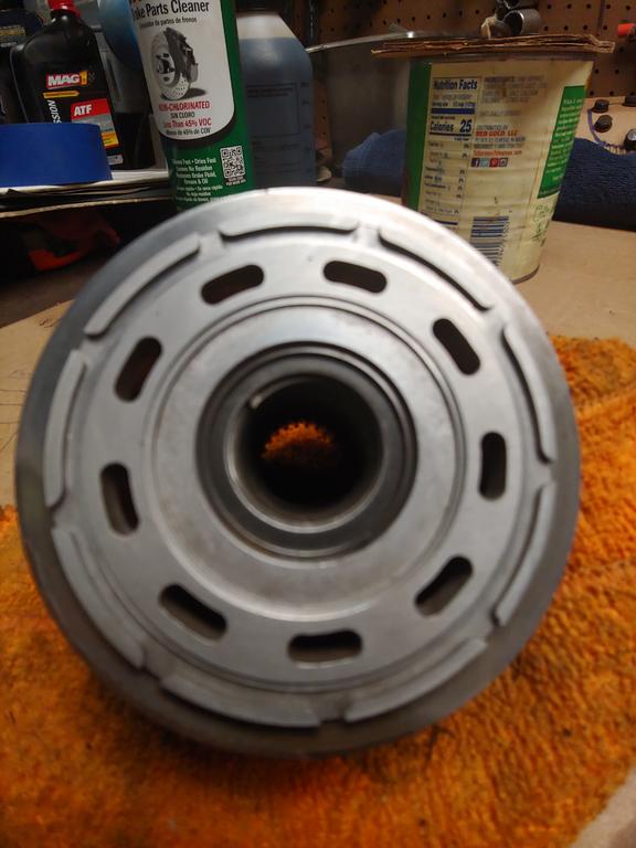

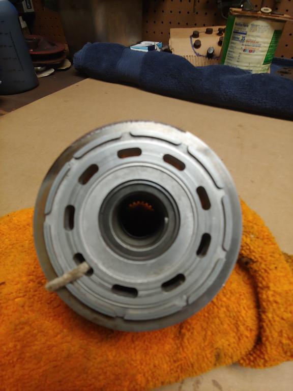

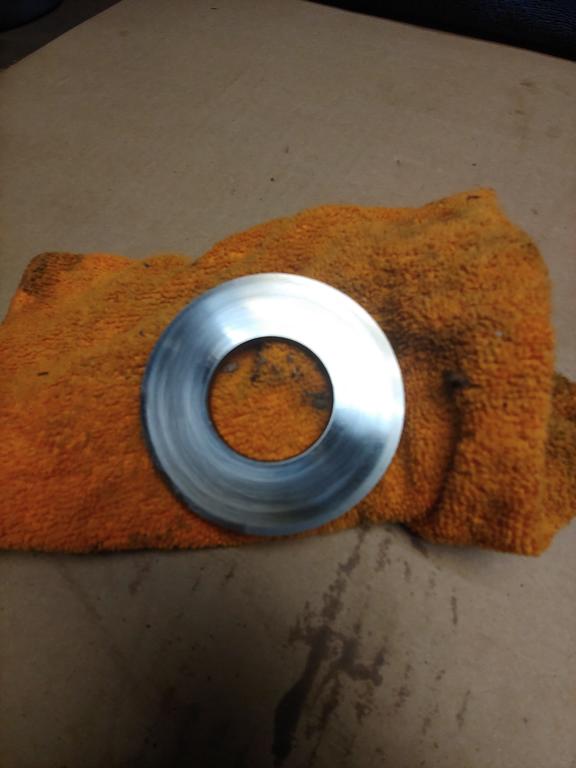

gt14rider 1,278 #37 Posted March 15, 2019 (edited) Here are the other parts still working on them. How do the last two look? Edited March 16, 2019 by gt14rider Update Share this post Link to post Share on other sites
daveoman1966 3,884 #38 Posted March 16, 2019 As long as you get out the deep scores and gouges...good to go. You don't need a mirror finish on these parts...just a dull buff is good. As for spring tension load.... Collectively between the material removed from the piston slippers, the thrust washer, and the base of the cylinder block, there MAY have been enough material removed to lessen the spring tension. To compensate for this (maybe an overkill) I usually cut open an alum beer can (have a few) and cut out a shim (or 2) to just undersize of the thrust washer and install that shim BEHIND the washer. Shim is out of the way and is stationary so as not to interfere with any movement or rotation...it just sits there. 2 Share this post Link to post Share on other sites

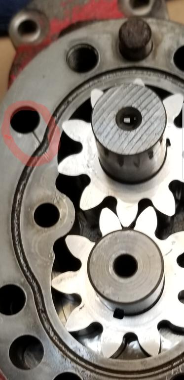

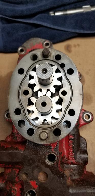

gt14rider 1,278 #48 Posted March 16, 2019 Ok got most of pieces done and cleaned and bagged, so that stay clean. Next pump housing, can I just pull gears and leave bearing in, clean in kerosene, blow compressed air to dry reassemble? Oh see scratch (in red) someone's been here before, what do you think Share this post Link to post Share on other sites
pfrederi 21,095 #49 Posted March 16, 2019 Never went into the gear pump side of a hydro. I leave them alone. Mine seem to work, clean up the piston pump end but I leave the gear pump alone. Cna't say what the scratch could cause. Was it leaking before?? Share this post Link to post Share on other sites
gt14rider 1,278 #50 Posted March 16, 2019 (edited) Don't know if it leaks, parts tractor, sat for about 15 years that I know of. Reason I want to take pump apart is trans fluid has turned to a strawberry jelly like muck, just want to flush everything, clean clean clean, next Is lift valve and lift cylinder, hoses Edited March 16, 2019 by gt14rider Share this post Link to post Share on other sites
