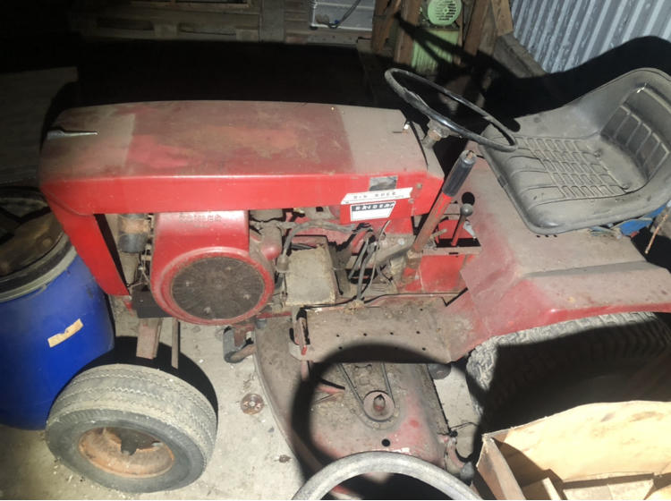

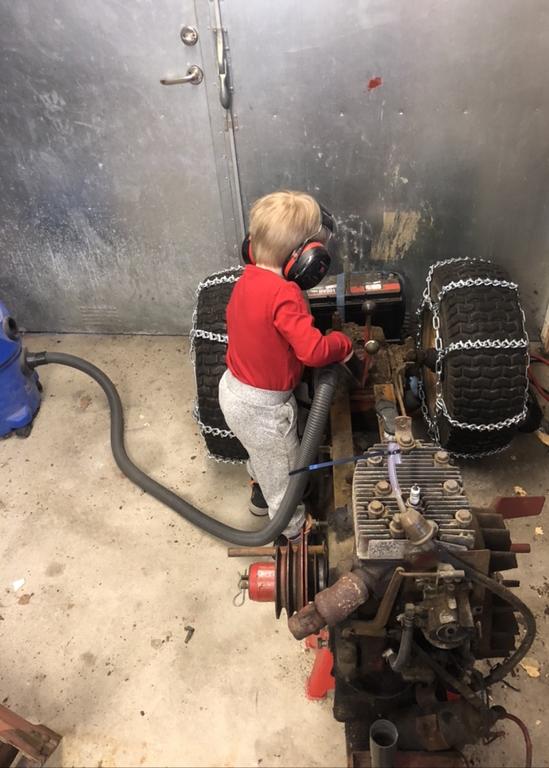

LennieM 59 #1 Posted February 21, 2019 Hi all! New member from Sweden here. Picked up what i think is a Raider 12 just the other day. It had not been running for many years but some new fuel and a new sparkplug and battery and it fired right up! It is meant to be used mostly for snow-blowing and plowing, but after looking around i really felt like it deserves a restoration (didnt think they where this popular mostly bought it because it looked cool and something for my 3y old son to ride around the yard on) After some test runs in the snow i am really impressed by the little beast. The son was happy too! So after trying it out we took it to the garage and started taking it apart... Did get the motor of and the frame off the axle and put some paintstripper on the frame but have no pics of that. Did order some 3 ribbed front tires and tractor type rear tires to make it look more like a tractor than a lawn-mower. Will try to post pictures as the restoration progresses if you guys find it interesting. 1 8 1 Share this post Link to post Share on other sites

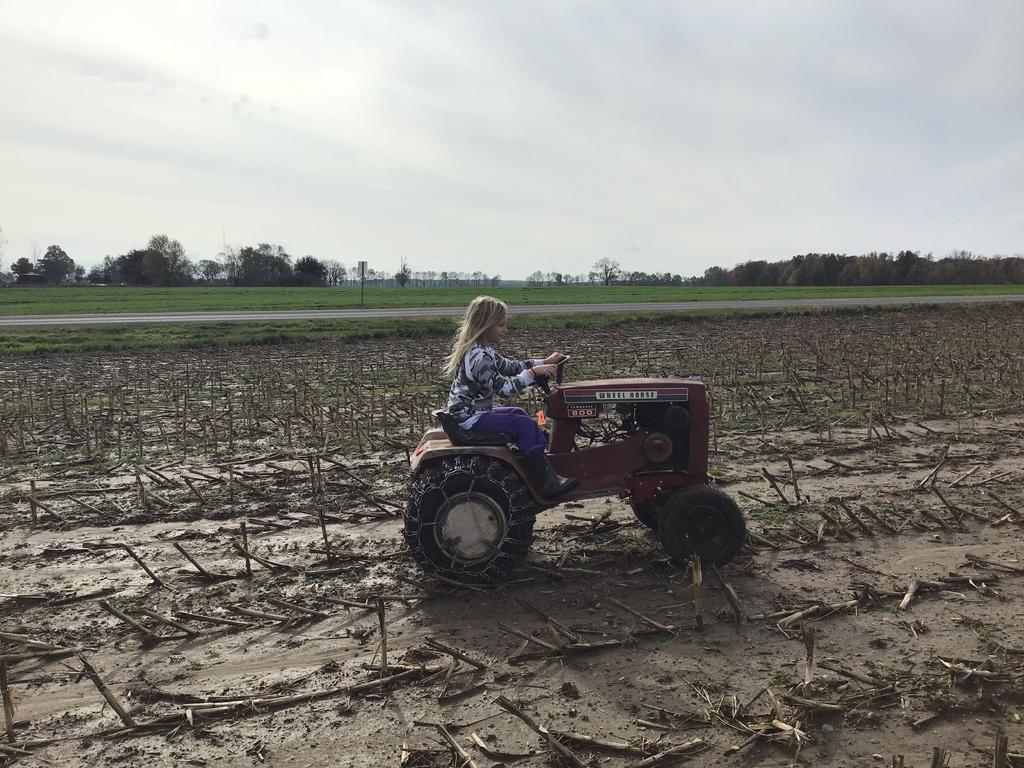

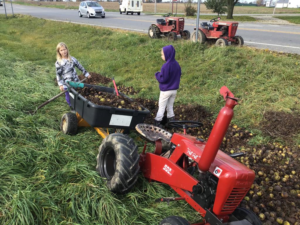

Pullstart 71,482 #4 Posted February 21, 2019 to @LennieM! Great tractor project, and you’ve got some fine help in the garage! My kids enjoy their Wheelhorse tractors too! Here’s some inspiration from the left side of the pond... The little one in the fuzzy pink outfit isn’t mine, she was just riding along for the day. 2 1 1 Share this post Link to post Share on other sites

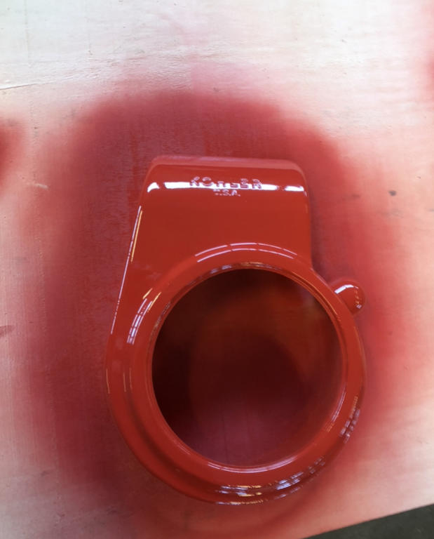

LennieM 59 #5 Posted February 21, 2019 Cool! Thank you all! The tractor is almost complete i think. Dont think i will be using the muffler that is on it hopefully i will find something better looking... I currently have some parts that i have had the paint stripped off and are currently in a bath of cictric acid to remove all rust. Looking forward to paint some primer and paint. The rims will be Wimbeldon white but the body i have choosen Ral 3000. Might not be a perfect match but we did happen to have some 2K paint leftover of ral3000 and i cant tell the difference and it will save a couple of $$$. Also i did notice that there is no solenoid for the starter just a real big button under the hood to start but that will be a later problem to look into. got some paint on the engine fancover with Ral 3000 does it look terrible? 1 4 Share this post Link to post Share on other sites

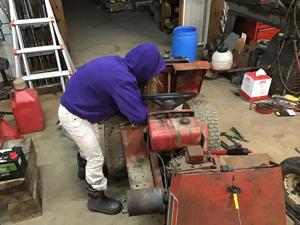

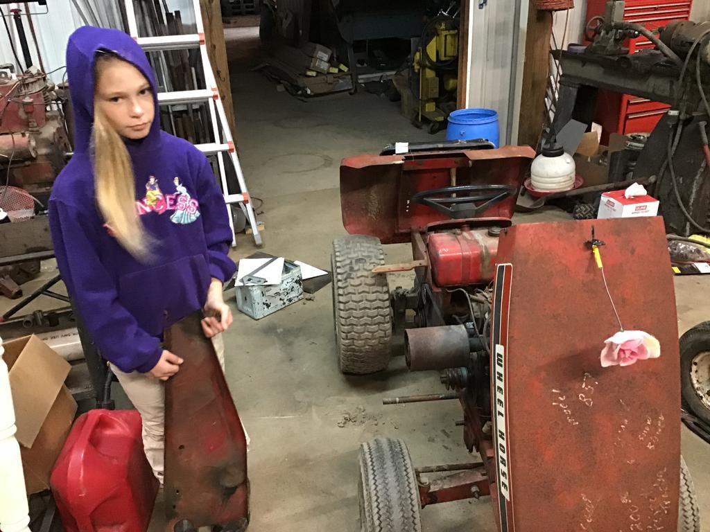

Ed Kennell 47,751 #6 Posted February 21, 2019 27 minutes ago, pullstart said: to @LennieM! What's the story on the walnuts? 1 Share this post Link to post Share on other sites
Pullstart 71,482 #7 Posted February 21, 2019 5 minutes ago, Ed Kennell said: Gathering them to toss out back. We shelled them in the driveway and had a go at burying them randomly in the field. Trying to create a habitat for animals from whatever “seeds” we can out of 6 or so acres. The grass we started with yielded those two bucks last fall, it should only get better from there. 1 Share this post Link to post Share on other sites
Mike'sHorseBarn 3,704 #8 Posted February 21, 2019 25 minutes ago, LennieM said: Cool! Thank you all! The tractor is almost complete i think. Dont think i will be using the muffler that is on it hopefully i will find something better looking... I currently have some parts that i have had the paint stripped off and are currently in a bath of cictric acid to remove all rust. Looking forward to paint some primer and paint. The rims will be Wimbeldon white but the body i have choosen Ral 3000. Might not be a perfect match but we did happen to have some 2K paint leftover of ral3000 and i cant tell the difference and it will save a couple of $$$. Also i did notice that there is no solenoid for the starter just a real big button under the hood to start but that will be a later problem to look into. got some paint on the engine fancover with Ral 3000 does it look terrible? That paint looks great if you ask me. I use International Harvester Red for my restorations and that color looks just about identical. Mike 1 Share this post Link to post Share on other sites

Guest 88vic #11 Posted February 21, 2019 I also have a 68 Raider 12, it sat outside in a field for 15 plus years. I saved it from going to the crusher. Replaced a couple parts on the engine and she fires and runs on her own ! Will be painting it soon. Just curious what your serial number is, id like to see how close it is to mine. Share this post Link to post Share on other sites

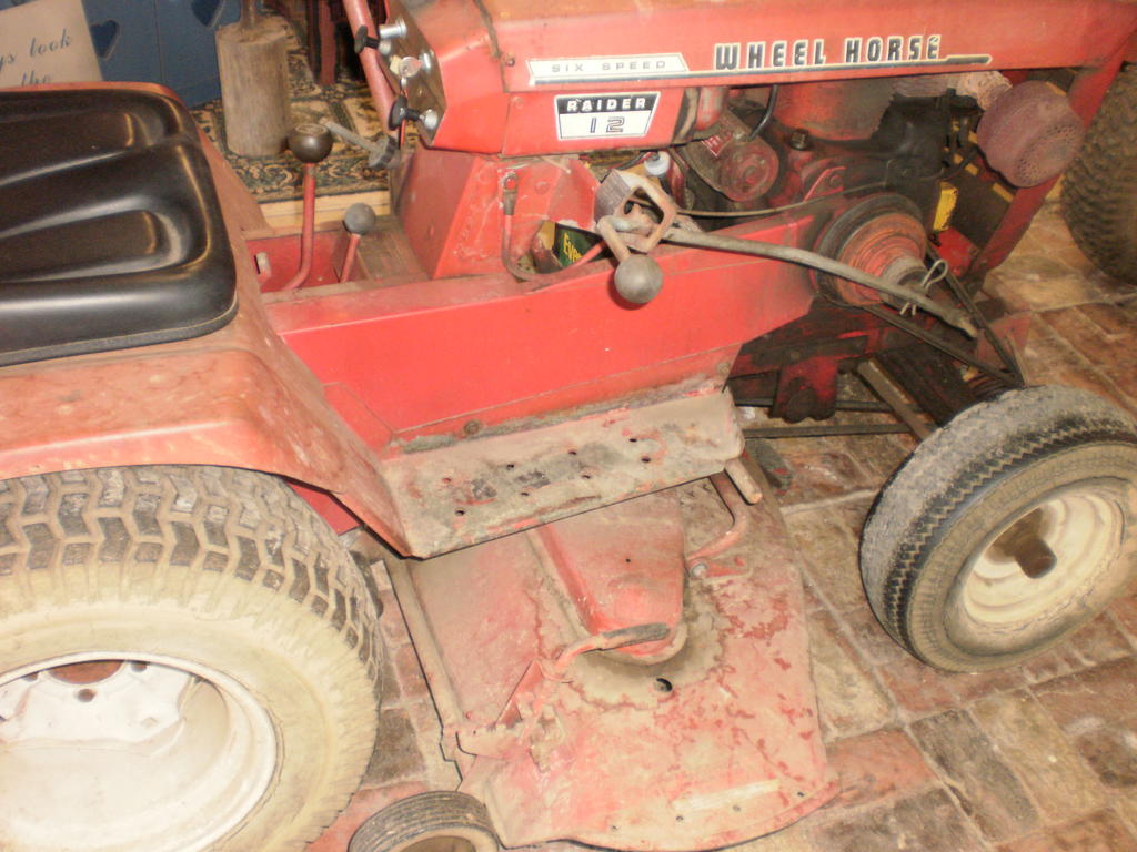

520HC 209 #12 Posted February 22, 2019 Another 68 Raider 12 2 Share this post Link to post Share on other sites

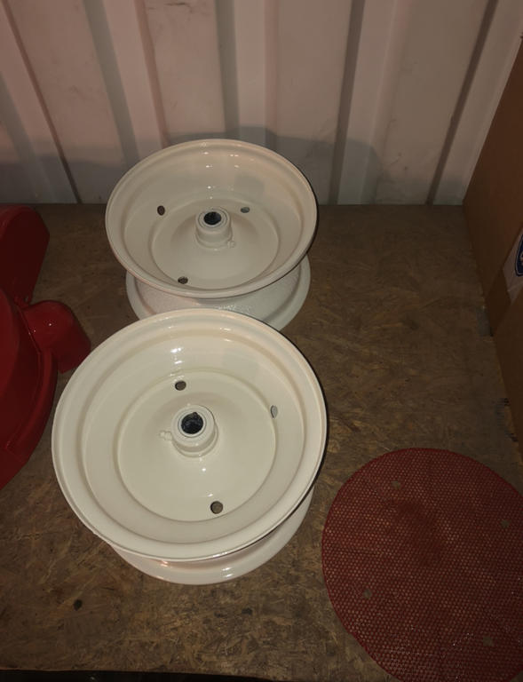

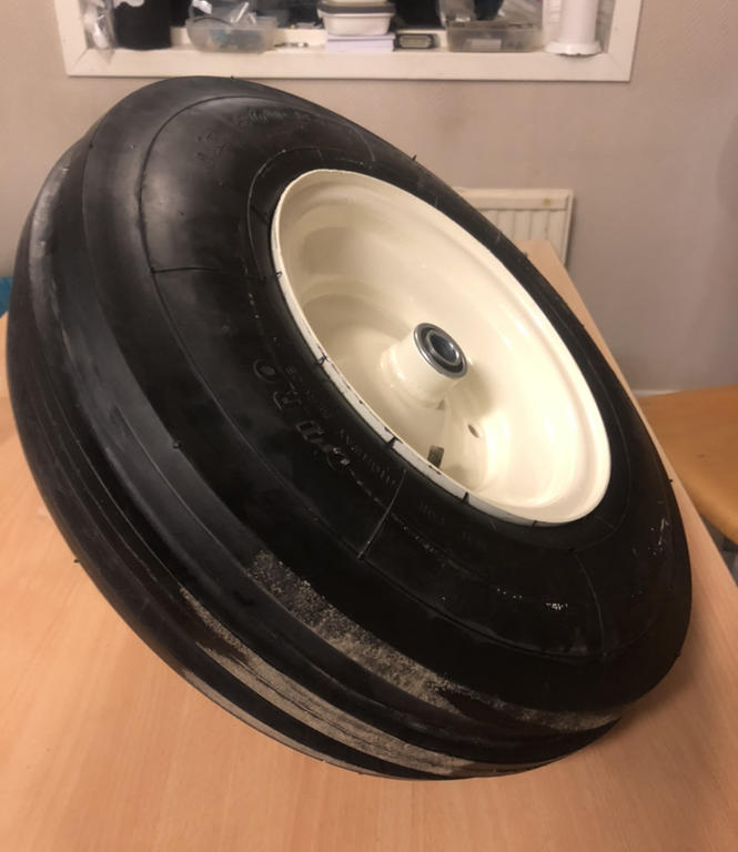

LennieM 59 #13 Posted February 22, 2019 Made some progress today not much but its something. Waiting for new wheelbearings they got stuck in customs. 5 1 Share this post Link to post Share on other sites

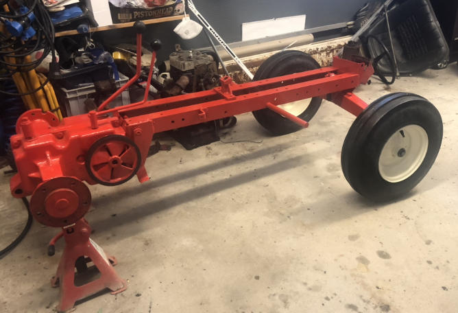

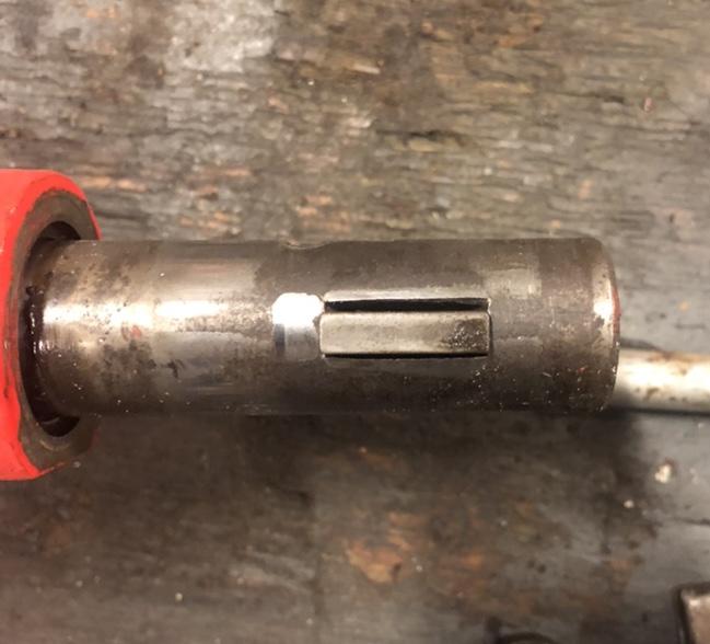

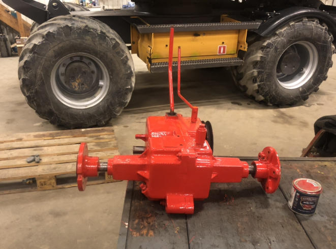

LennieM 59 #14 Posted March 4, 2019 Not that much has happend during the last week (whole family caught the flu) but did mount the tires today and replaced the bearings. And i did get some paint brushed on the gearbox. The keyway was not in the best shape so that will be welded up and shaped back to its original shape. 3 4 Share this post Link to post Share on other sites

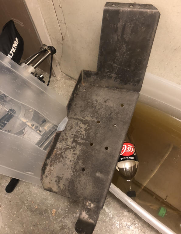

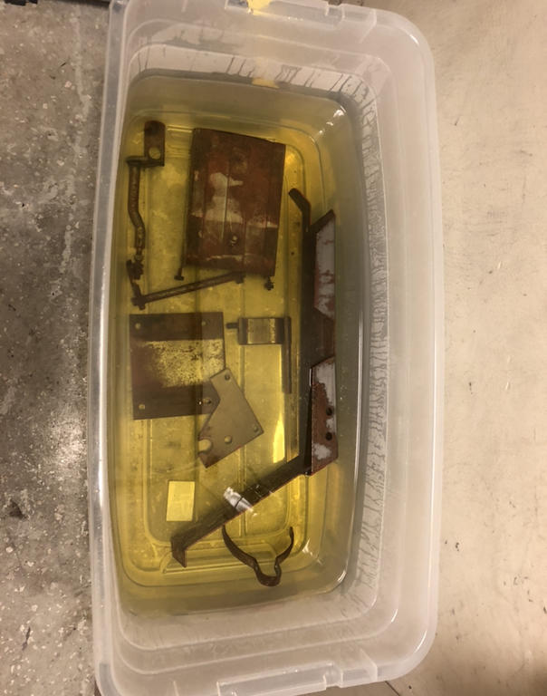

LennieM 59 #15 Posted March 6, 2019 Here are some pictures of my tub with citric acid and water for removing rust. The citric acid powder you can buy here in sweden in food stores but i bought it from a company on the internet who sell bigger quantities i bought 5 kilograms and mixed that with 50liters of water and will let the parts be in there for about 24 hours then the rust should be gone. Here is a footstep before picture.. i did put it in first but thought it might be good to have pictures so thats why its wet.. i will post the finished process in about 24 hours or so.. 2 2 Share this post Link to post Share on other sites

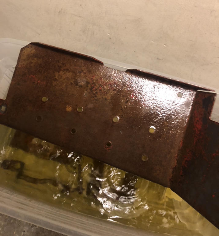

LennieM 59 #16 Posted March 7, 2019 not quite done yet ill leave it in for another 24h... Much better than it was to begin with but still some rust in the corners. 4 Share this post Link to post Share on other sites
LennieM 59 #17 Posted March 8, 2019 So took out the parts today and it was a little better so its good enough not that much different than last picture so i wont post another picture.... Will be bolting the frame to the gearbox soon and the front axel too so i can mount my new tires and the painted rims to see how it looks. 2 Share this post Link to post Share on other sites

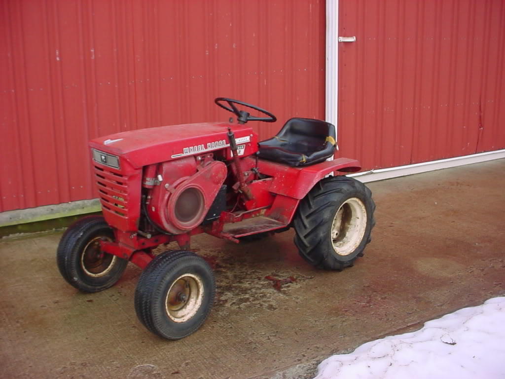

Digger 66 3,530 #19 Posted March 9, 2019 Welcome aboard . I have your tractors little brother 1 Share this post Link to post Share on other sites
ebinmaine 81,048 #20 Posted March 9, 2019 1 hour ago, LennieM said: Should have taken the time to take some more pictures before disasembling.., Hopefully there is a spare part catalog or such on the forum to take a peek into... No worries there Lennie There's plenty of documentation and also many of us have whole Tractors and are willing to help you locate parts or assemblies when and if you need it. 1 Share this post Link to post Share on other sites
LennieM 59 #21 Posted March 9, 2019 Cool tractor there Digger66 ! what size are those rear tires? Im planning on 23x8.5 - 12 but is it possible to fit taller tires without cutting out the fenders? Share this post Link to post Share on other sites
Digger 66 3,530 #22 Posted March 9, 2019 27 minutes ago, LennieM said: Cool tractor there Digger66 ! Thank you ! what size are those rear tires? Yes 23 X 8.5 X 12 . Stock size . Im planning on 23x8.5 - 12 but is it possible to fit taller tires without cutting out the fenders? I have no idea , I went with the stock dims hoping nothing would need to be cut and nothing did Share this post Link to post Share on other sites

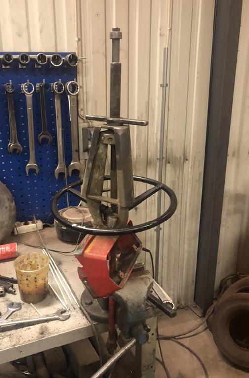

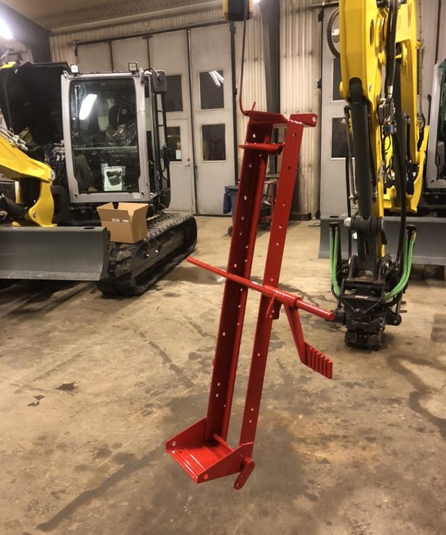

LennieM 59 #23 Posted March 27, 2019 Took quite a bit of power to get the steering wheel of the steering shaft... Was just about ready to give up when made a big bang and finally got loose. Now it is just these 2 parts and the hood left until its time to put everything togheter... 2 Share this post Link to post Share on other sites
953 nut 70,066 #24 Posted March 27, 2019 On 3/9/2019 at 10:45 AM, LennieM said: Started to put some togheter today and i think it will be lookin cool when finished.. Should have taken the time to take some more pictures before disasembling.., Hopefully there is a spare part catalog or such on the forum to take a peek into... This should do the job. The pulley you have on the transmission was used on the automatic transmission tractors and is much larger. With that pulley your will move rather slowly. That is quite a nice puller you have there! Share this post Link to post Share on other sites
LennieM 59 #25 Posted March 27, 2019 Ok i did not know about the pulley it seemed to move fast enough for me when i tested it but then i dont know how fast these would travel but i would say it moves as fast or faster than all other lawn mowers i have been riding. The puller is really nice, you can tighten the arms to keep them from sliding out and that helps allt. 1 Share this post Link to post Share on other sites
