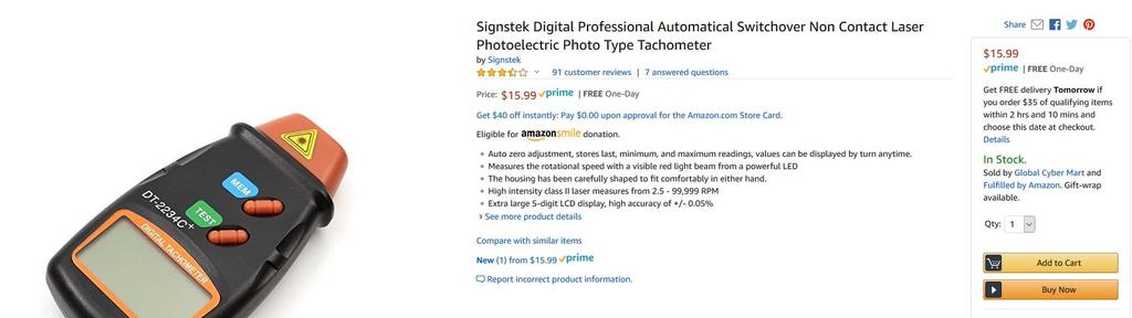

pfrederi 20,881 #29 Posted February 18, 2019 I use one of these. Checked when i first got it against a good mechanical tach seemed accurate Share this post Link to post Share on other sites
clueless 3,427 #31 Posted February 18, 2019 3 hours ago, pfrederi said: I use one of these. Checked when i first got it against a good mechanical tach seemed accurate That's the one I use, works great, just put a little of the reflective tape on the flywheel screen, then point and shoot. Share this post Link to post Share on other sites

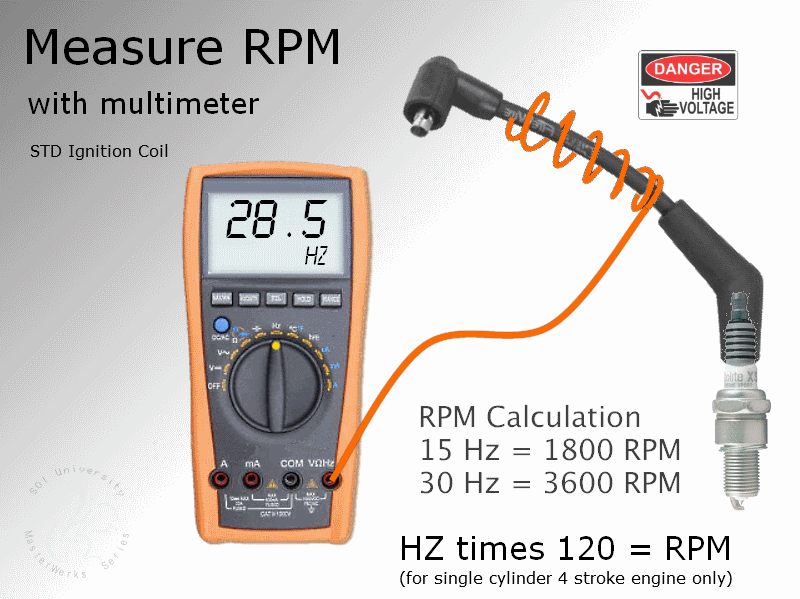

squonk 47,421 #32 Posted February 18, 2019 I have a laser tach, and one of these: I'm going to try the multimeter trick. are the number of turns on the coil wire critical? Definitely get the RPM checked Sounds over 4000 to me! Share this post Link to post Share on other sites
tunahead72 2,635 #33 Posted February 18, 2019 2 hours ago, oldredrider said: Mmmm… It's a bit more complicated than this drawing would indicate. Here's the complete thread for anybody who wants to give it a shot (I'll pass, but thanks): 1 Share this post Link to post Share on other sites

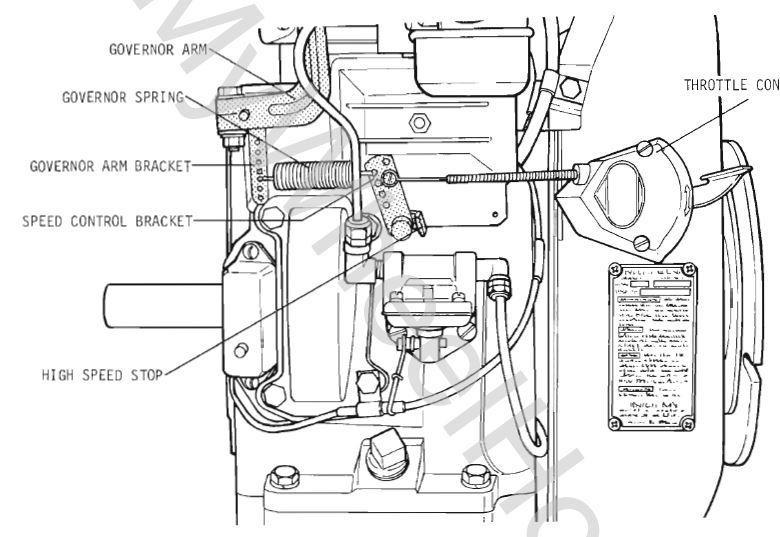

ebinmaine 79,729 #34 Posted February 18, 2019 You folks think maybe I've got a spring in the incorrect notch? Share this post Link to post Share on other sites
pfrederi 20,881 #35 Posted February 18, 2019 1 hour ago, ebinmaine said: You folks think maybe I've got a spring in the incorrect notch? That adjusts the governor sensitivity you have to adjust the high speed stop. Share this post Link to post Share on other sites
ebinmaine 79,729 #36 Posted February 19, 2019 4 hours ago, pfrederi said: That adjusts the governor sensitivity you have to adjust the high speed stop. Ah ya ya ya ..... You know what my engine doesn't have? A high speed stop.... I'll "borrow" one from the parts pile. 1 Share this post Link to post Share on other sites
