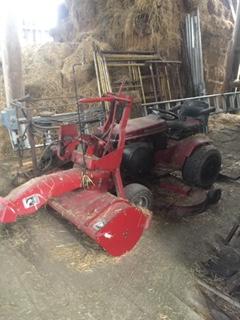

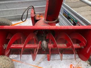

Reel Mower Freak 125 #1 Posted February 17, 2019 I just couldn’t pass on this one. I’ve always wanted a bigger Horse for yard work and this one came up. I was told it was low on power while cutting grass and mech told them it was too expensive to fix so it was driven in the barn and parked. Two/ three years later it’s mine. Looking forward to digging into this project hopefully sooner than later. 520HC with wheel weights and chains. 60” deck. 48” two stage blower that looks pretty much unused. 3 Share this post Link to post Share on other sites

The Tuul Crib 7,354 #3 Posted February 17, 2019 Excellent find those kind of deals don't come around in my area! A little clean up and you'll be ready to go! 2 Share this post Link to post Share on other sites
cleat 9,405 #4 Posted February 17, 2019 The HC is my favorite. You will love it once you get it running properly. 1 Share this post Link to post Share on other sites

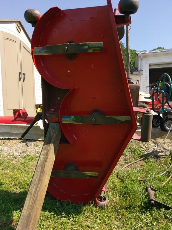

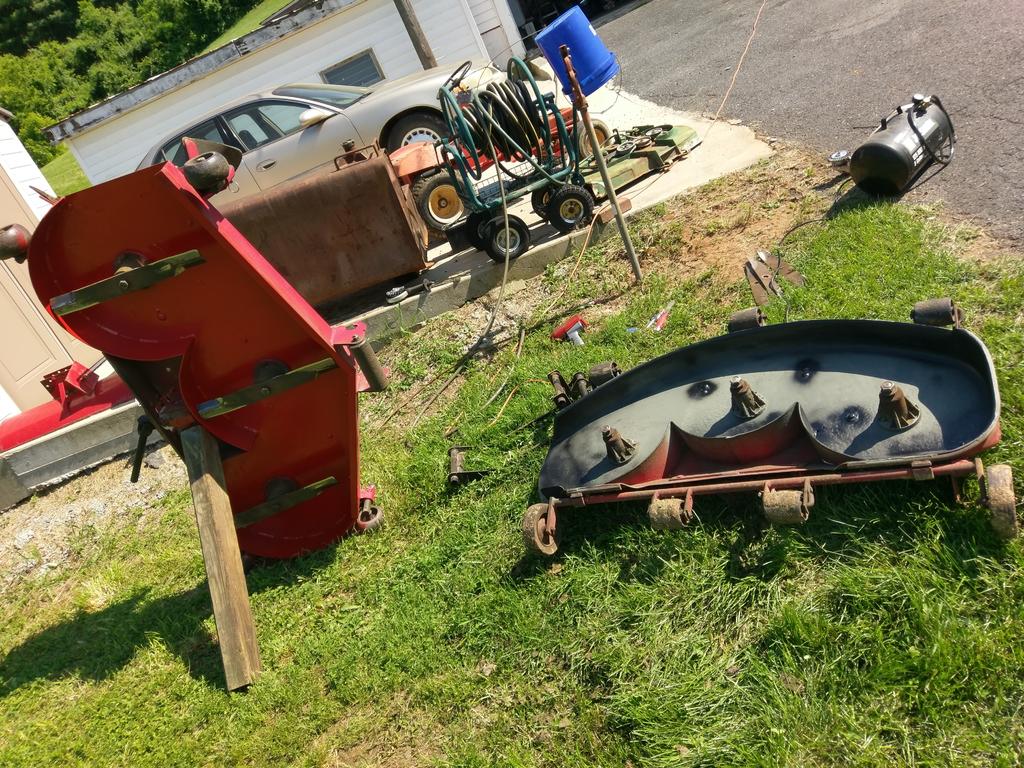

Reel Mower Freak 125 #19 Posted February 18, 2019 It’s every bit of that 340lbs. I was shocked when I loaded it on the trailer. Wow. Share this post Link to post Share on other sites
WildmanC120 615 #20 Posted February 19, 2019 Wow. I never would have thought that deck would weigh that much. There is one for sale close to me for $100. It needs the bearings replaced in the spindles but the deck is solid. I might pick it up as I can change bearings pretty easily. Share this post Link to post Share on other sites
WVHillbilly520H 10,379 #21 Posted February 19, 2019 6 hours ago, WildmanC120 said: Wow. I never would have thought that deck would weigh that much. There is one for sale close to me for $100. It needs the bearings replaced in the spindles but the deck is solid. I might pick it up as I can change bearings pretty easily. Yep same deck on the xi series I had, but Toro had finally figured out an easier way to wrestle it out from under the frame, the front anti scalp wheels swiveled sideways as well as a rear wheel that came down to help with removal vs the classic style...that 60" deck on my eMax is closer to 400# but it's a drive over unit...here's a couple of it one with my 520s 48" deck. Share this post Link to post Share on other sites
cleat 9,405 #22 Posted February 19, 2019 (edited) The 60” deck spindle bearings are 6205-2RS. I just remove the inner seal on both bearings for greasing or you can leave them sealed and not grease the spindles. It's up to you. Cleat Edited February 19, 2019 by cleat 1 Share this post Link to post Share on other sites
Reel Mower Freak 125 #23 Posted February 19, 2019 My deck turned into a drive over deck whether it was designed that way or not. I just dropped the deck and we pushed the front backwards over it. It wasn’t sliding out on that uneven wood barn floor. 1 1 Share this post Link to post Share on other sites
peter lena 10,109 #24 Posted February 19, 2019 reel mower freak, sounds like you are really getting after it, good going on that ! as you know, you are eliminating problems at every turn, that recovery desire is what this site is all about. seeing those mower decks upside down and getting the warming sun along with a good clean out and oil spray down will keep those decks alive ,and kill the moisture rot. Been doing that for years, thank you for taking us along with pictures , we are with you, pete 1 Share this post Link to post Share on other sites
