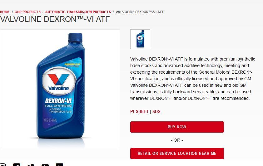

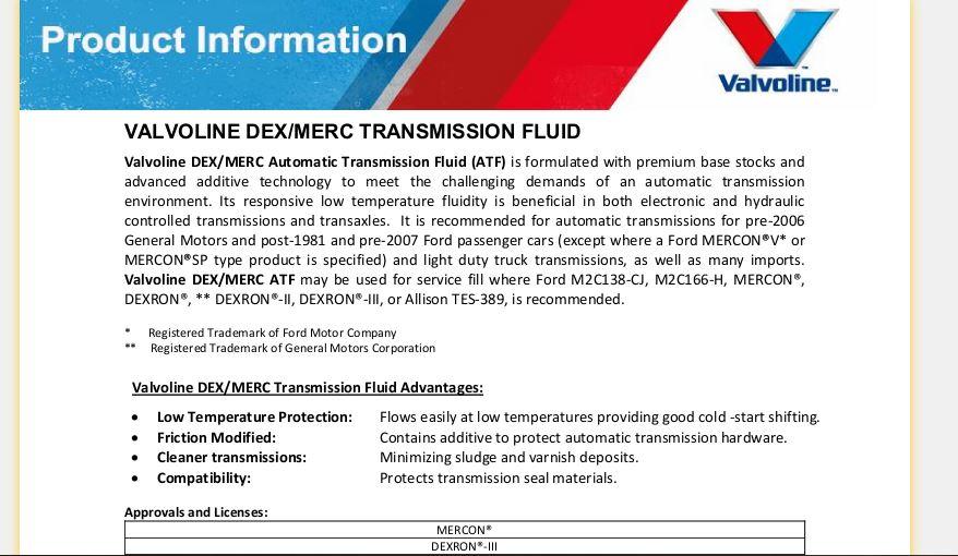

pfrederi 21,274 #7 Posted February 15, 2019 Valvoline does know how to spell it I did learn that the newer Dexrons are backward compatible with 2 and 3....of course it is probably pricier than DexMerc 1 1 Share this post Link to post Share on other sites
