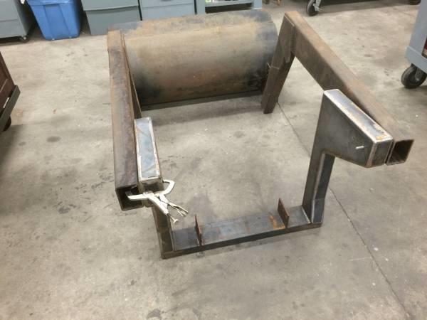

FatJackDurham 318 #1 Posted February 13, 2019 Of course I dream of adding a loader to one of my horses, but its a big project that few actually complete, isn't it? Well I found a great kickstart for myself on CL, and bought it! $600 for the bucket and frame and forks. The guy is a pro fabricator who was building it for his own Deere, but then make a permanent cab for snowblowing instead. With this much done, I think I actually could make the rest! 7 1 1 Share this post Link to post Share on other sites
cschannuth 3,821 #2 Posted February 13, 2019 That looks really nice. It will take some time and patience depending on your skill but it will be well worth it when it’s done. I would definitely say go for it. Share this post Link to post Share on other sites
The Tuul Crib 7,354 #3 Posted February 13, 2019 Looks great but don't thro sparks on that beautiful four wheeled machine behind it ! Share this post Link to post Share on other sites
wallfish 20,689 #4 Posted February 13, 2019 That's worth $600 all day long!!!! The guy did a nice job as the arms appear to be tapered instead of just straight box steel. Not that it makes a difference but it does make it seem like a manufactured unit instead of just a backyard build. Share this post Link to post Share on other sites
AMC RULES 37,260 #5 Posted February 13, 2019 Dig the reinforced cutting edge. Share this post Link to post Share on other sites

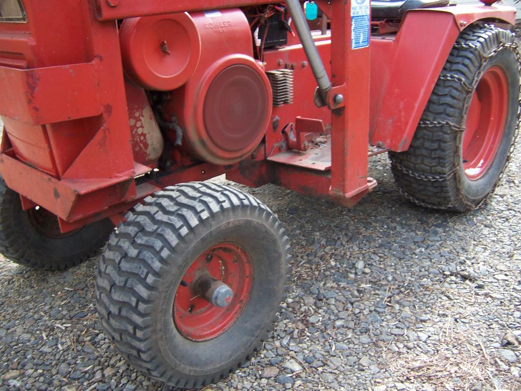

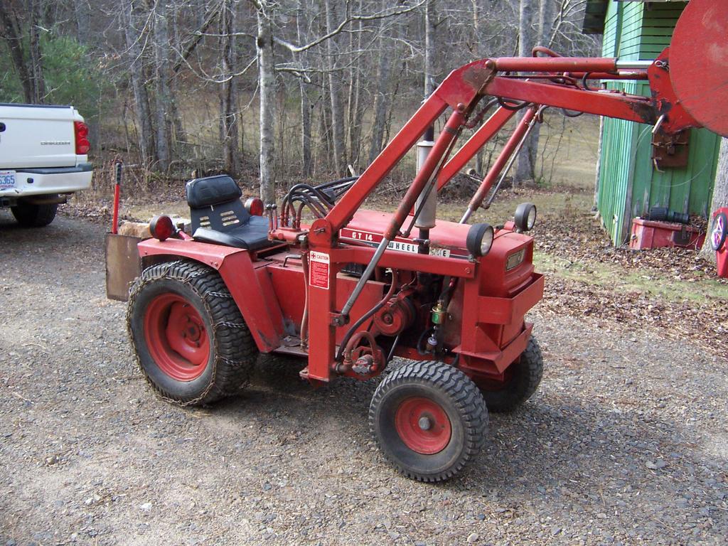

953 nut 69,839 #11 Posted February 13, 2019 I have a loader on my GT-14 and have been very pleased with it. No matter what you mount it on you will need a good sub-frame to distribute the forces to the axles. 2 2 1 Share this post Link to post Share on other sites
FatJackDurham 318 #12 Posted February 14, 2019 On 2/13/2019 at 3:03 PM, 953 nut said: I have a loader on my GT-14 and have been very pleased with it. No matter what you mount it on you will need a good sub-frame to distribute the forces to the axles. I wanted to copy your GT-14 setup, but I already had a misshap with it where It went charging off and slammed my car, because there isnt a break, and without the hydraulic activated, the lift doesn't work. I agree about the manual. I am tempted to put in on my 416 for that reason, so that I have speed control and torque control with the low gears. But, the 520 with the foot pedal will probably be the choice. 1 Share this post Link to post Share on other sites
