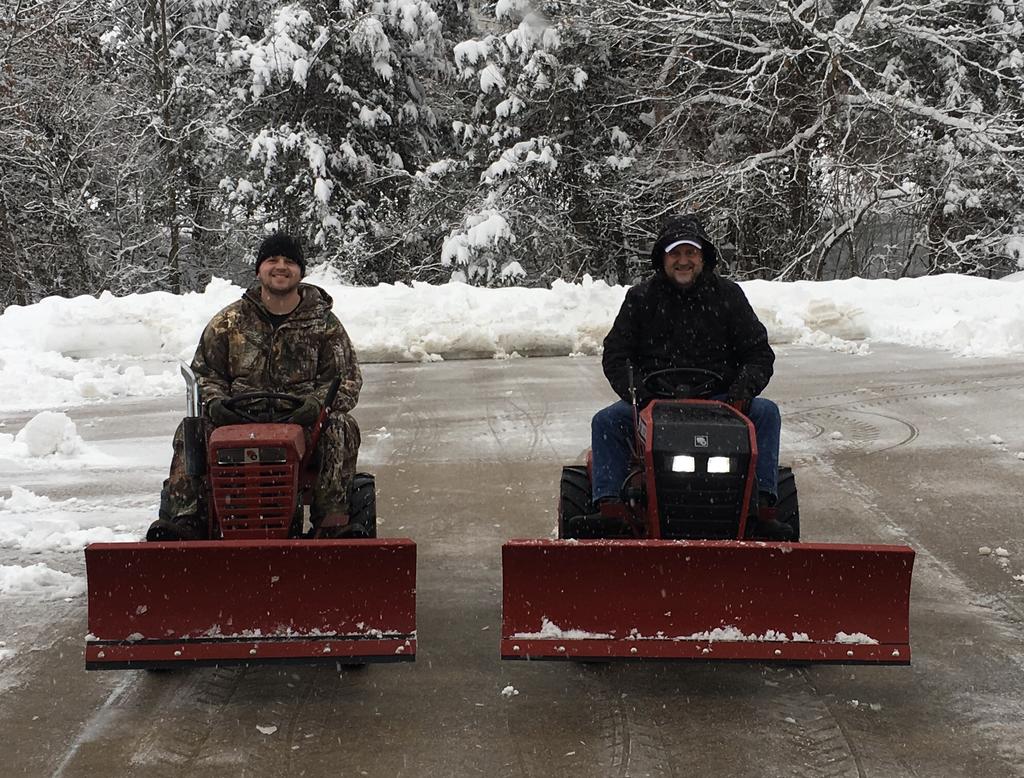

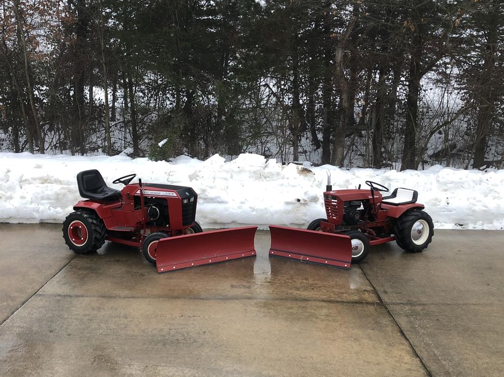

cschannuth 3,821 #12 Posted February 13, 2019 Welcome! I push with a 6HP and a 16HP. Both will push as much snow as fast as I want to go in any gear. Both have loaded tires and wheels weights and are a blast to run. 3 Share this post Link to post Share on other sites

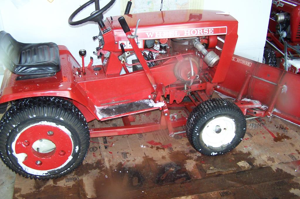

cschannuth 3,821 #17 Posted February 13, 2019 (edited) 2 hours ago, pfrederi said: But if you want to push snow fast get a hydro...faster forward faster changing direction and much faster backwards... I solved that on my 606 predator rat rod by upsizing the engine pulley. It does 9 miles an hour in third gear in 5 mph in reverse. None of my hydros can touch it. Plus that little 42 inch long frame blade on that short frame tractor is light as a feather. Edited February 13, 2019 by cschannuth 3 Share this post Link to post Share on other sites
