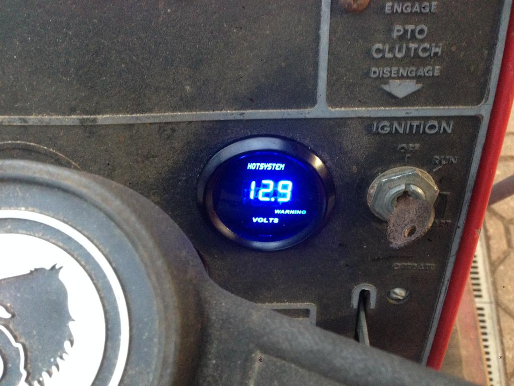

formariz 12,352 #1 Posted February 11, 2019 Started to replace all of the useless ammeters in all the horses that use them.Found this cool relatively inexpensive voltmeter. Its really precise and sensitive. Easy to read since its also lit during day . 1 Share this post Link to post Share on other sites
