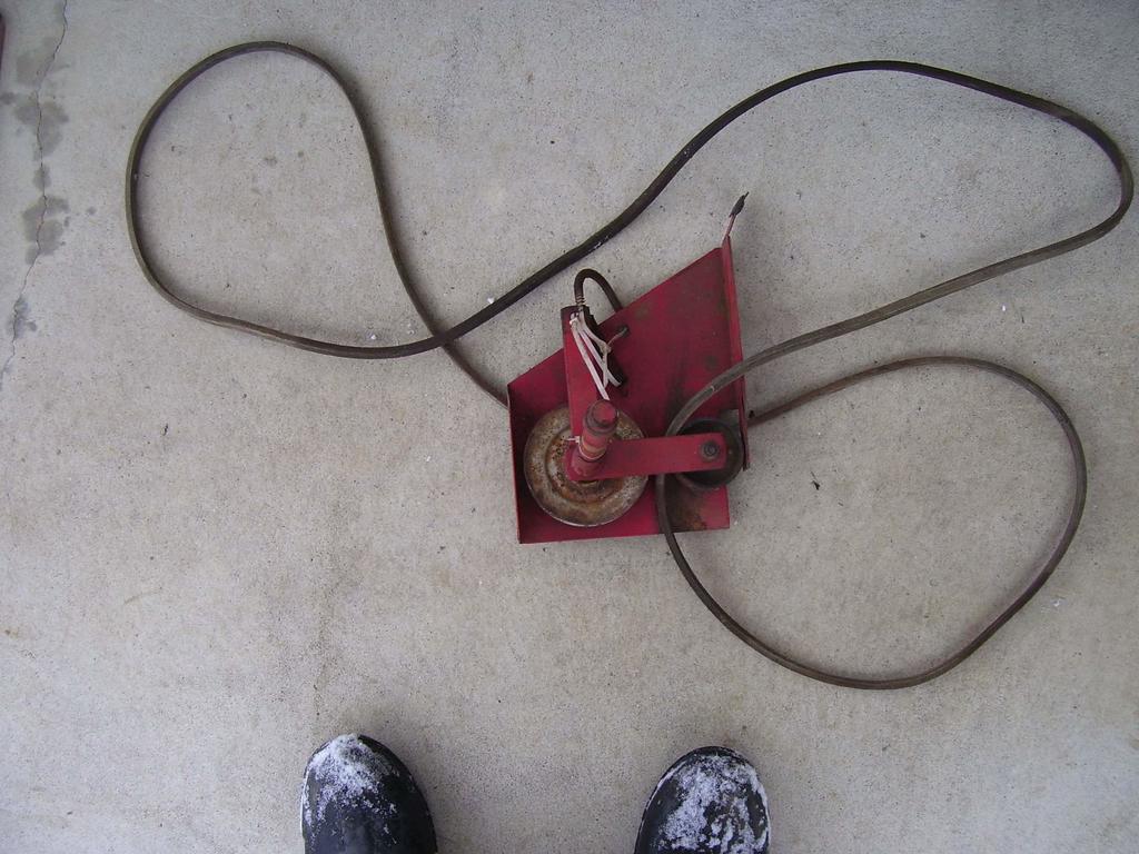

BrianChrencik 1 #1 Posted February 10, 2019 I have a 1970 raider 10 thats been repowered with a k321. I am about to purchase this tiller and want to make sure it will work on my tractor. I do have the snow plow brackets on my rear axle. And is 275$ a fair price? Share this post Link to post Share on other sites
JoeM 10,098 #2 Posted February 10, 2019 Sure looks like there is a lot of life left in it. The tines are worn some but usable. A slight leak on the output shaft seal, but mine will leak some when stored with the gear case in a vertical position. I always check the oil before I use it each time. As far as price, around here that would be okay, availability makes those numbers, they don't seem to be in good supply. I did get one for my friend two years ago at the show for $250. It was in great shape, just lucky. The earliest machine I mounted a tiller on was 1974, I am not positive about the Raider, I am sure there are some Raider guys that can answer. Share this post Link to post Share on other sites
gwest_ca-(File Mod) 12,358 #3 Posted February 10, 2019 Welcome to the forum. Any model and serial number on the tiller? This is the one sold in 1970. Click on the picture. I don't think the actual tiller changed but the belt drive/idler and lift hardware may have changed over the years. It should be adaptable. Garry Share this post Link to post Share on other sites
pfrederi 20,870 #4 Posted February 10, 2019 The belt looks to be in good shape...that is important I think Toro wants $65 for a replacement. The 275 price is not unreasonable. Share this post Link to post Share on other sites
BrianChrencik 1 #5 Posted February 10, 2019 The tag has it as a 07-36 tl01 Share this post Link to post Share on other sites
gwest_ca-(File Mod) 12,358 #7 Posted February 10, 2019 1 hour ago, BrianChrencik said: The tag has it as a 07-36 tl01 Here you go so you can compare. Click on the picture Garry 1 Share this post Link to post Share on other sites
jeremi3210 747 #8 Posted February 10, 2019 I had the same tiller on a 1257 for awhile, the mule drive worked with the old style mid attach. Right now I have it on my 953. I had to fabricate a bracket for the mile drive but everything else was bolt on. My 953 has been upgraded to a 8 pinion hi low rear end. Best of both worlds! Hydraulic lift and a very low gear!!! Share this post Link to post Share on other sites
The Tuul Crib 7,354 #9 Posted February 10, 2019 to as far as condition that is not a bad price ! In my area that is a great price because they don't come up that often! Share this post Link to post Share on other sites
