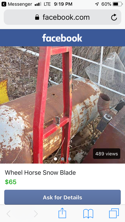

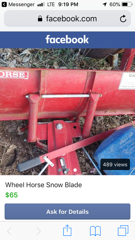

Jojoca 49 #1 Posted February 7, 2019 Is this plow for a long frame tractor? Need another one for my c105. Thank you. Share this post Link to post Share on other sites
stevasaurus 23,805 #2 Posted February 7, 2019 I can tell you that if you gave a picture of the frame we could tell you right now. I will say this...if the "A" frame that comes back from the blade, bends and becomes parallel at the end that will fit a "C" series. This frame fits a "C" series. 2 Share this post Link to post Share on other sites

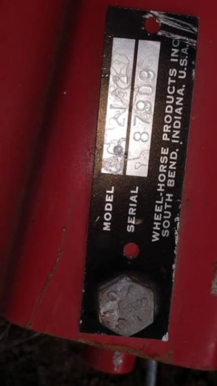

gwest_ca-(File Mod) 12,456 #3 Posted February 8, 2019 Click on the pictures. First one shows all the model numbers Garry 2 Share this post Link to post Share on other sites
Jojoca 49 #5 Posted February 8, 2019 I think I could get it for less then 50 about 30 miles from me. If I’m reading the model number right, I think it is for a short frame. Maybe I could lengthen it pretty easy hopefully. Share this post Link to post Share on other sites
rjg854 13,311 #6 Posted February 8, 2019 I don't think that its for a short frame, if it was, it would be more a triangular shape. 3 Share this post Link to post Share on other sites
ebinmaine 80,319 #7 Posted February 8, 2019 56 minutes ago, rjg854 said: I don't think that its for a short frame, if it was, it would be more a triangular shape. That's a long frame plow. Short frame plows are all triangle shaped from front to rear. Long frame plows have a section at the rear that's parallel. For that price I'd have already left AND see what else they had you could steeeeeaaal. 1 2 Share this post Link to post Share on other sites
gwest_ca-(File Mod) 12,456 #8 Posted February 8, 2019 The long frame blades starting in 1968 would also fit the short frame tractors because they added a second pair of holes at the rear of the A-frame for the 3/4" crossbar. See if you can also get the rear axle brackets to mount it. Blade model 6-2132 is a 1975 blade so fits both long and short frame tractors. Garry 4 Share this post Link to post Share on other sites

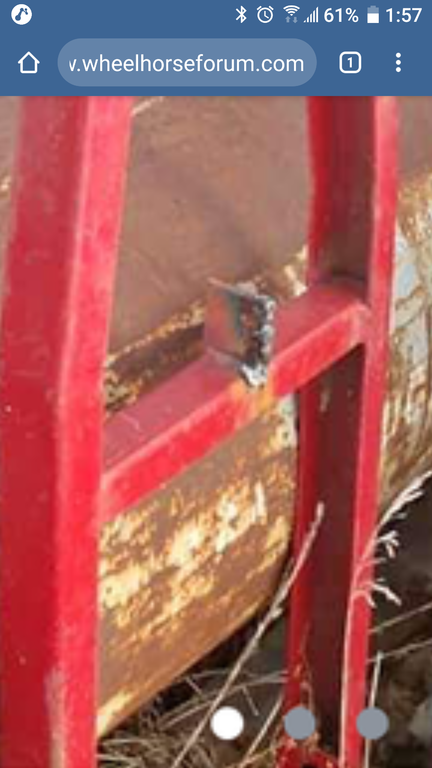

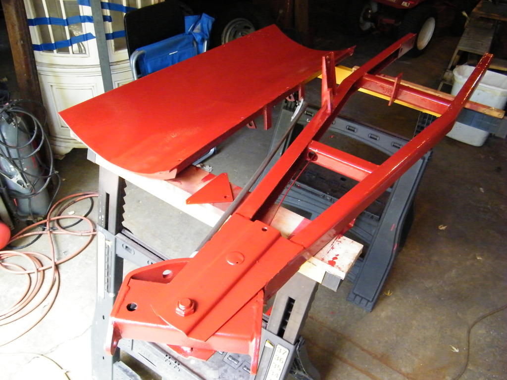

WVHillbilly520H 10,379 #12 Posted February 8, 2019 Notice that the lift point has been "burned" off with a "blue wrench"... should look like the second pic... Share this post Link to post Share on other sites
