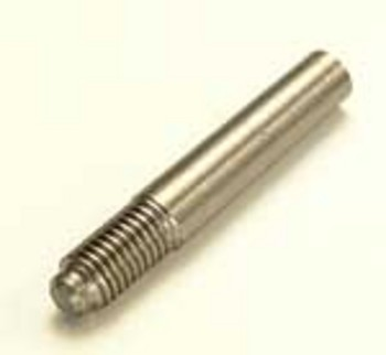

bc.gold 3,406 #7 Posted February 3, 2019 (edited) Using the threaded stud cut the head off then tapered the head to use as a locating stud, not my idea many of the older vehicles like Hudson, Studebaker and most early Chrysler products used this stud. Place the locator at the 12:00 o'clock position the wheel finds its own centre of gravity, then after installing a few wheel studs to hold the rim and tire in place you can remove the locating pin and keep that stock look. Edited February 3, 2019 by bcgold Share this post Link to post Share on other sites
cleat 8,733 #8 Posted February 3, 2019 You can make a locating pin or two from a couple of 7/16" fine thread bolts. Kind of like this. Just cut the head off then cut in a little slot for a screwdriver if it gets stuck in. I just did this when putting the wheels back on my Work Horse and it worked great. I used 2 pins then the 3 wheel bolts just easily threaded in, then remove the two pins and install the last 2 bolts. All of my 520's have studs and nuts and they also work great. Cleat 2 Share this post Link to post Share on other sites
