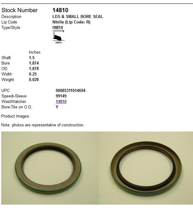

pfrederi 21,145 #3 Posted February 2, 2019 WH6663 is CR 14810 Share this post Link to post Share on other sites
