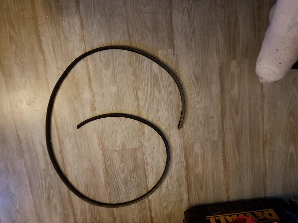

CrazyDetroit 7 #1 Posted February 1, 2019 You all been great helping me with my endless problems over last 2 weeks. All my local mom and shops around my area have gone out of business . 1 more small problem need a new drive belt . Here the issue i have a b-80 chasis and rear end. The engine with the pulley came off a c160 16hp Kohler. I believe the belts are the same. From b80 to c160. Because i have to mail order everything it needs to be correct . No numbers left on belt. Belt measured 85" long 5/8 thick. Or dose anyone have the part number Share this post Link to post Share on other sites

squonk 46,853 #3 Posted February 1, 2019 Or any Napa's close by? 5L850W is the number. 2 Share this post Link to post Share on other sites
