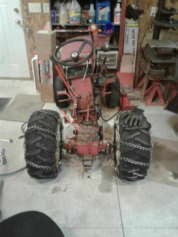

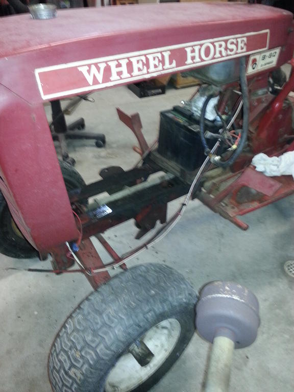

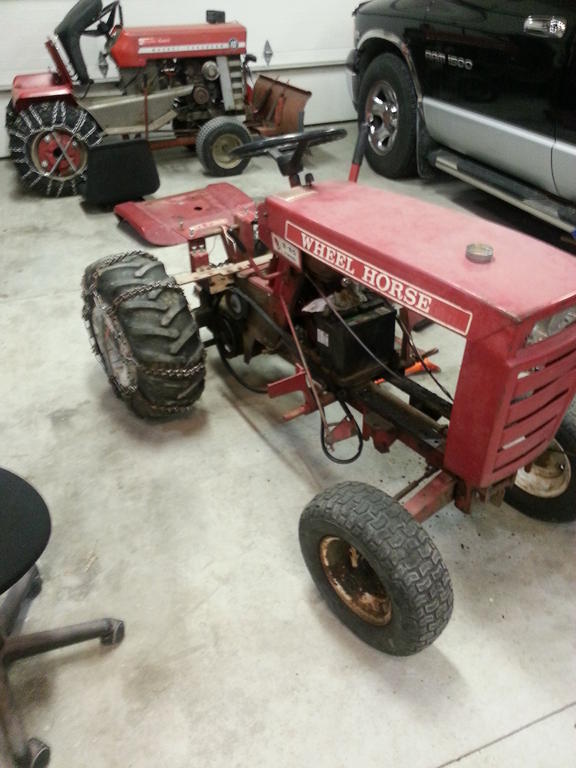

lae51967 18 #9 Posted January 29, 2019 (edited) Thanks for the input guys, I'll crack it open this weekend too see what I've got and go from there. It was out of the weather most of it's life but I know a few years it sat outside intermittently at dad's before I inherited it. Hasn't spent a night outside since 2003 and since 2014 been in a heated garage. Apparently I don't have many photos of it, Two from 2017 when I had the engine out for a re-build and then two weeks ago when I broke the frame and started down this road. It's in pieces at the moment. Edited January 29, 2019 by lae51967 Photos 1 2 Share this post Link to post Share on other sites
Sarge 3,473 #10 Posted January 29, 2019 Just a note - those chains may have been part of the cause of the rear frame breaking. With that spacing between the cross-links, the wheels can slip pretty hard, then shock loads the gears and frame when one of those cross-links grabs the ground. 4-link style and whatever the spacing on your current setup can really abuse the driveline parts - I'd recommend switching it to a 2-link style or the H-pattern style chains. Those keep the traction more consistent and help prevent shock loading the tractor. I'm sure you also know - ramming into snow piles is also a no-no and should be avoided. Just an fyi - not a lecture. Sarge 2 Share this post Link to post Share on other sites
