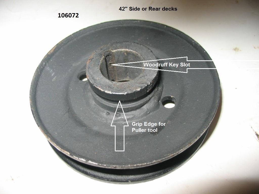

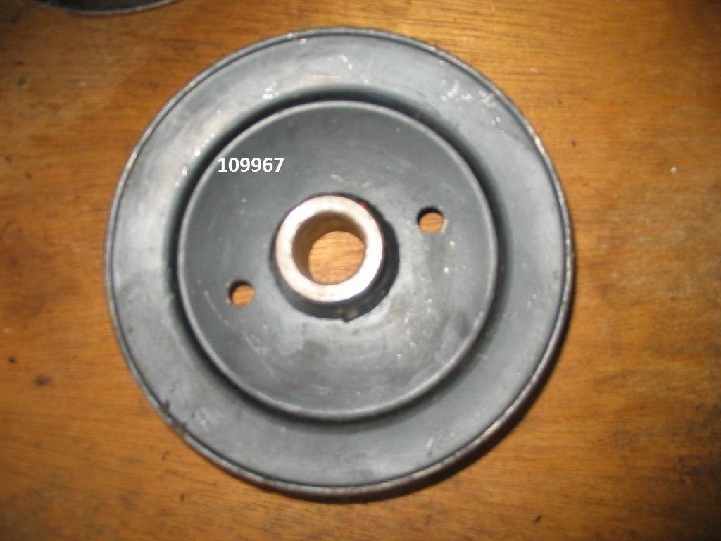

daveoman1966 3,884 #5 Posted January 28, 2019 Lt or Rt side pulley for a 42" deck WITH woodruff key is # 106072. It has a 3/4" bore. The other pulley WITHOUT a woodruff key is # 109967 and it has a 5/8" bore. 2 2 Share this post Link to post Share on other sites

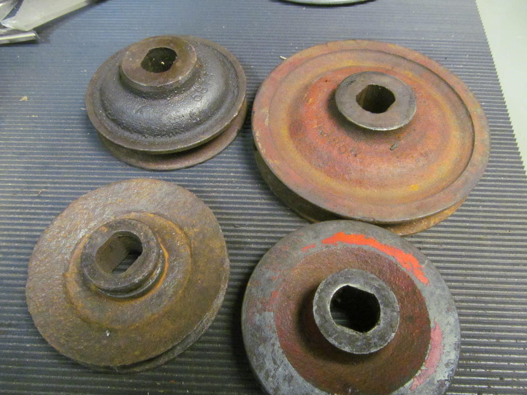

Ed Kennell 46,519 #6 Posted January 28, 2019 Some additional info on the deck pulleys. The older decks had the cast iron double D holes for locking to the spindles. Then Wheel Horse changed to the keyed pulleys. And then changed to the present keyless design that uses only the lock washer and nut to attach the pulleys as shown in Dave's above post. This is why it is necessary to use your correct deck model number when searching for parts. The Double D pulleys. 2 1 Share this post Link to post Share on other sites
TC10284 114 #7 Posted January 28, 2019 8 hours ago, daveoman1966 said: Lt or Rt side pulley for a 42" deck WITH woodruff key is # 106072. It has a 3/4" bore. The other pulley WITHOUT a woodruff key is # 109967 and it has a 5/8" bore. Thanks! I was able to find what I needed with the top pic part number! 1 Share this post Link to post Share on other sites
