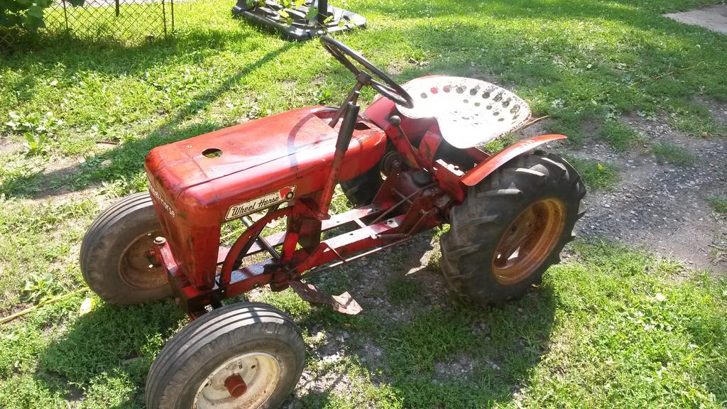

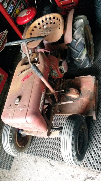

WHGuy413 2,859 #1 Posted January 27, 2019 Hey everyone. I have a all original rj58 and what I believe to be a original 701. I would love to protect the patina on them. I see some guys use oil. Some use clear coat. Ive never done either and am curious to learn about the different ways there are to preserve these tractors and how to do them successfully before I make any decisions. 4 7 Share this post Link to post Share on other sites

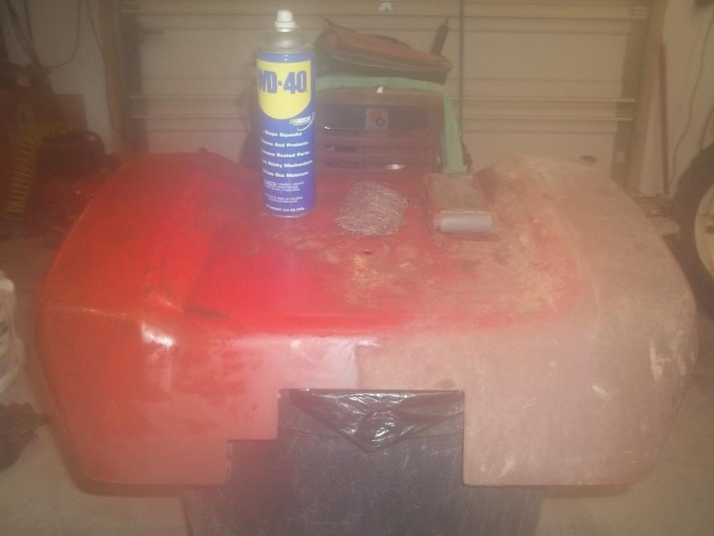

953 nut 67,517 #5 Posted January 28, 2019 Personal preference, I do not like the shin that a clear coat will produce on patina. I have used WD-40, steel wool and some 400 Wet/Dry paper to restore some of the color without making it shiny. 6 Share this post Link to post Share on other sites

oliver2-44 11,635 #9 Posted January 28, 2019 By the way, your front rims and tires look original. If they are filled with calcium chloride (original factory weight) you way want to get it out of there before it eats holes in the rims. 1 Share this post Link to post Share on other sites

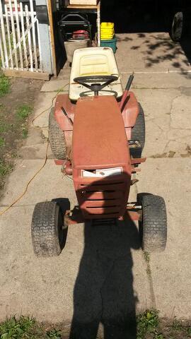

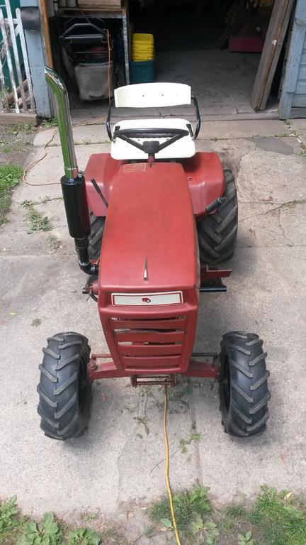

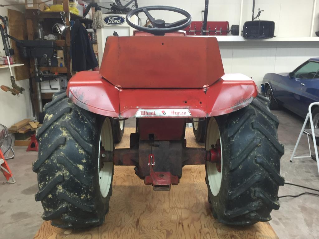

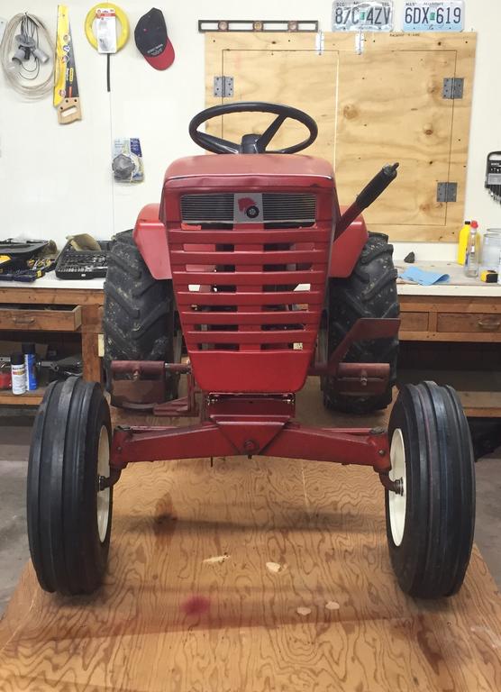

cschannuth 3,821 #12 Posted January 29, 2019 (edited) 1 hour ago, WHGuy413 said: I've always been nervous to use something like steel wool or fine grit sand paper. I'd be so mad at myself if it scratched them bad. It's so fine that all it really does is deep clean. My sheet metal was in great shape but the paint was dull. This brightened it up a bit without making it too shiny and preserving the patina. I would never do this on a nice, shiny paint job. Here are some pics right after I used the steel wool and applied the matte clear and some new decals. Edited January 29, 2019 by cschannuth Add pics 1 Share this post Link to post Share on other sites

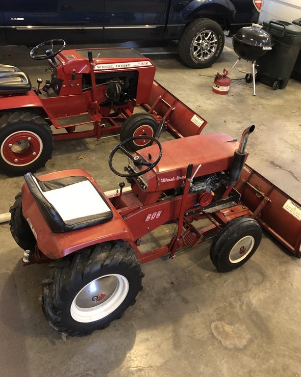

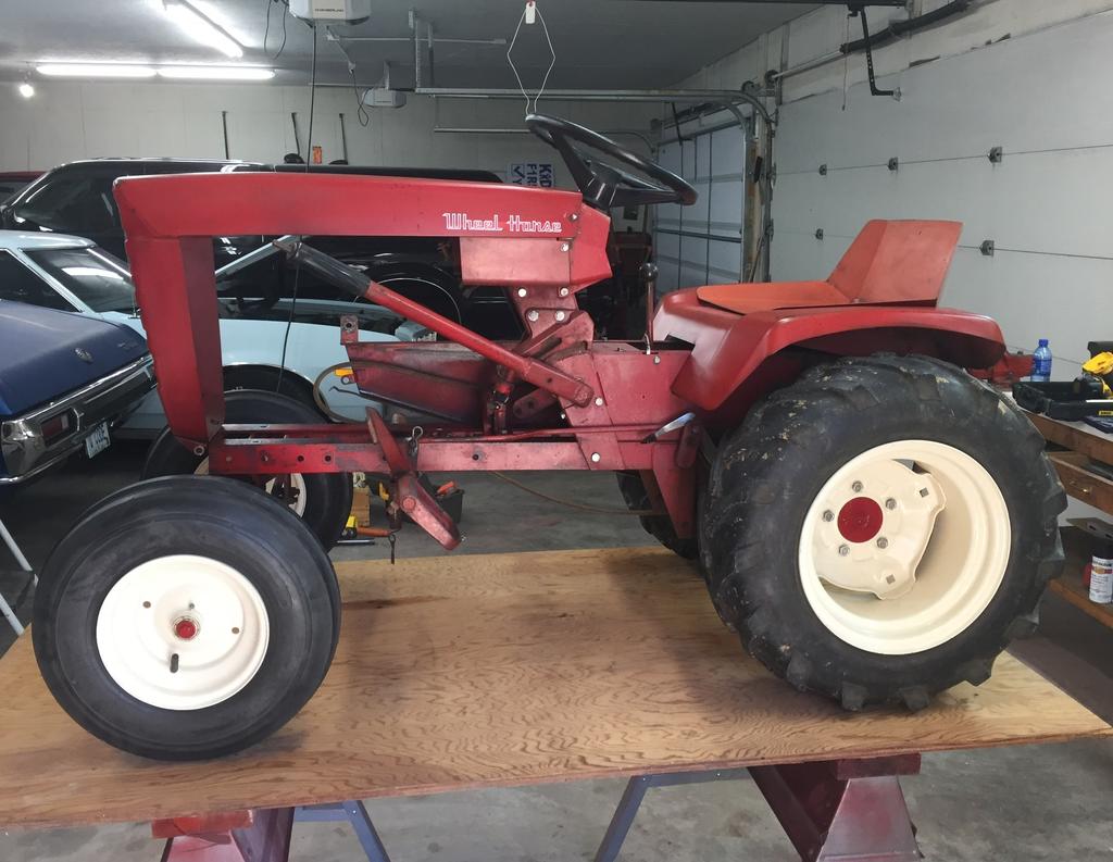

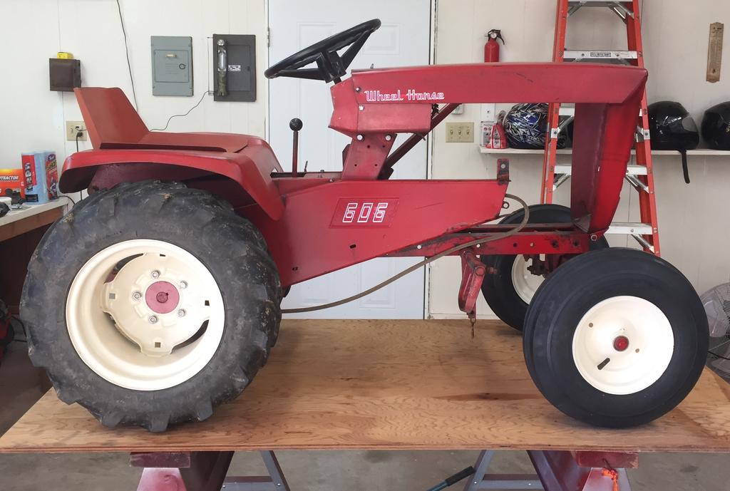

Chris G 3,382 #14 Posted January 29, 2019 It really is gonna depend a lot on condition of paint at the start. I use the wetsand method if there is surface rust present and the paint is very faded. But If the paint is predominantly there and just faded, I would use the 3m scotch pads and then apply my clear. The first two pics are a before and after, using a wet sand and a gloss clear coat. The last two pics I used 3m scotch pads and then a semi gloss clear coat. Hope this helps. 1 Share this post Link to post Share on other sites
