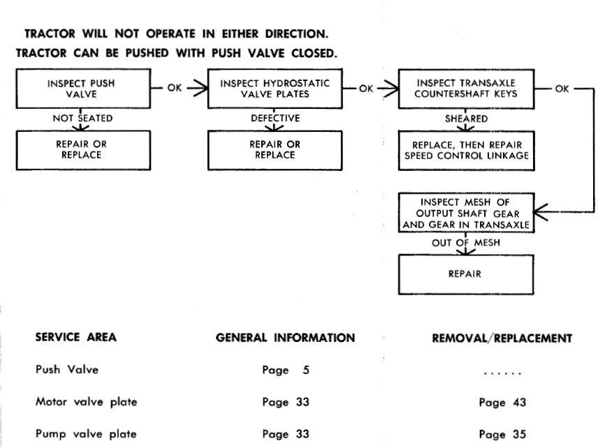

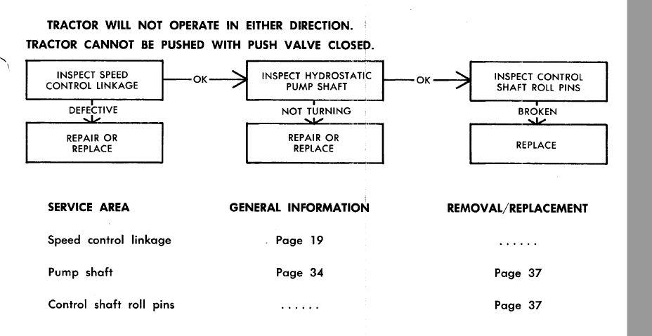

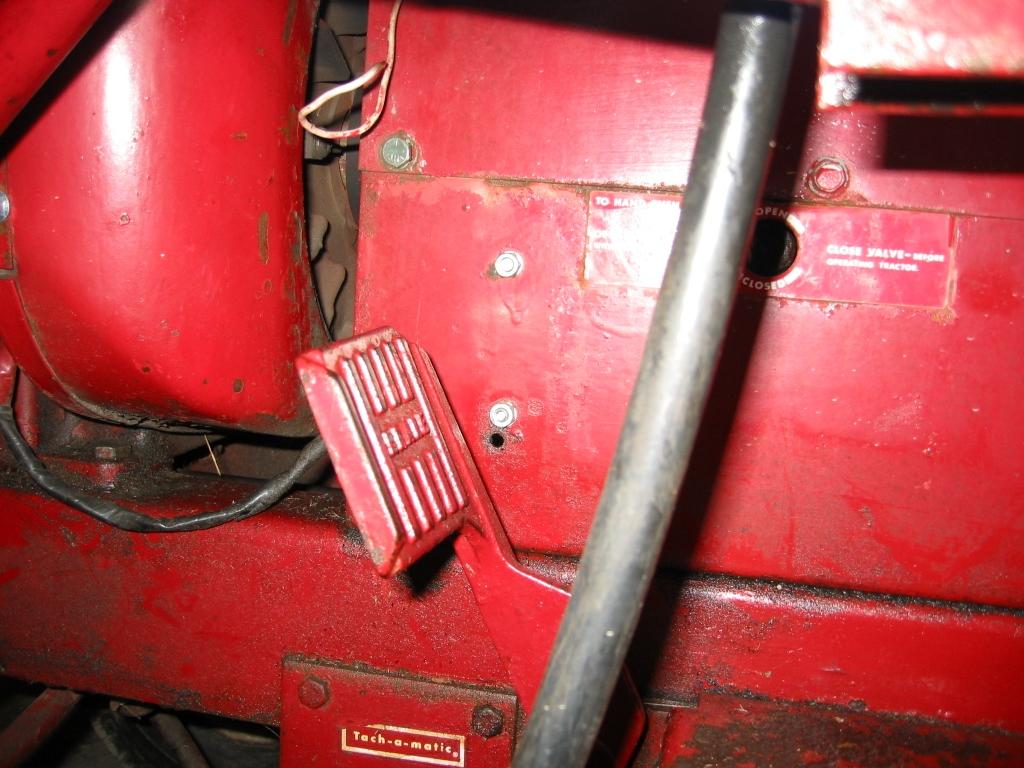

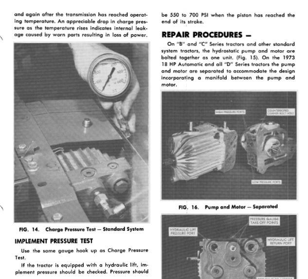

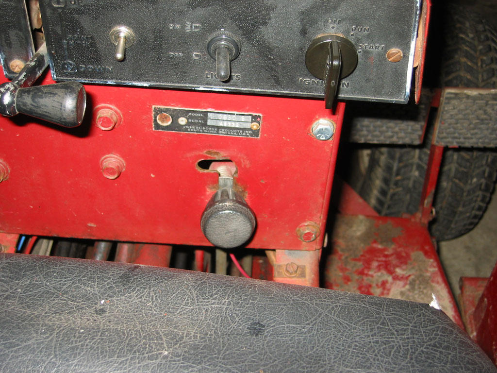

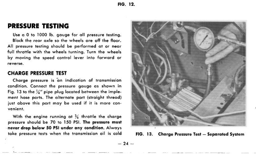

pfrederi 17,147 #10 Posted January 27, 2019 Do you have the parking brake lever like first picture?? Did yo check the tow valve? second picture? You can download the service manual here It has diagnostic charts like these 1 Share this post Link to post Share on other sites
hucksterfool 5 #11 Posted January 27, 2019 No I don’t have that brake. Mine is on floor with engage and disengage. I do have tow valve and it is closed. Tractor was working fine and started acting up. I assume the fluid fill is the one in rear diff Share this post Link to post Share on other sites

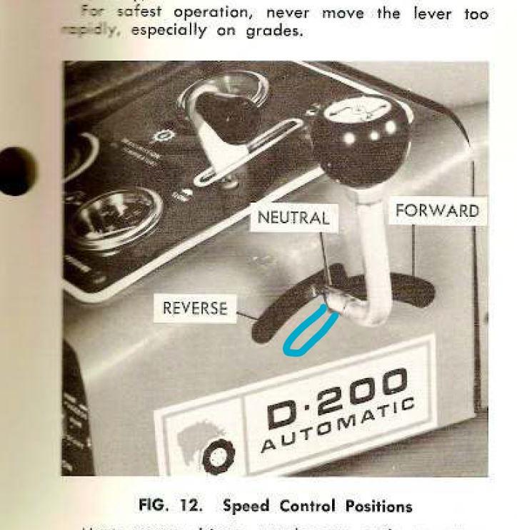

pfrederi 17,147 #12 Posted January 27, 2019 (edited) If you are talking about the pedal on the left side (see pic 2) all that does is force the motion control lever to the neutral position. If you do not have the knob under the instrument panel then your parking brakes is engaged when you pull the motion control lever in into the lower of the two slots. The linkage may have slipped and things are not engaging properly. Linkages on a D can be real fun to adjust. The only fluid fill is the dipstick Edited January 27, 2019 by pfrederi Share this post Link to post Share on other sites

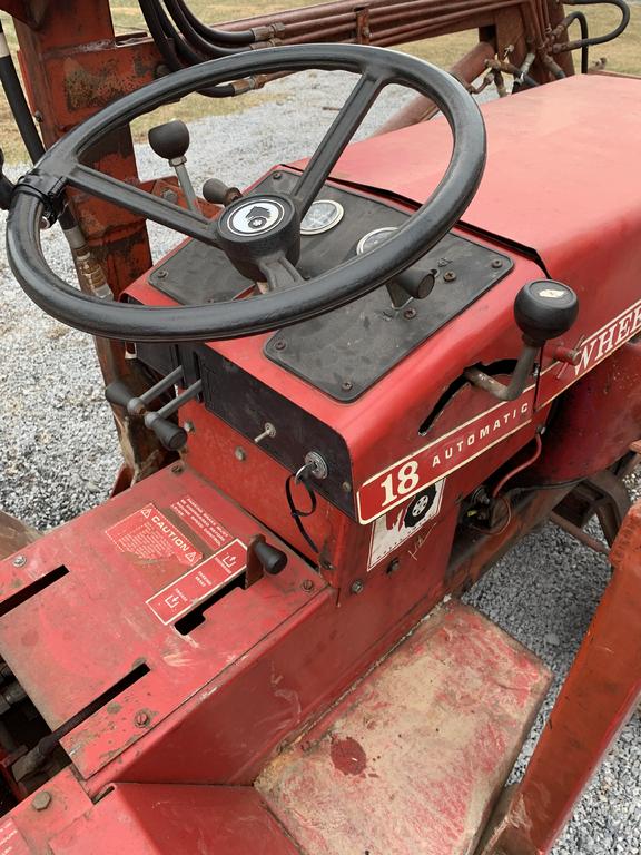

hucksterfool 5 #13 Posted January 27, 2019 I’ll upload some photos. I have pto level on left. Forward /reverse on right. Emergency brake on floor. The controls for movement are good. Moves full forward and full backwards. Share this post Link to post Share on other sites
pfrederi 17,147 #14 Posted January 27, 2019 I will get some later also. Does you motion control have slot where the blue ink is??? 1 Share this post Link to post Share on other sites
hucksterfool 5 #15 Posted January 27, 2019 Yes that is the lever I have. It controls the pump forward reverse which I can see full movement on. Share this post Link to post Share on other sites

pfrederi 17,147 #20 Posted January 27, 2019 The two levers on the left of the instrument panel one does the midmount lift the other the 3 point lift. They are powered by the charge pump which is part of the hydro pump at the rear of the engine. If they are working slowly/weakly there very probably is an issue with that charge pump. There is a pressure test in the manual I put the link in Post #10 above. Hope you have a warm place to work. You have to pull the battery out to get to the port you need for the test.. Share this post Link to post Share on other sites

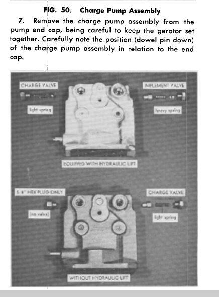

pfrederi 17,147 #21 Posted January 27, 2019 If this problem was of sudden onset I am thinking the charge pump relief valve spring may have broken (or possibly the implement relief valve spring). 1 Share this post Link to post Share on other sites

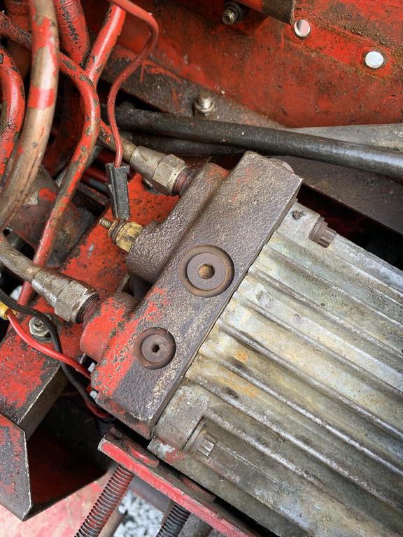

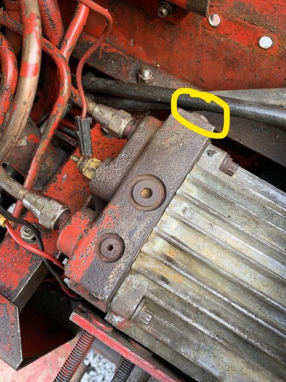

pfrederi 17,147 #24 Posted January 27, 2019 The charge pump relief is located on the pump body above the tow valve. It may be possible to get it out with out pulling the whole hydro pump. i have been told that but i have never done it I have always had to pull the pump. I am pretty sure the implement one cannot be done that way. Sarge pointed out the D is not the easiest to work on. I am convinced when they were built they started with a guy holding the pump the built the tractor around it. Share this post Link to post Share on other sites
pfrederi 17,147 #25 Posted January 27, 2019 Charge valve is circled on your picture Implement is opposite Share this post Link to post Share on other sites
