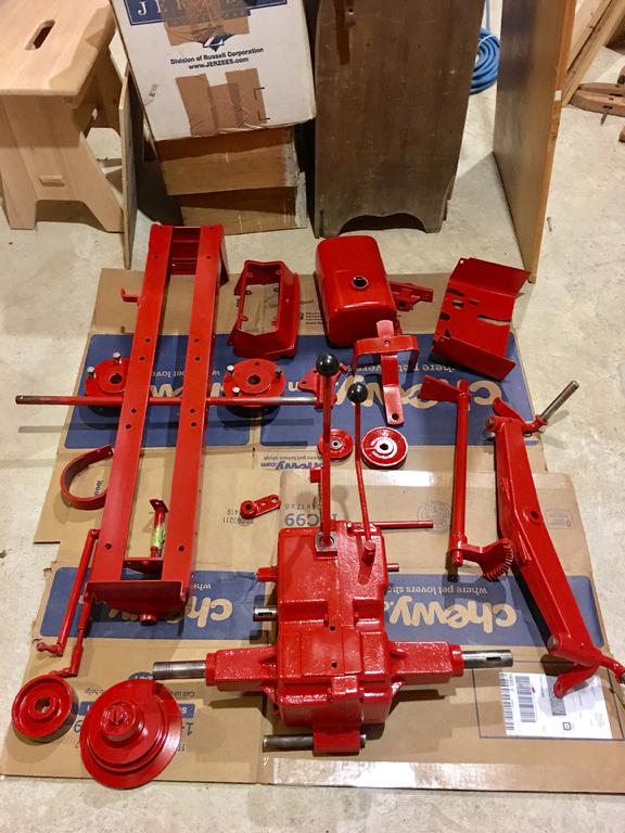

JoeM 10,317 #1 Posted January 26, 2019 Resurrected a refresh job, removed body panels hood etc. and started prep work. Part of the job I love so much! The seat pan was in pretty bad shape and used a Harboo Freight paint removal wheel on the 4 1/2. Took most of it to bare metal pretty quick but messy. Started working on the hood, it is in decent shape using a palm sander with 120 grit. The outside was easy but the inside has more nooks and crannies than a English muffin! I noticed when sanding the hood (powder coat) when I would find a pin sized chip I would have to sand it out to the size of a dime or so to find good metal free of rust. I then go over the hood with 220 some times wet sometime dry. Primed with automotive sand able primer then sanded with 320. I did experience some "lifting" between primer coats. I found I needed to leave the primer dry longer and just put on a dusting on the first coat. (tac coat) I think the latter was solved most of the problem with the lifting. As far as the sand paper, I noticed the 3M stuff is far better and lasts longer then the generic stuff. Although, the generic stuff is half the price, maybe a push. Questions, grit size on what? Wet or dry? Techniques? Any secrets are welcome! Share this post Link to post Share on other sites
BHunter 1,702 #2 Posted January 26, 2019 48 minutes ago, OILUJ52 said: Resurrected a refresh job, removed body panels hood etc. and started prep work. Part of the job I love so much! The seat pan was in pretty bad shape and used a Harboo Freight paint removal wheel on the 4 1/2. Took most of it to bare metal pretty quick but messy. Started working on the hood, it is in decent shape using a palm sander with 120 grit. The outside was easy but the inside has more nooks and crannies than a English muffin! I noticed when sanding the hood (powder coat) when I would find a pin sized chip I would have to sand it out to the size of a dime or so to find good metal free of rust. I then go over the hood with 220 some times wet sometime dry. Primed with automotive sand able primer then sanded with 320. I did experience some "lifting" between primer coats. I found I needed to leave the primer dry longer and just put on a dusting on the first coat. (tac coat) I think the latter was solved most of the problem with the lifting. As far as the sand paper, I noticed the 3M stuff is far better and lasts longer then the generic stuff. Although, the generic stuff is half the price, maybe a push. Questions, grit size on what? Wet or dry? Techniques? Any secrets are welcome! Hi. Are you using a spray can primer? I never experience lifting with a 2 part primer using a paint gun. Before primer, I use a pre cleaner or wash well with dawn dish soap . Rinse and dry. I sand with 180 grit or 220 grit if you have it. I sandblast the rust spots or you can treat them with a rust converter spray. Follow all directions on can. Then sand dry rust converter with 220 and clean well with a wax and grease remover. Apply primer. Allow coats to dry per instructions. Temperature is a big factor for drying times. Then I wet sand with 400 grit. Then clean again with the remover. I use a tac cloth to remove lint that the towels might leave on the panel. then apply paint per instructions. 1 1 Share this post Link to post Share on other sites

The Tuul Crib 7,354 #4 Posted January 26, 2019 I've been taking my parts down to bare metal and using an etching primer first then putting regular primer then sending smooth before paint. Then using a rattle can and have had great results so far. 4 Share this post Link to post Share on other sites
JoeM 10,317 #5 Posted January 26, 2019 Just rattle cans for now. I just picked up a gun and I am probably going to venture in that direction. I'm pretty close to your (bhunter) process with the exception of rust converter and spray can primer. I use 320 to sand the primer. I do know trying different can primers, Krylon Auto seemed to be the best and sanded up nicely. I do wait a day after wet sanding. Share this post Link to post Share on other sites

BHunter 1,702 #8 Posted January 27, 2019 2 hours ago, The Tool Crib said: I've been taking my parts down to bare metal and using an etching primer first then putting regular primer then sending smooth before paint. Then using a rattle can and have had great results so far. I agree. Etch primer is great for bare metal adhesion before filler primer. Share this post Link to post Share on other sites

JoeM 10,317 #17 Posted January 27, 2019 (edited) Back at it again today. I have an old extra seat pan I am using for testing. I ended up re sanding the primer with 500 because I could see lines in the test paint. The two Pics of the sanded seat pan is an area where I welded holes shut. what was nice the underneath where no one sees came out twice as nice and the top. LOL I do have another question what is the best clear coat and process? Test Pan, I didn't get to carried away with fine details cause this side won't show. I want spray a second coat on half of this pan later in the week then try some clear testing maybe next week. Seat pan using 3M Fre-Cut 320 paper wet. Seat pan using Generic 500 paper wet Sanding Technique. Edited January 27, 2019 by OILUJ52 Share this post Link to post Share on other sites
