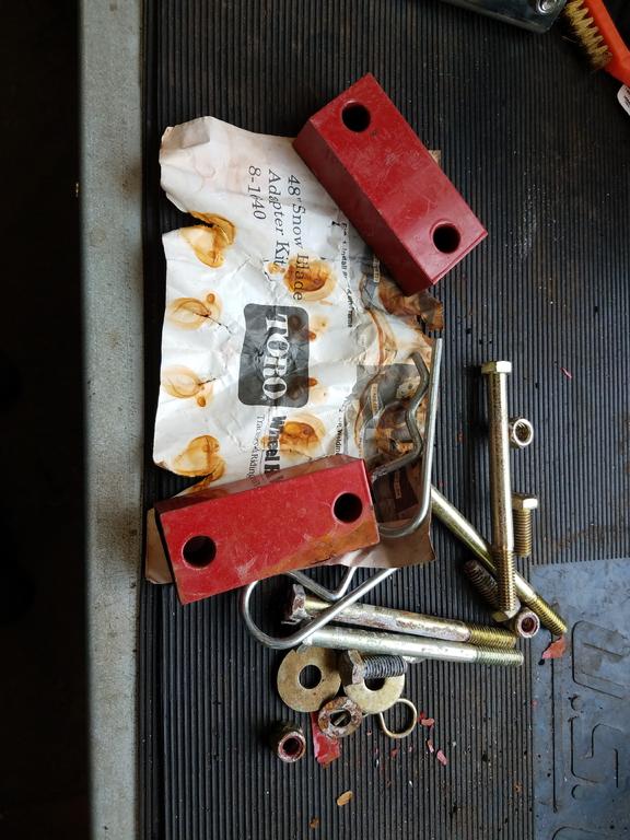

Turftech 82 #7 Posted January 25, 2019 Do you have the 1" spacers mounted between the hitch and the axle? I believe the original extension kits had two lengths of carriage bolts so the spacers would be added on the 520-8 to clear the pulley. The reason I know this is my 1994 520-H came with the extensions installed, upon disassembly the blocks were found to be powder coated red. Researching on Red Square I came across a post showing pictures of a newly opened NOS.extension kit with the blocks. Hope this helps 2 2 Share this post Link to post Share on other sites

ericj 1,579 #9 Posted January 25, 2019 11 hours ago, Turftech said: Do you have the 1" spacers mounted between the hitch and the axle? I believe the original extension kits had two lengths of carriage bolts so the spacers would be added on the 520-8 to clear the pulley. The reason I know this is my 1994 520-H came with the extensions installed, upon disassembly the blocks were found to be powder coated red. Researching on Red Square I came across a post showing pictures of a newly opened NOS.extension kit with the blocks. Hope this helps now that you mention I do remember reading something about that will have to check into that 4 hours ago, Shynon said: I have a couple sets of those, not sure if they are complete though if you have any of the blocks I would be interested in a set if your willing to sell eric j 2 Share this post Link to post Share on other sites

SPINJIM 1,986 #12 Posted January 25, 2019 14 hours ago, Turftech said: Do you have the 1" spacers mounted between the hitch and the axle? I believe the original extension kits had two lengths of carriage bolts so the spacers would be added on the 520-8 to clear the pulley. Any pictures of those spacer blocks ? I'm planning on installing a plow with the extension on my 520H, and wasn't aware of the spacers. If you have a spare set, I'd be in line behind Eric to buy them from you. Thanks, Jim 1 Share this post Link to post Share on other sites
ericj 1,579 #13 Posted January 25, 2019 3 hours ago, SPINJIM said: Any pictures of those spacer blocks ? I'm planning on installing a plow with the extension on my 520H, and wasn't aware of the spacers. If you have a spare set, I'd be in line behind Eric to buy them from you. Thanks, Jim I think the spacers are only needed on 8 speed tractors. I've been using plow extensions on 520-H for years and never had a problem before this 8 speed eric j 1 Share this post Link to post Share on other sites

gwest_ca-(File Mod) 11,512 #17 Posted January 27, 2019 The 119840 spacer blocks are still available from Toro and will likely be for eternity. https://www.partstree.com/parts/toro/parts/119840/ Garry Share this post Link to post Share on other sites
Sarge 3,465 #18 Posted January 27, 2019 Looks like a pretty easy part to duplicate - and price it at a lot lower point than what Toro is asking, lol. Sarge Share this post Link to post Share on other sites
ericj 1,579 #19 Posted January 29, 2019 I had a friend that was my dad's wheel horse dealer, and also a machinist, make me 2 blocks. I installed them today and now the plow works as it should and even lifts a little higher. and the price was right. eric j 1 Share this post Link to post Share on other sites
