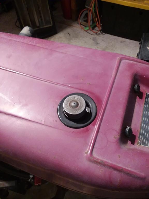

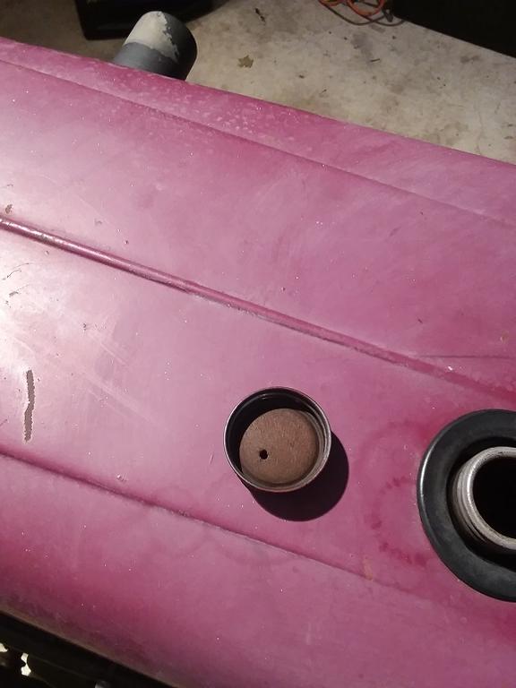

Dan693 510 #1 Posted January 23, 2019 Any ideas about stopping fuel from leaking out of the vent hole on a LR gas cap? It appears to be stock with the cardboard piece in tacked. It spurts gas out when over half full and quite a bit when the tank is full. I looked around for a new cap but couldn't one to fit locally. It's about 1 1/2" ID. Not that big of a deal but a little annoying. Versus the ex that was a very bad deal and very annoying so I can live with a leaky gas cap if need be. 5 Share this post Link to post Share on other sites

WHNJ701 4,172 #3 Posted January 23, 2019 replace the cardboard cutout to fit tighter and punch a smaller hole, or stop driving it upside down 2 6 Share this post Link to post Share on other sites
JoeM 10,035 #4 Posted January 23, 2019 seems like some kind of gauze between the cap and the cardboard would help? Share this post Link to post Share on other sites
peter lena 9,900 #5 Posted January 23, 2019 thought, stop that driving it upside down , was the best advice, pete 1 Share this post Link to post Share on other sites

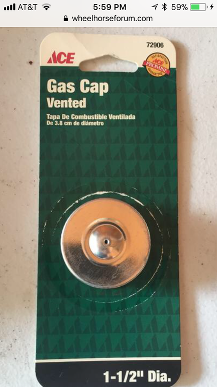

dclarke 4,268 #6 Posted January 24, 2019 I found a new gas cap for my Ranger at Ace Hardware 4 2 Share this post Link to post Share on other sites

dclarke 4,268 #8 Posted January 24, 2019 24 minutes ago, ebinmaine said: Good info there Denny. I could use a new cap on the 1267. Check the size of your cap, Eric. You might need a 1-3/4” cap but I think Ace has it too. 1 Share this post Link to post Share on other sites

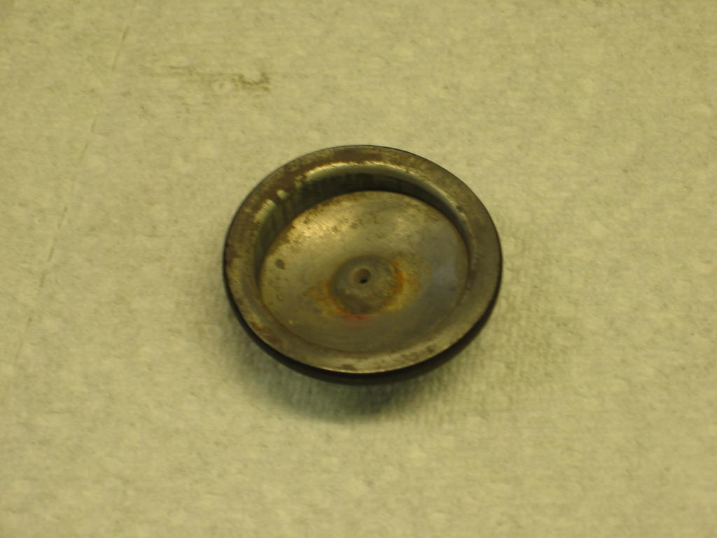

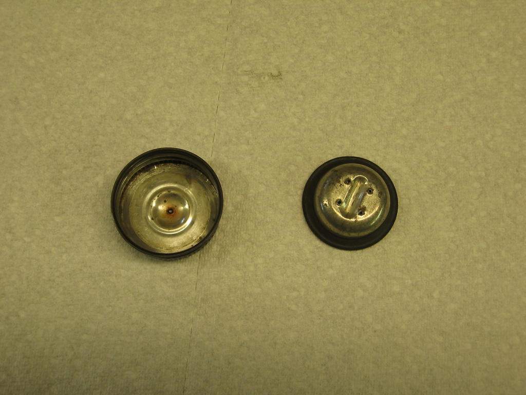

pfrederi 20,668 #18 Posted January 24, 2019 This is what you should have. It is the original cap on my L107. Note in second picture the inner piece sits at a slant. helps it drain back. Share this post Link to post Share on other sites

pfrederi 20,668 #22 Posted January 25, 2019 The original on mine only spits a bit if I fill it really full, like over flowing. Share this post Link to post Share on other sites
