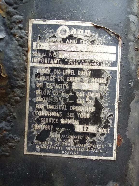

Jdad49 0 #1 Posted January 22, 2019 I need to find a new coil for the motor. I can only make out the numbers shown in the title. Are there more numbers letters to it. I am showing the picture of the plaque on the side of the motor. Its pretty beat up The mower has been sitting in the woods uncovered for years. Share this post Link to post Share on other sites
gwest_ca-(File Mod) 12,532 #2 Posted January 22, 2019 BF-MS-2425A Found this https://www.scribd.com/document/102292277/Onan-Bf-Ms-service The service manual is followed by the illustrated parts list Coil 166-0535 Believe this is the one often replaced with a Harley Davidson coil. Garry Share this post Link to post Share on other sites
