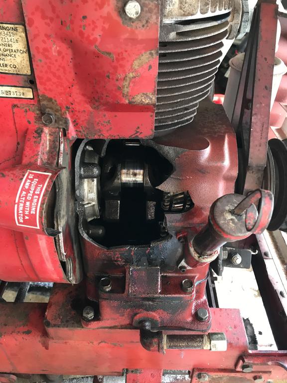

Pollack Pete 2,273 #26 Posted January 24, 2019 On 1/22/2019 at 12:13 PM, Firebug said: I’ll get it, just going to take some trial and error, just didn’t want to have to pay someone to plow my driveways when I have a machine that’s more than capable of doing it. I didn’t have any issues with my d160 last year save for the motor letting go. But I did have the chains on it last year. Thought the gas would dig like the chains. But at least I didn’t scatter my motor this time 👍 Now that's a vented crankcase!!! Share this post Link to post Share on other sites

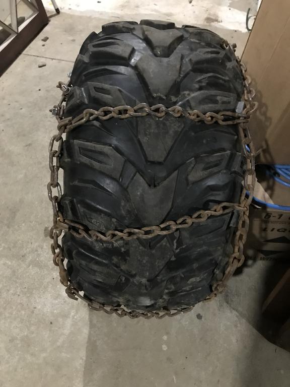

Firebug 267 #34 Posted January 26, 2019 I have a set of 2 link chains, but they don’t for the tires I have on it. I should get my new tires back Monday that will fit the chains. I’ll fill those and get them on and then it should all just be a matter of weight Share this post Link to post Share on other sites
Firebug 267 #35 Posted January 29, 2019 I think my problem is solved. Got a set of Sedona mud rebel atv tires, filled with 5 gallons of washer fluid in each and put my chains on. Still need to get them on the tractor but I have no doubt these will work better than the ag tires. Still working on the weight bar for the 3 point. 2 Share this post Link to post Share on other sites

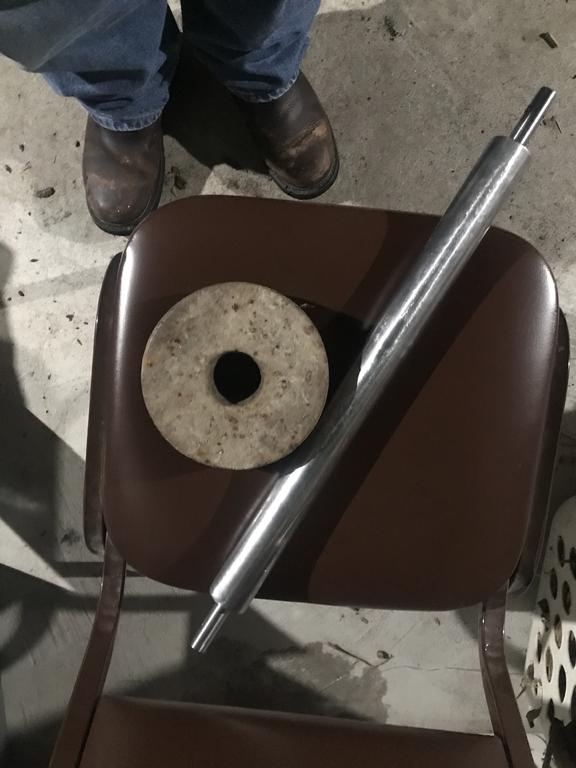

Firebug 267 #38 Posted January 30, 2019 So here is my next attempt at weight for plowing. I picked up 12 of these donut weights from a buddy for $5 each. They each weigh right around 16 pounds. My dad had this bar made up at his company to go in the 3 point arms. I’m figuring I could put 7-8 donuts on it. That should be enough weight for plenty of traction 1 Share this post Link to post Share on other sites

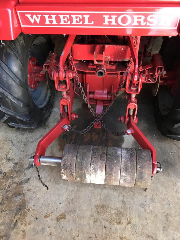

Firebug 267 #41 Posted February 3, 2019 Got my weight bar installed on the 3 point today. Really helped even with the ag tires. Still need to put my chains on but I could tell a difference in the spots where the driveway was still ice covered 4 Share this post Link to post Share on other sites
