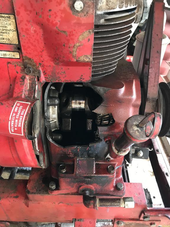

Firebug 267 #15 Posted January 22, 2019 I’ll get it, just going to take some trial and error, just didn’t want to have to pay someone to plow my driveways when I have a machine that’s more than capable of doing it. I didn’t have any issues with my d160 last year save for the motor letting go. But I did have the chains on it last year. Thought the gas would dig like the chains. But at least I didn’t scatter my motor this time 👍 6 Share this post Link to post Share on other sites
19richie66 17,950 #16 Posted January 22, 2019 Ouch! Share this post Link to post Share on other sites
Firebug 267 #17 Posted January 22, 2019 That one hurt a bit. Something else I noticed was only the left tire was spinning, is that right? I was under the impression that it was like a “locked” rear end where both tires would spin providing traction Share this post Link to post Share on other sites
