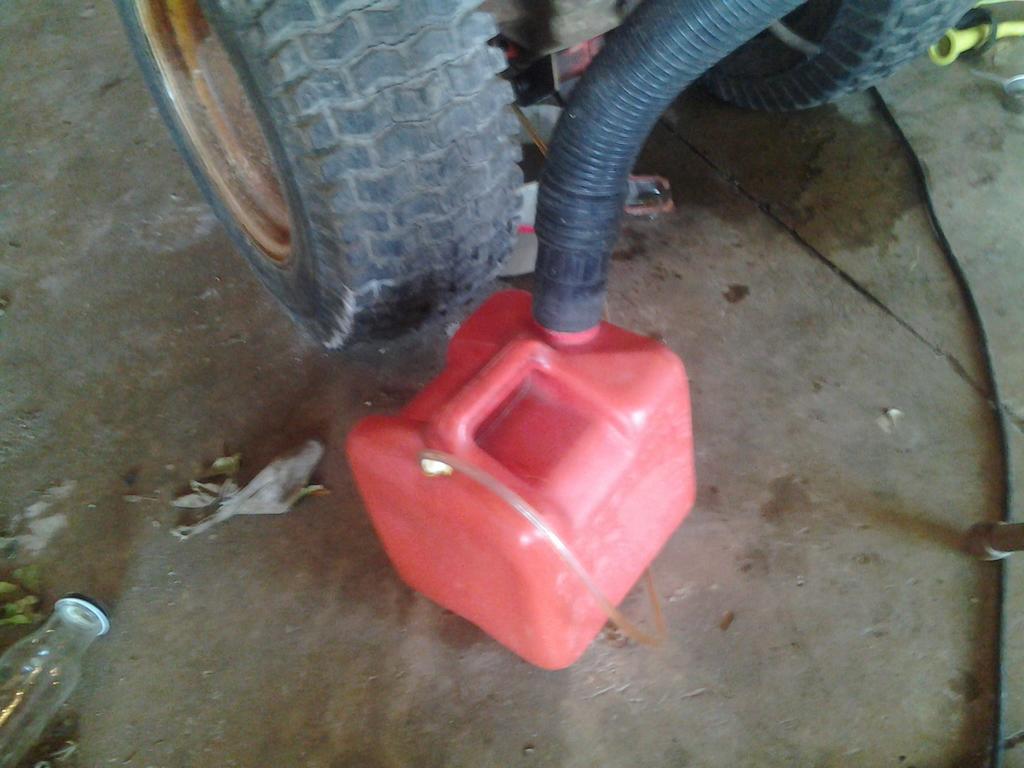

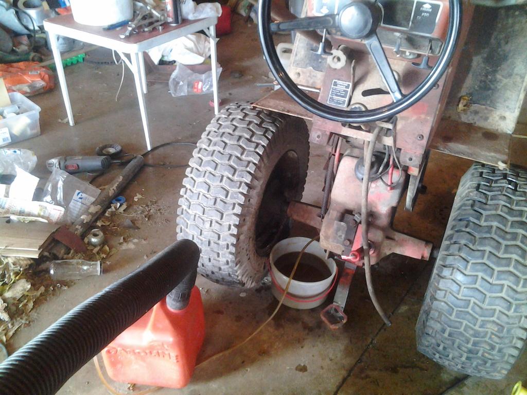

ohiofarmer 3,383 #5 Posted January 21, 2019 To speed up that process, I lift the tractor with a hoist really high--so high that taking out the battery is a good idea. ithen take some clear vinyl tubing and snap it over the nipple on an old fashioned gas jug. On the fill hole of the jug, apply suction from a shop vac. To get it really clean, spray some kerosine in the fill hole with an equipment cleaner from Harbor Freight and all kinds of additional dirt comes outhttps://www.harborfreight.com/engine-cleaning-gun-68290.html open link to view the tool 3 Share this post Link to post Share on other sites

ohiofarmer 3,383 #7 Posted January 21, 2019 The reason I used the cleaning gun to spray kero in there was I felt it might wash the dirt and rust off the gears. I used a suction hose to take all the residue out as you do not want that kero thinning down the gear oil.. All I know for sure is that the clear vinyl hose had a lot of brown grunge being sucked out of it..When it started turning clear, I put new gear oil in. It can be a dirty job. Maybe protect your eyes and wear old clothing you might have to throw away because of the smell. I just kept moving the end of the vinyl hose around the drain port to suck every place I could get. Share this post Link to post Share on other sites

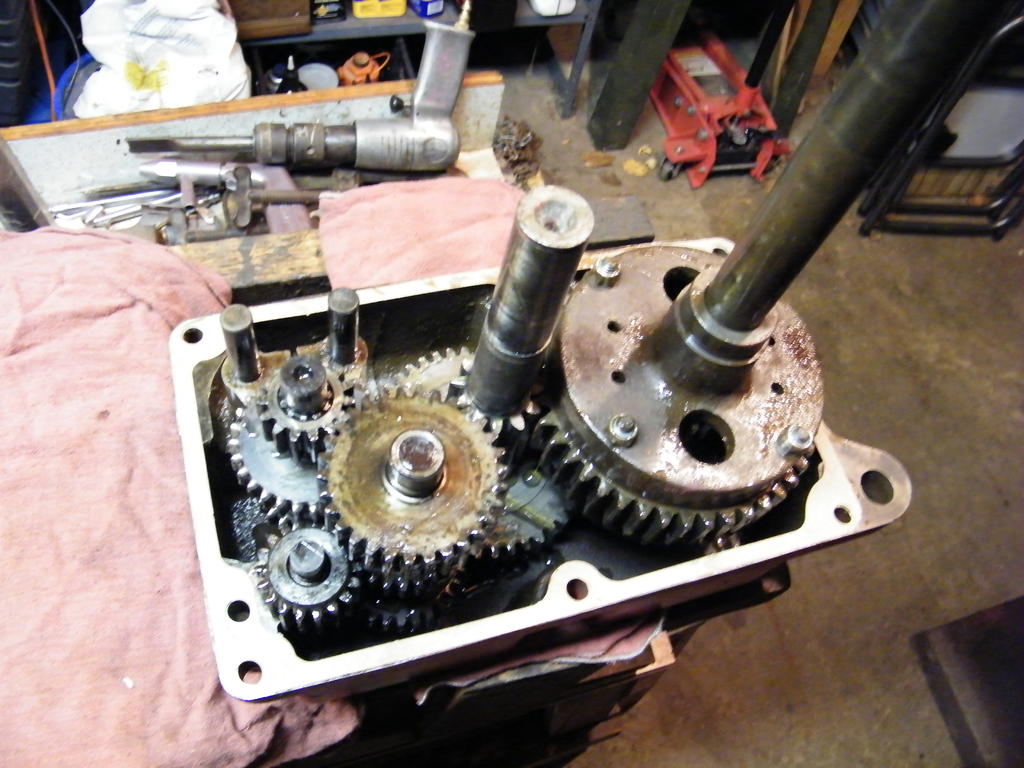

stevasaurus 23,620 #13 Posted January 23, 2019 @953 nut The differential is not entirely out of the oil at any time. It sits in 1" to 1 1/2" of oil and has nice sized holes for the oil to flow in and out. In this picture, you can see that the differential goes from top to bottom in the case half. It does sit in enough oil to coat the pinions that are on the bottom. 1 Share this post Link to post Share on other sites
