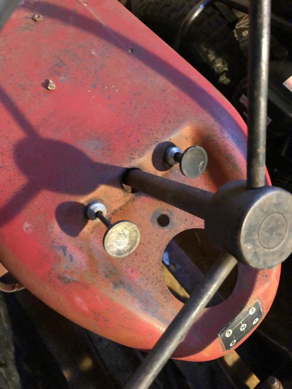

BHunter 1,702 #1 Posted January 21, 2019 Hi , Does anyone know where to buy the right length cables for a 1961 401 suburban? Mine are seized up. Thanks, Bob Share this post Link to post Share on other sites
ebinmaine 81,048 #2 Posted January 21, 2019 Bob can you get a picture of what you need? Share this post Link to post Share on other sites
BHunter 1,702 #3 Posted January 21, 2019 29 minutes ago, ebinmaine said: Bob can you get a picture of what you need? Share this post Link to post Share on other sites

dells68 7,499 #13 Posted January 22, 2019 I ordered a set exactly like those off of eBay for my 701 and they look great. Only one drawback, no way to lock the throttle to keep it on place. I like the idea someone else said about pulling the sire out of the sheath and kinking it a little to give it a little resistance. 2 Share this post Link to post Share on other sites
wallfish 20,724 #14 Posted January 22, 2019 5 hours ago, BHunter said: Hi , Does anyone know where to buy the right length cables for a 1961 401 suburban? Mine are seized up. Thanks, Bob Seized up or frozen from water inside? If frozen warm them up and soak them in antifreeze. You can cut the Z bend off and pull out the wire. The rust on the wire easily attaches to the ice so clean them up, gease'm and re-install. 2 Share this post Link to post Share on other sites
BHunter 1,702 #15 Posted January 22, 2019 48 minutes ago, wallfish said: Seized up or frozen from water inside? If frozen warm them up and soak them in antifreeze. You can cut the Z bend off and pull out the wire. The rust on the wire easily attaches to the ice so clean them up, gease'm and re-install. Seized. Is there a product I can soak them in that will desolve the rust? Share this post Link to post Share on other sites
wallfish 20,724 #16 Posted January 22, 2019 1 minute ago, BHunter said: Seized. Is there a product I can soak them in that will desolve the rust? Cider vinegar. It should work overnight. 2 Share this post Link to post Share on other sites
ebinmaine 81,048 #17 Posted January 22, 2019 @wallfish has a good idea there. You really should be able to carefully separate your existing cables if they are all solid and look okay. You should be able to reuse them. Patience is your friend. 1 Share this post Link to post Share on other sites
BHunter 1,702 #18 Posted January 22, 2019 1 hour ago, ebinmaine said: @wallfish has a good idea there. You really should be able to carefully separate your existing cables if they are all solid and look okay. You should be able to reuse them. Patience is your friend. I have lots of patience. They can soak in vinegar all winter if needed. Thanks 1 1 Share this post Link to post Share on other sites
