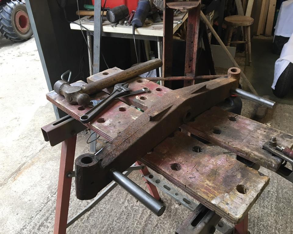

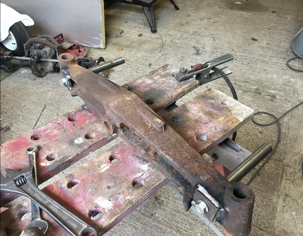

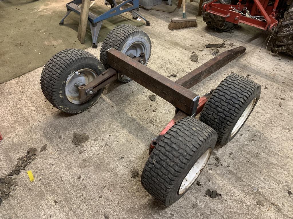

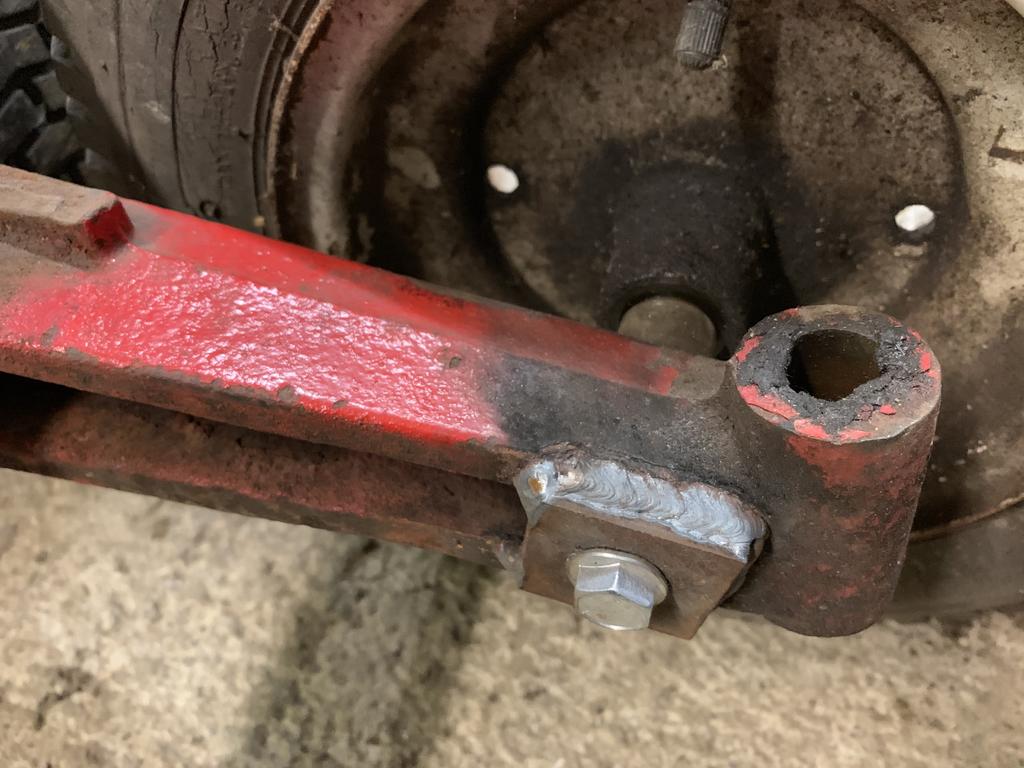

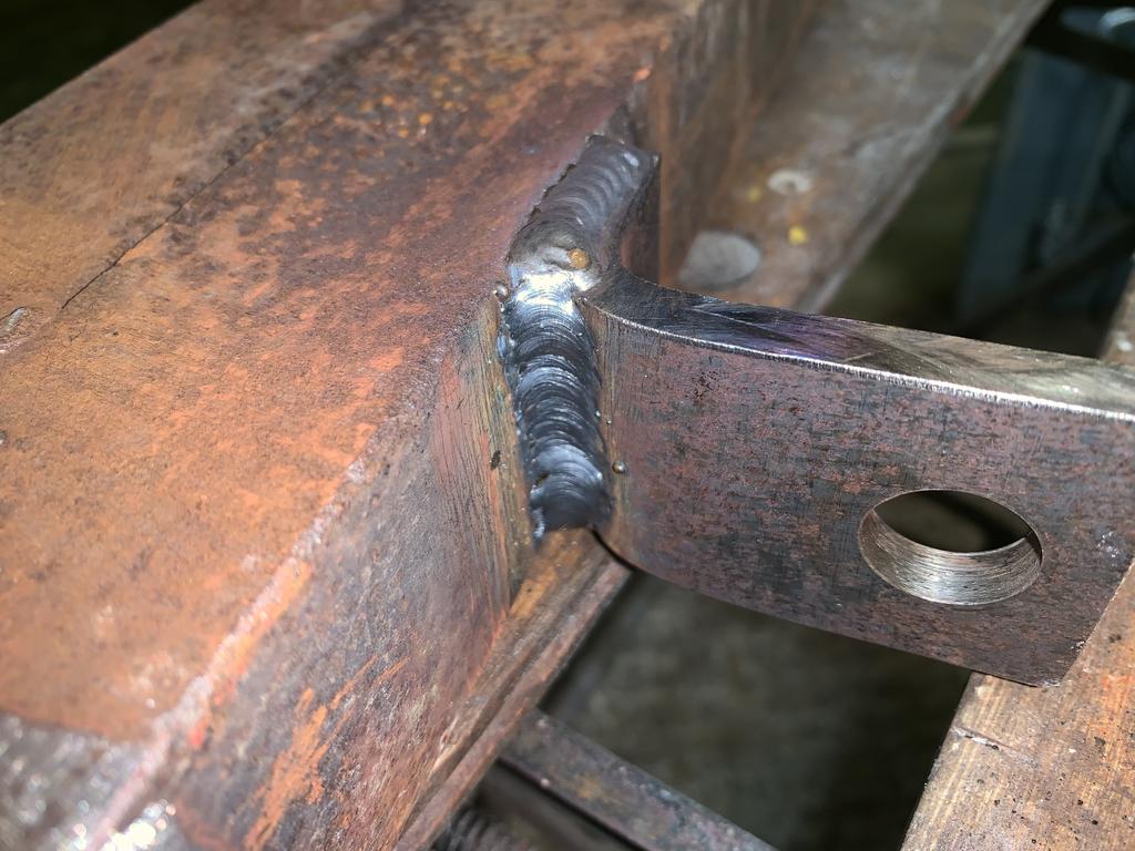

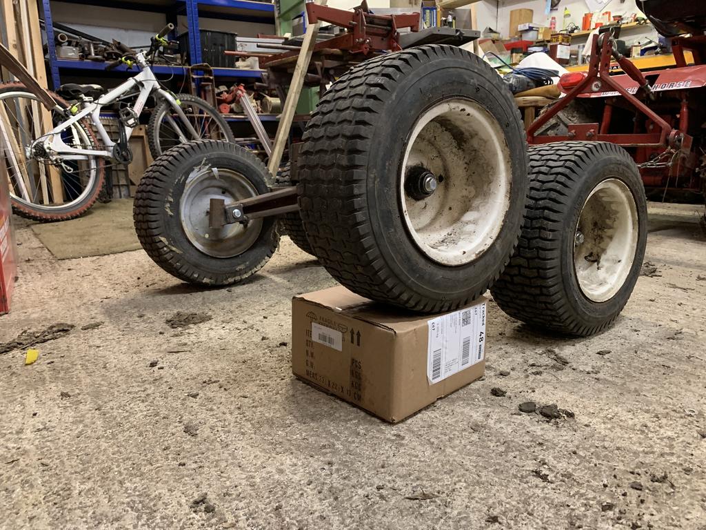

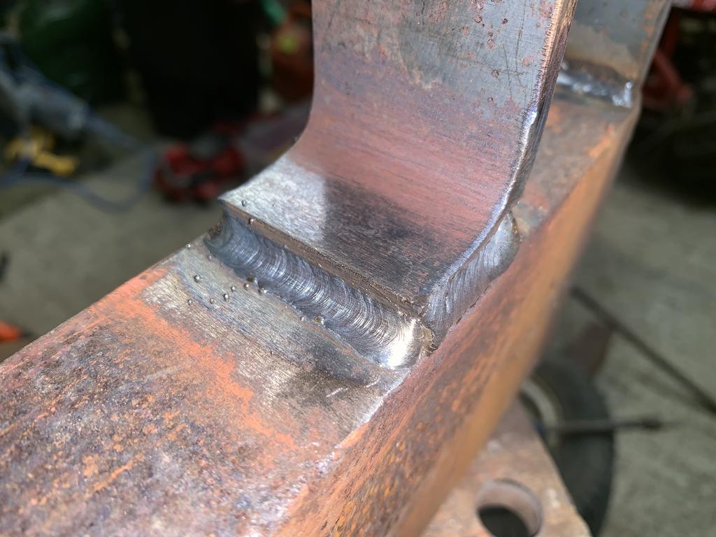

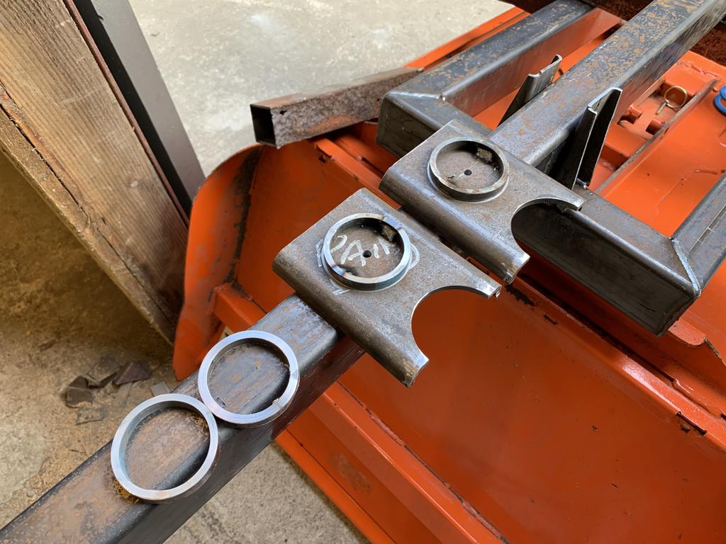

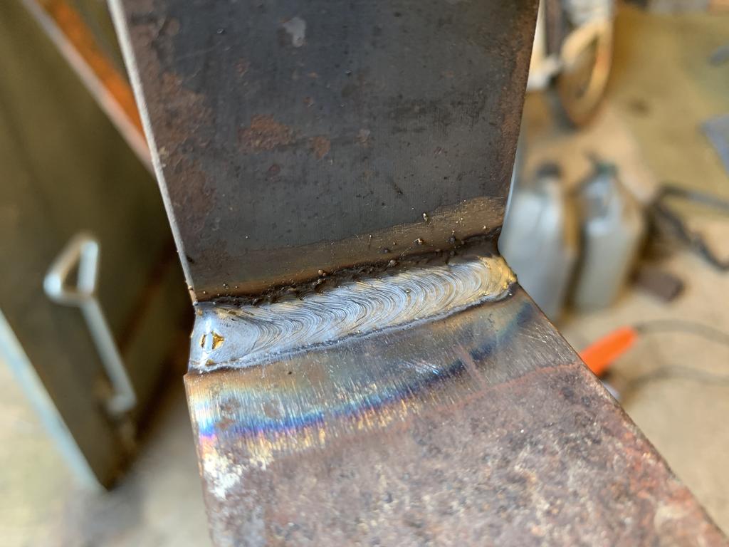

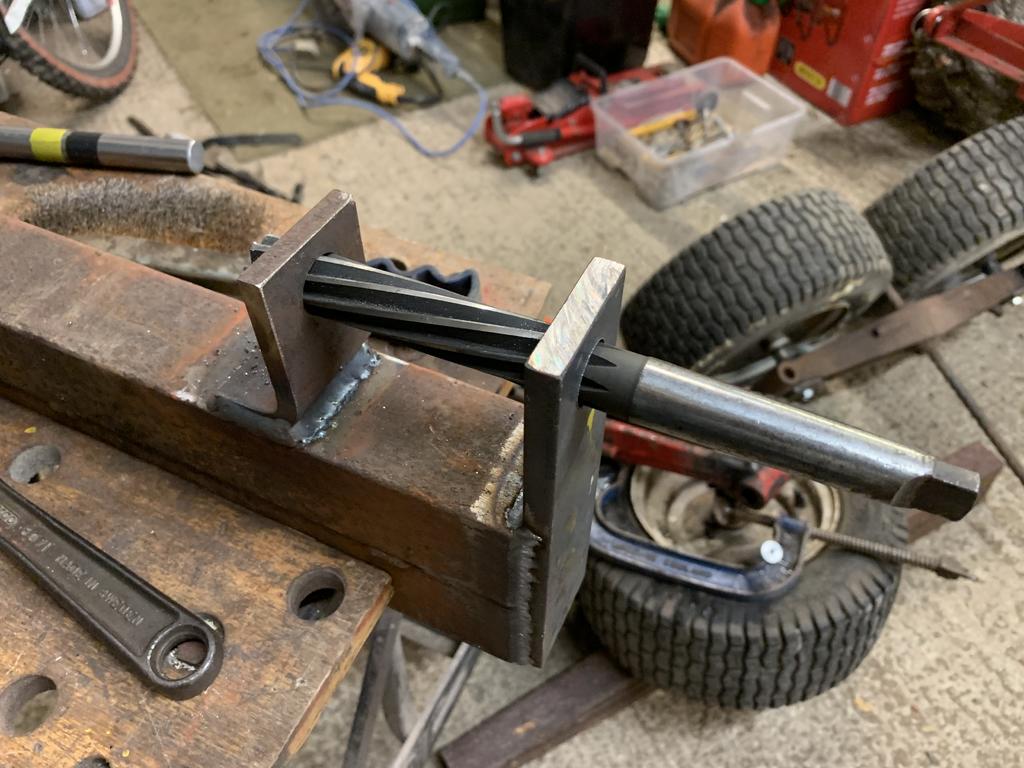

meadowfield 3,191 #1 Posted January 20, 2019 (edited) I had this idea years ago and started it a few years ago. Not sure if anyone has ever done the same, I found the parts and started to put it together the other day.... I might just have to finish it. thought I’d better share before I lose the pics from my phone! First adding new 3/4 axles through an old front axle Then welding end stops to bolt them to Wheel mounts like so Building the axle carriers - typical these welds won't ever be seen! reaming the holes to 3/4 to take new pins First test for articulation Now to work out the drawbar - and a hitch for the back of Bendy Edited January 21, 2019 by meadowfield 5 17 2 Share this post Link to post Share on other sites

953 nut 69,826 #5 Posted January 21, 2019 Outstanding, you have great ground clearance too. 2 Share this post Link to post Share on other sites
peter lena 10,091 #6 Posted January 21, 2019 meadowfield, outstanding work detail and ideas on that set up ! between the range of motion and the quality of the weld strength , that trailer or whatever you plan for this frame will move and function with solid ,smooth ,effortless pull on the tractor. your ideas are a testament to your work, great stuff, pete 2 Share this post Link to post Share on other sites
ebinmaine 80,960 #7 Posted January 21, 2019 Now that would be some kind of Handy here on the Mountainside. Super rough ground. Looking forward to seeing what you put for a body on it. 1 Share this post Link to post Share on other sites
meadowfield 3,191 #8 Posted January 21, 2019 (edited) Thanks guys, plan is to add a sprung drawbar and hydraulic tipping body. Plan A is manual hydraulic tip, plan B is to use the hydraulics on bendy... Edited January 21, 2019 by meadowfield 2 1 Share this post Link to post Share on other sites
wallfish 20,679 #9 Posted January 21, 2019 Good idea! Nice use of WH parts for the build. There's not very many things that haven't been done yet but think this is a new one. 2 Share this post Link to post Share on other sites
lynnmor 9,051 #10 Posted January 21, 2019 Welding steel to cast iron can be tricky, can you tell us what rod you used? Share this post Link to post Share on other sites
meadowfield 3,191 #11 Posted January 21, 2019 38 minutes ago, lynnmor said: Welding steel to cast iron can be tricky, can you tell us what rod you used? I don't think the axles are cast iron. They possibly have enough carbon to be steel, I used mild steel mig wire to weld. 2 Share this post Link to post Share on other sites
The Tuul Crib 7,354 #12 Posted January 21, 2019 I myself thought you would have used nickle rod Share this post Link to post Share on other sites
wallfish 20,679 #13 Posted January 22, 2019 6 hours ago, lynnmor said: Welding steel to cast iron can be tricky, can you tell us what rod you used? Cast steel, I used regular rods on that stuff too, 7018. Share this post Link to post Share on other sites
The Tuul Crib 7,354 #14 Posted January 22, 2019 18 hours ago, meadowfield said: I don't think the axles are cast iron. They possibly have enough carbon to be steel, I used mild steel mig wire to weld. Being the use these axle are if they were cast iron that would wear out quicker. That would make sense they would have more carbon. Share this post Link to post Share on other sites

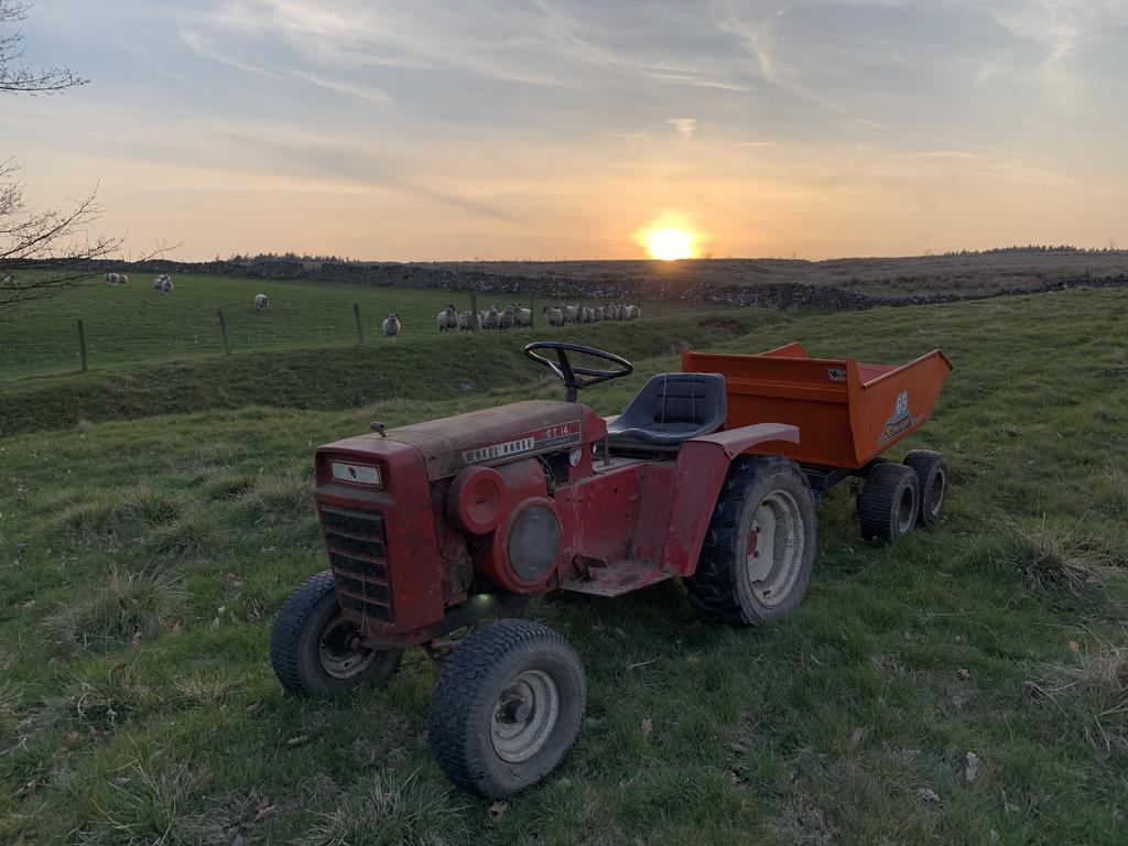

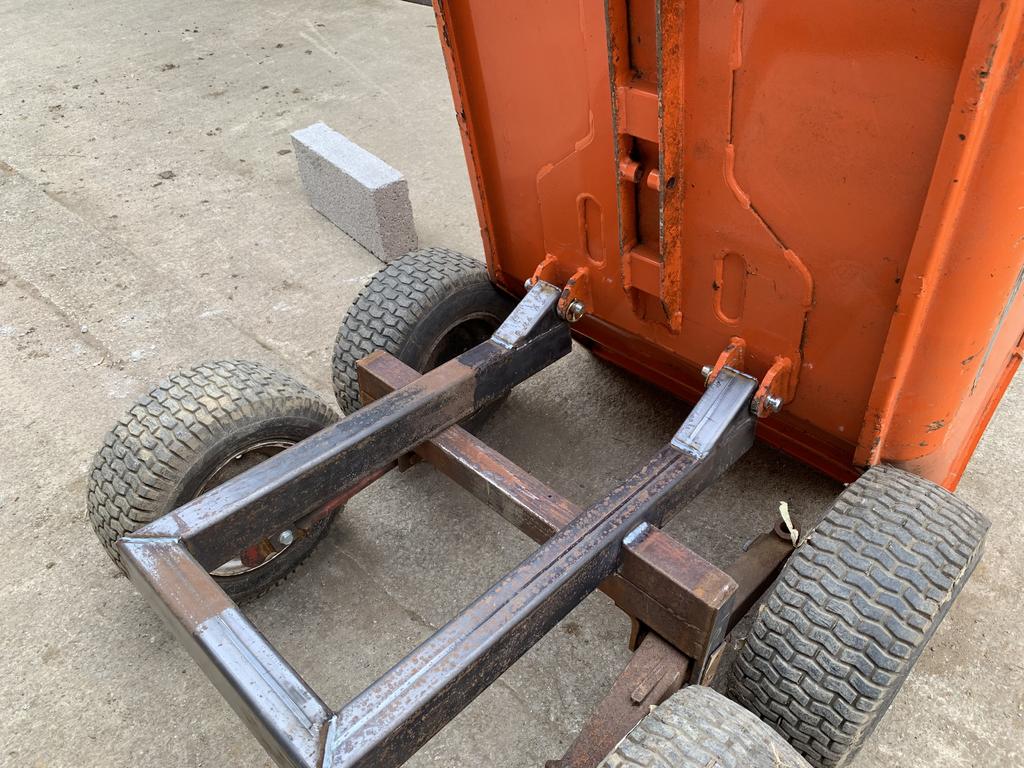

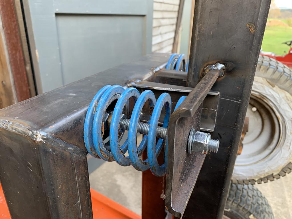

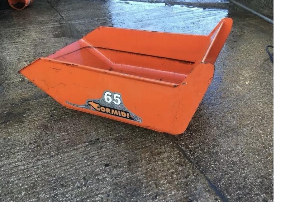

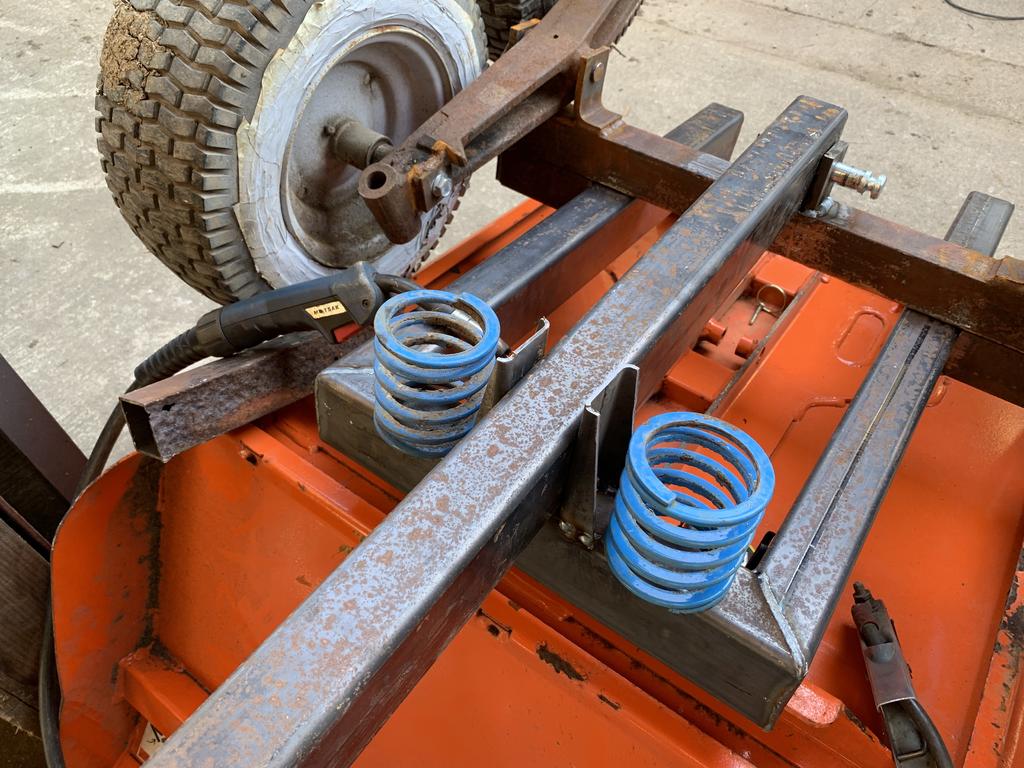

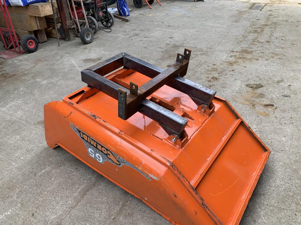

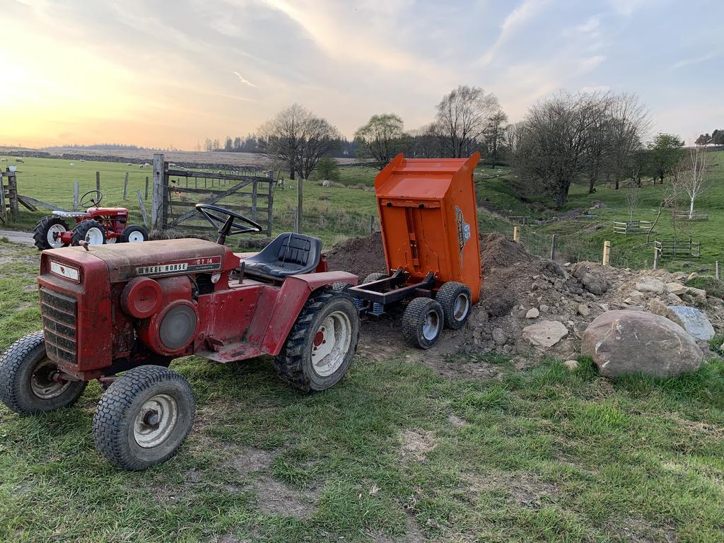

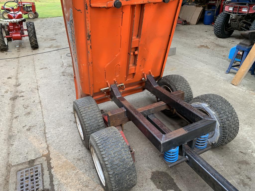

meadowfield 3,191 #15 Posted April 19, 2019 Long overdue update... i was was going to build a tipping body, but as look would have it a tracked dumper skip turned up so that spurred me on to make a frame to mount it... and on all fours Then a sprung drawbar still got the hydraulics to sort, but it’s all ready for a test drive... 8 4 1 3 Share this post Link to post Share on other sites
Stormin 9,988 #16 Posted April 19, 2019 I like it, Mark. I intend, hopefully, to build a twin axle tipper. Need to get a round to it one day. Share this post Link to post Share on other sites
Herder 2,356 #17 Posted April 19, 2019 Awesome build! The sheep like it too. 2 2 Share this post Link to post Share on other sites
ebinmaine 80,960 #18 Posted April 19, 2019 2 hours ago, meadowfield said: sprung drawbar What's the particular purpose of that? AWESOME build !!! Share this post Link to post Share on other sites
meadowfield 3,191 #19 Posted April 20, 2019 5 hours ago, ebinmaine said: What's the particular purpose of that? AWESOME build !!! The trailer is heavy, probably 150-200lbs empty. Full it probably weighs 1000+ I’ve deliberately put 80% of the weight on the rear end, which still leaves a lot of potential weight on the tractor hitch. When you go over the big bumps it’s a lot of force on the rear hitch and the springs take out that energy.... 3 2 Share this post Link to post Share on other sites
meadowfield 3,191 #20 Posted April 20, 2019 6 hours ago, Herder said: Awesome build! The sheep like it too. They were rather inquisitive! 1 Share this post Link to post Share on other sites
ebinmaine 80,960 #21 Posted April 20, 2019 56 minutes ago, meadowfield said: The trailer is heavy, probably 150-200lbs empty. Full it probably weighs 1000+ I’ve deliberately put 80% of the weight on the rear end, which still leaves a lot of potential weight on the tractor hitch. When you go over the big bumps it’s a lot of force on the rear hitch and the springs take out that energy.... Ooooooooooo.... I LIKE that!! Share this post Link to post Share on other sites
