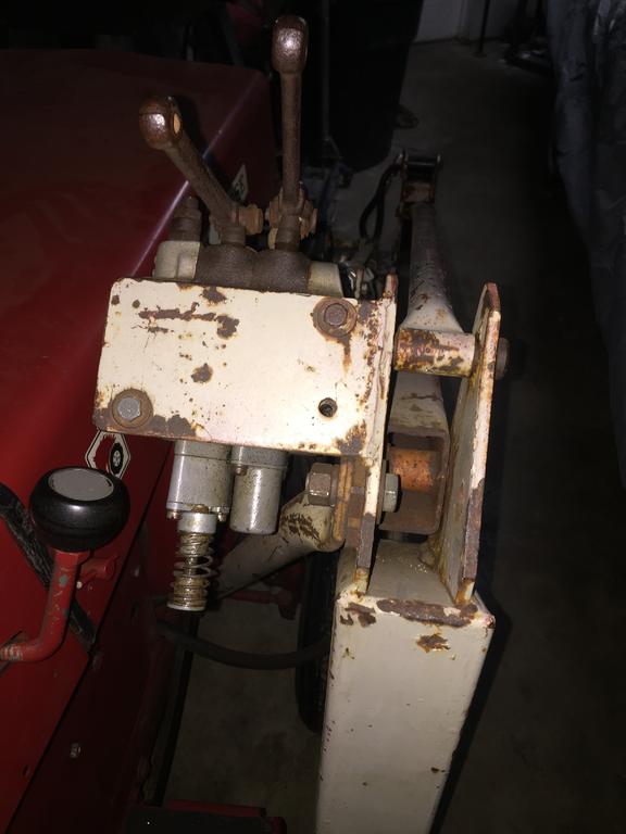

Dewsford 0 #1 Posted January 18, 2019 I just bought a d200 with a loader. It's a really nice tractor and everything works good. The omco valve is a little loose and the cap is busted off# 17 in the pic. Does anybody know where I can get parts for this? Ive been looking for 3 days now and still coming up short. The spring also seems bent. By the pics I've seen online it looks like an ark loader. Any help would be great thanks. Share this post Link to post Share on other sites

Dewsford 0 #5 Posted January 18, 2019 I'm talking about the one for the front loader. Share this post Link to post Share on other sites

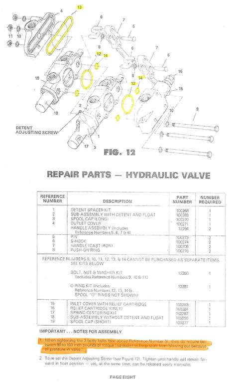

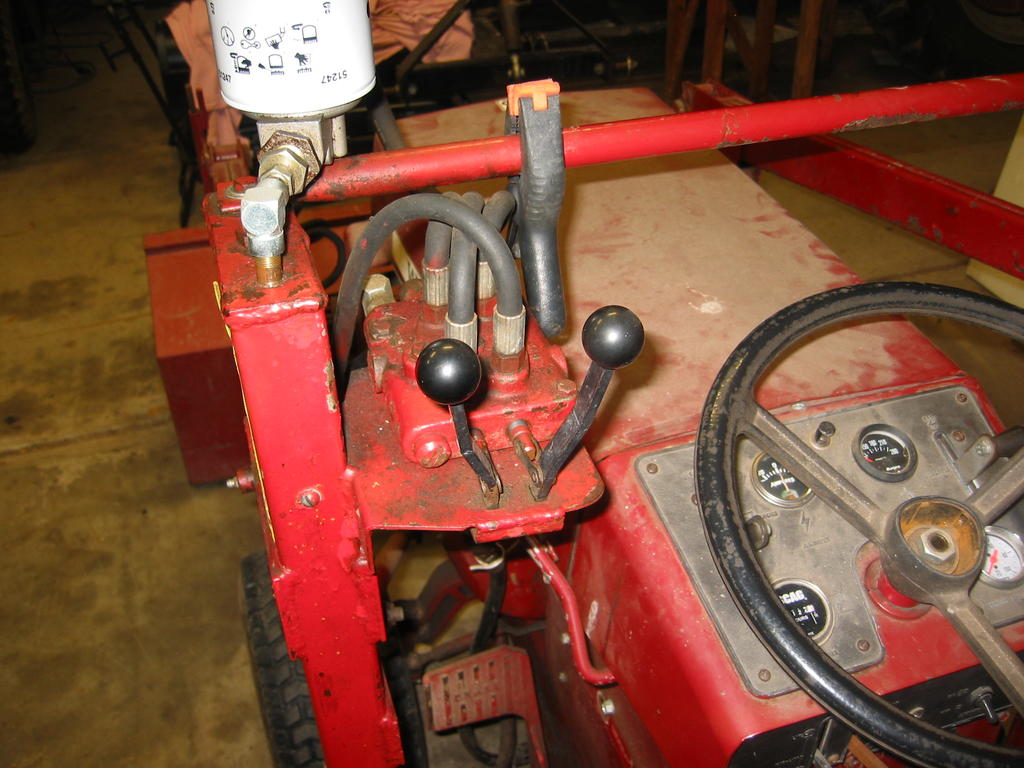

oliver2-44 11,782 #7 Posted January 19, 2019 @Dewsford A hydraulic shop can easily rebuild it or match the o-rings and you rebuild it. but I doubt they would have the cap. AiZ one of the vendors here is you best bet for a cap. I've been looking for a spec sheet on these. Does you valve have a "float position" i would really like to modify the valves on my C-160 to have "float" but haven't figured out what different parts I would need. Share this post Link to post Share on other sites

rjg854 13,405 #9 Posted January 19, 2019 This be the place to find answers, as you're starting to see. Best of luck with your project Share this post Link to post Share on other sites
oliver2-44 11,782 #10 Posted January 19, 2019 This manual may be of help WH Hydraulic Valve and Cylinder Repair Manual.pdf Share this post Link to post Share on other sites

wallfish 20,689 #12 Posted January 19, 2019 11 hours ago, oliver2-44 said: i would really like to modify the valves on my C-160 to have "float" but haven't figured out what different parts I would need. I think you might need a valve designed with float or change all the parts. Probably more effective to just buy a new valve although they are getting expensive. https://www.surpluscenter.com/Hydraulics/Hydraulic-Valves/Directional-Control-Valves/2-Spool-8-GPM-Prince-MB21GB5C1-DA-Valve-w-Float-9-7862-F.axd Share this post Link to post Share on other sites
Dewsford 0 #13 Posted January 19, 2019 Thanks for all the replies. I have found a bunch of manuals to rebuild this and a bunch of parts list, but never found any part numbers that work to buy what I need. I know it’s a OMCO valve But I don’t know what type loader I actually have I was just going off of pictures. Share this post Link to post Share on other sites
