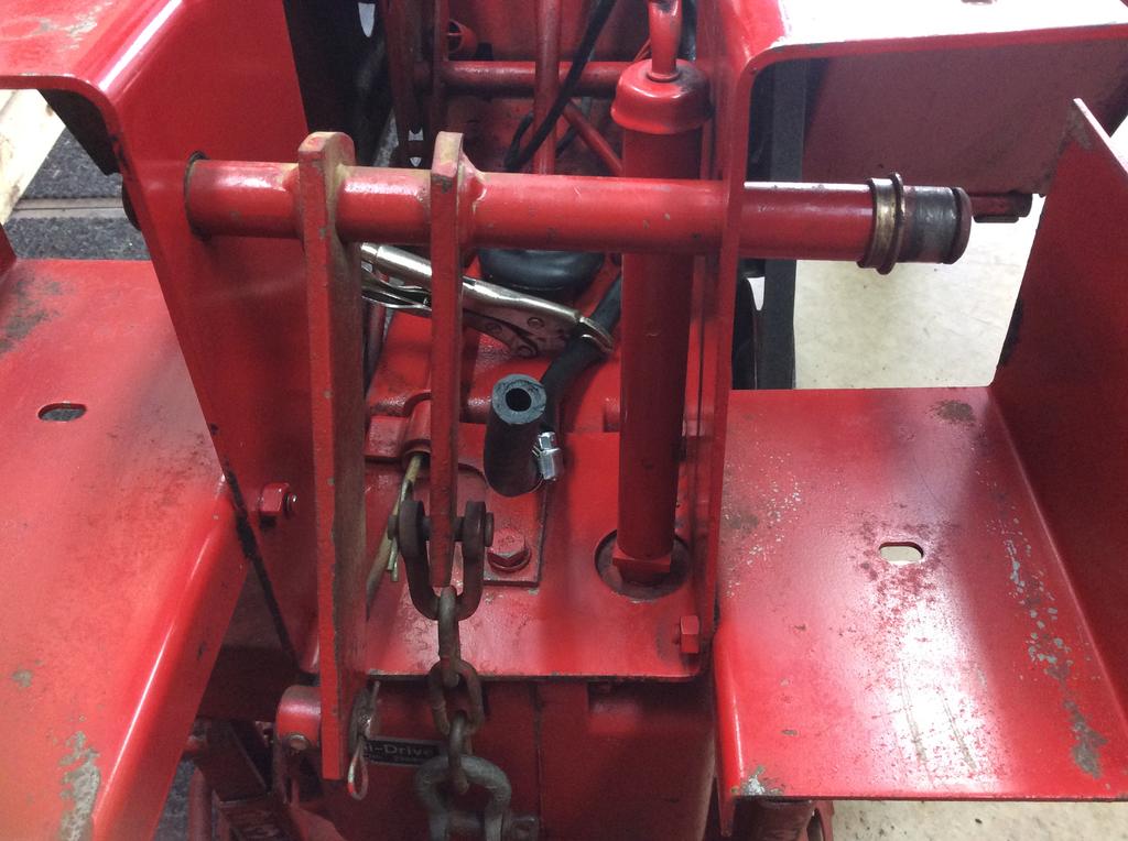

dkg520 527 #1 Posted January 14, 2019 Here is the problem. I had this rear hitch from a C160 and wanted to put it on a C81 but it appears it will not fit. Did Wheel Horse make different sizes or am I doing something wrong? Thank you for any help. Share this post Link to post Share on other sites
oldredrider 2,553 #2 Posted January 14, 2019 Different sizes. The rock shaft for pre '78 models is longer. You can cut the right side shaft shorter and regroove it for the snap ring. $20 at a machine shop. 1 Share this post Link to post Share on other sites

clueless 3,345 #7 Posted January 15, 2019 The c160 had the gas tank up front the c81 has the gas tank under the seat. That is why there is a difference, the hitch ( rock shaft) from any WH with the tank under the seat will work with the c81. Lowell makes a nice one. 1 Share this post Link to post Share on other sites
