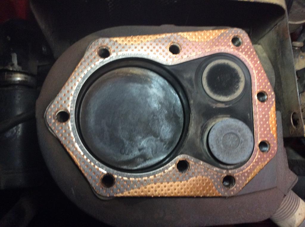

Blackhood Bill 722 #1 Posted January 13, 2019 (edited) Ok my question is this. Spark plug blew out, dad replaced head, spark plug blew out with used head, put heli-coil in, spark plug blew out again! Tonight pulled head gasket looks good. Would you replace gasket and what would cause this? What needs to be checked and where to start? Pics of gasket with head off attached. Any all help appreciated due to snow has finally arrived. Ordered new head and gasket. This is on a C-145 hydro, Kohler 14 hp K321AS engine with proper spark plug H-10 Edited January 13, 2019 by Whnewone Added info Share this post Link to post Share on other sites

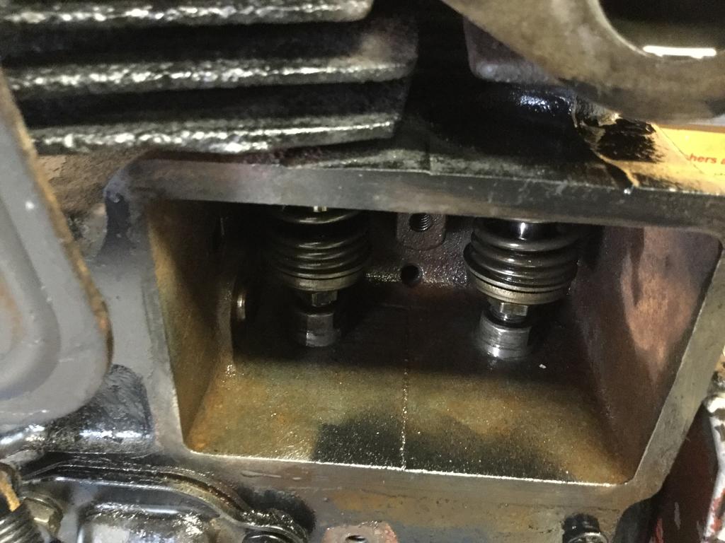

ztnoo 2,300 #13 Posted January 13, 2019 The intake valve is open in the pic, so the combustion chamber would be "vented", although the wrong way. That wouldn't blow a plug out. Unless both valves would not open, its either a problem with the heads (highly excessive compression ratio), the plug threading, or the spark plugs themselves. Was the head torqued to spec? Share this post Link to post Share on other sites

Shynon 7,505 #20 Posted January 13, 2019 You will need to do a leakdown test, ACR will not allow for a compression test. Has the block been sleeved? Reason I ask is the ledge around the piston that is lower than the top of the cylinder and the piston if off center. Something just doesn't look right. Share this post Link to post Share on other sites
Blackhood Bill 722 #21 Posted January 13, 2019 If it has I don't know but that would something to look at for sure. Will have to take gasket off and clean it up for examination. Share this post Link to post Share on other sites
