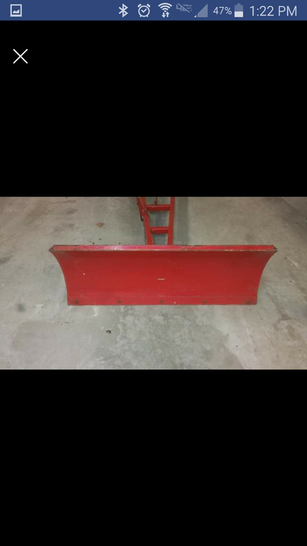

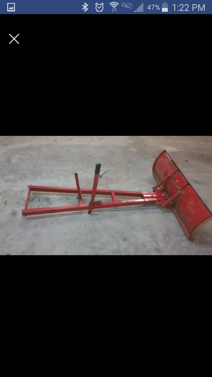

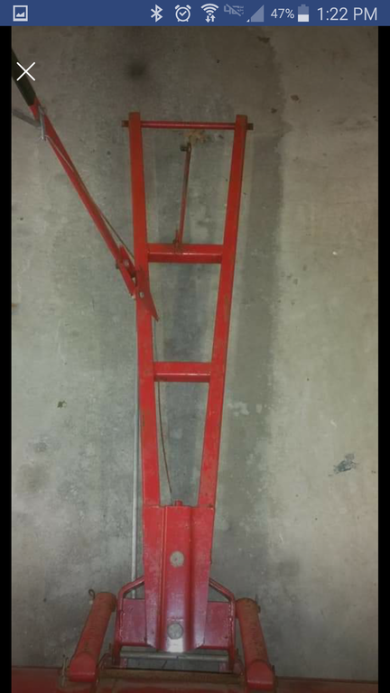

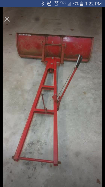

John Mulqueen 8 #1 Posted January 12, 2019 Can anyone tell me about the plow. It has a 42" blade. What it fits. And why the frame is different than others I have seen. Thanks Share this post Link to post Share on other sites
WVHillbilly520H 10,379 #2 Posted January 12, 2019 That's for a short frame tractor(657,857)... not the long frames 1973 newer ...B,C,3,4,500 series garden tractors. 5 4 Share this post Link to post Share on other sites
gwest_ca-(File Mod) 12,458 #3 Posted January 12, 2019 If the white spot in the center of the blade is the serial number decal we may be able to come up with a positive model year. The rear axle brackets are unique to the early blades. Dozer DNA of short tractor frame dozer blades 1961 model BD-4271 - Fits SHORT frame tractors - Mounts ahead of the rear axle - replaced by 1962 model BD-4262 - Fits SHORT frame tractors - Mounts ahead of the rear axle 1963 model BD-4263 - Fits SHORT frame tractors - Mounts ahead of the rear axle 1964 model BD-4264 - Fits SHORT frame tractors - Mounts ahead of the rear axle 1965-1966 model BD-4264A - Fits SHORT frame tractors - Mounts ahead of the rear axle 1967 model BD-4267 - Fits SHORT frame tractors - Mounts ahead of the rear axle 1968 model 6-2111 - Fits SHORT frame tractors - Mounts ahead of the rear axle ----------------------------------------------------------------------------------------------------------------------------------- 1968 model 6-4111 - First to fit LONG & SHORT frame tractors and first to mount under the rear axle - replaced by 1969 model [6-4112 + 6-9621] 1970-73 model [6-4113 + 6-9622] 1973-74 model [6-4113 + 6-9623] 1974 model [6-4114 + 6-9624] 1974 model 6-2131 1975 model 6-2132 1976 model 6-2133 1976 model 66-42BC01 1977 model 76-42BC01 1978 model 86-42BC01 1979 model 96-42BC01 1980 model 06-42BC01 1981-1984 model 06-42BC02 (Up to here they are 42" wide) -------------------------------------------------------------------------------- 1984-1989 model 06-48BC01 (They are now 48" wide) 1990 model 06-48BC02 1991-1993 model 06-48BC03 1993-2001 model 79350 2002 2004-2009 2012 model 79364 Garry 1 1 1 Share this post Link to post Share on other sites
John Mulqueen 8 #4 Posted January 13, 2019 14 hours ago, gwest_ca said: If the white spot in the center of the blade is the serial number decal we may be able to come up with a positive model year. The rear axle brackets are unique to the early blades. Dozer DNA of short tractor frame dozer blades 1961 model BD-4271 - Fits SHORT frame tractors - Mounts ahead of the rear axle - replaced by 1962 model BD-4262 - Fits SHORT frame tractors - Mounts ahead of the rear axle 1963 model BD-4263 - Fits SHORT frame tractors - Mounts ahead of the rear axle 1964 model BD-4264 - Fits SHORT frame tractors - Mounts ahead of the rear axle 1965-1966 model BD-4264A - Fits SHORT frame tractors - Mounts ahead of the rear axle 1967 model BD-4267 - Fits SHORT frame tractors - Mounts ahead of the rear axle 1968 model 6-2111 - Fits SHORT frame tractors - Mounts ahead of the rear axle ----------------------------------------------------------------------------------------------------------------------------------- 1968 model 6-4111 - First to fit LONG & SHORT frame tractors and first to mount under the rear axle - replaced by 1969 model [6-4112 + 6-9621] 1970-73 model [6-4113 + 6-9622] 1973-74 model [6-4113 + 6-9623] 1974 model [6-4114 + 6-9624] 1974 model 6-2131 1975 model 6-2132 1976 model 6-2133 1976 model 66-42BC01 1977 model 76-42BC01 1978 model 86-42BC01 1979 model 96-42BC01 1980 model 06-42BC01 1981-1984 model 06-42BC02 (Up to here they are 42" wide) -------------------------------------------------------------------------------- 1984-1989 model 06-48BC01 (They are now 48" wide) 1990 model 06-48BC02 1991-1993 model 06-48BC03 1993-2001 model 79350 2002 2004-2009 2012 model 79364 Garry Thank you Garry Any idea of a fair selling price? Share this post Link to post Share on other sites
