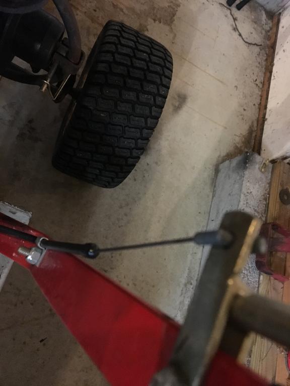

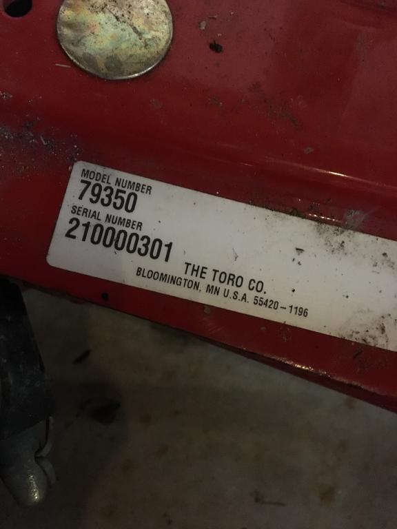

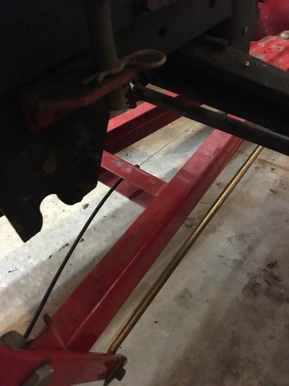

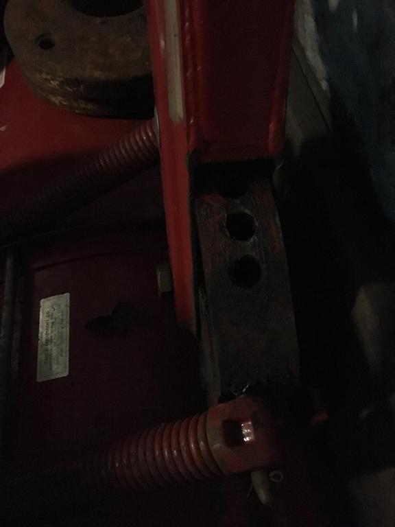

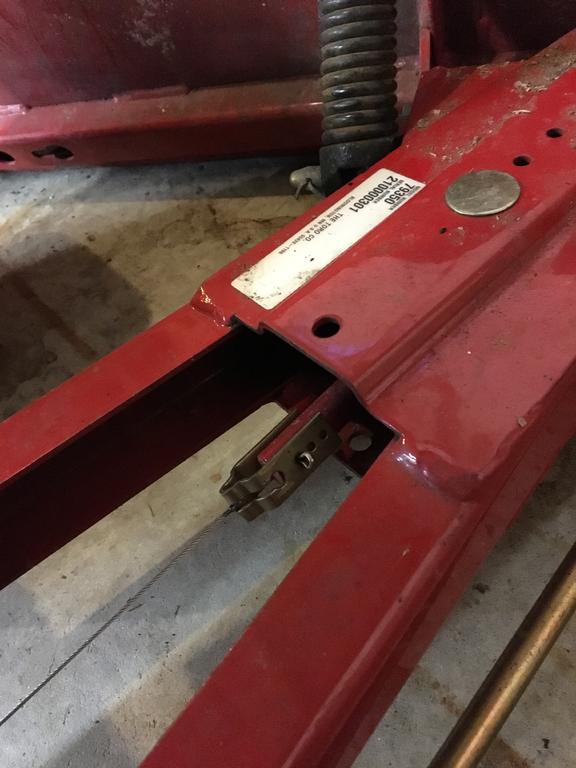

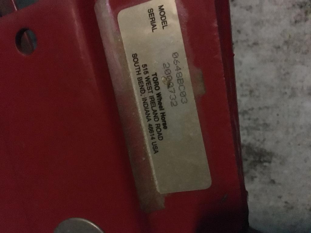

Sparky-(Admin) 23,263 #1 Posted January 11, 2019 Somehow I have acquired two 48” snowplows with the 5 hole sectors. The weird thing is I never see them or hear anything about them. Mine are very different in the angling hardware. One has the standard rigid wire to the triangle plate that pivots and pulls the angle position pin. The other has a cable similar to the brake cables on a bicycle. The angle arm also has some interesting factory bends in it. They both work perfect. Are they rare? What years were they produced? 3 Share this post Link to post Share on other sites
WVHillbilly520H 10,376 #2 Posted January 11, 2019 I don't know about rarity but the xi and 260 series blades had the 5 position quadrants maybe even earlier, but that angle lever with the cable is what my dealer ordered for me way back in the fall of 1998 for the mid 70s 3 position blade I bought for the Anniversary 520H. 3 Share this post Link to post Share on other sites
gwest_ca-(File Mod) 11,512 #3 Posted January 11, 2019 Dozer DNA of long tractor frame dozer blades 1966-1967 model BD-426 - Fits LONG frame tractors - Mounts ahead of the rear axle - replaced by 1968 model 6-1111 - Fits LONG frame tractors - Mounts ahead of the rear axle ---------------------------------------------------------------------------------------------------------------------- 1968 model 6-4111 - First to fit LONG & SHORT frame tractors and first to mount under the rear axle - replaced by 1969 model [6-4112 + 6-9621] 1970-73 model [6-4113 + 6-9622] 1973-74 model [6-4113 + 6-9623] 1974 model [6-4114 + 6-9624] 1974 model 6-2131 1975 model 6-2132 1976 model 6-2133 1976 model 66-42BC01 1977 model 76-42BC01 1978 model 86-42BC01 1979 model 96-42BC01 1980 model 06-42BC01 1981-1984 model 06-42BC02 (Up to here they are 42" wide) 1984-1989 model 06-48BC01 (They are now 48" wide) - replaced by the following 1990 model 06-48BC02 - Last blade to have 3 angle positions - 30 degrees left, straight and 30 degrees right 1991-1993 model 06-48BC03 - First blade to have 5 angle positions 1993-2001 model 79350 2002 2004-2009 2012 model 79364 Garry 4 1 Share this post Link to post Share on other sites

peter lena 9,301 #5 Posted January 12, 2019 yes ,I like that cable pull, much better at working with the angles at the lever, quadrant area. this is the kind of great ideas that will let you improve your horse, if you want to , pete 1 Share this post Link to post Share on other sites
