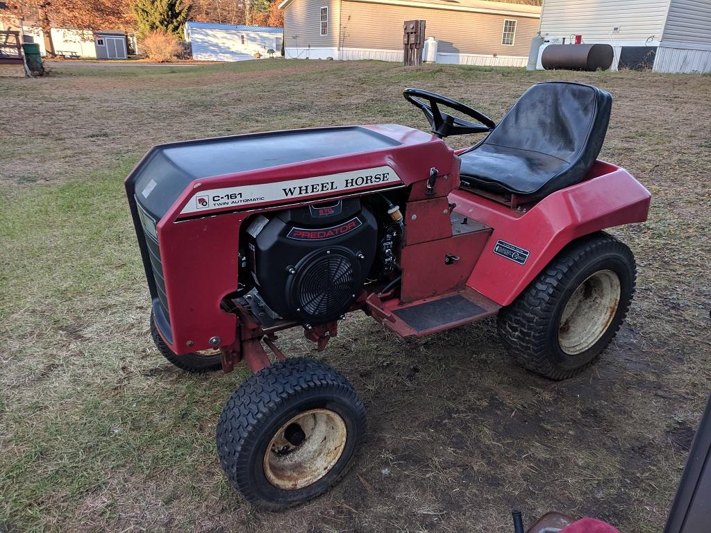

cschannuth 3,821 #12 Posted January 11, 2019 I replaced the rubber mounts on my ‘78 C-161 with solid mounts and didn’t notice any added vibration. I did get much improved power transfer though the belt. The rubber mounts deflected so much that the drive belt never achieved full tension on the pulley and would cause slipping. By the way, don’t be scared of the Briggs. It’s the only Wheel Horse engine I’ve never had to work on or rebuild. 5 1 Share this post Link to post Share on other sites
Firebug 267 #13 Posted January 11, 2019 What tires are on the front of that, are those the Firestone’s? Share this post Link to post Share on other sites

cschannuth 3,821 #16 Posted January 11, 2019 2 hours ago, Firebug said: What tires are on the front of that, are those the Firestone’s? Yes sir. Share this post Link to post Share on other sites
