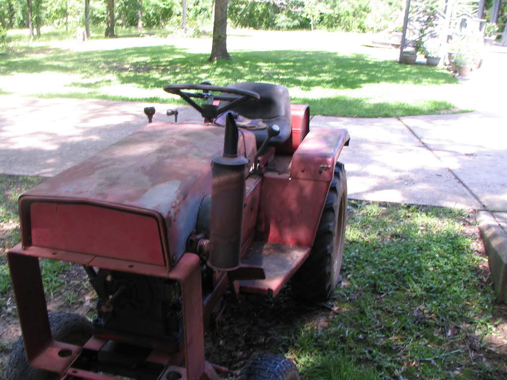

pacer 3,179 #6 Posted January 10, 2019 Original mufflers are VERY hard to find here in the states so I would imagine even more so over your way.... These are off one of the Cub Cadets adapted here on my D200 and D160. Mind you they required some fabrication, especially on the 200, needing to remove the old pipe fittings and weld up a rather sharp bend to get under the hood, but with the side entry on the Cub muffler is easily mounted there. The 160 was much simpler --- The Cub muffler is also rather inexpensive here, around the $30 range --- and, I like the sound, not very loud but with just a bit of 'tone' 1 Share this post Link to post Share on other sites
