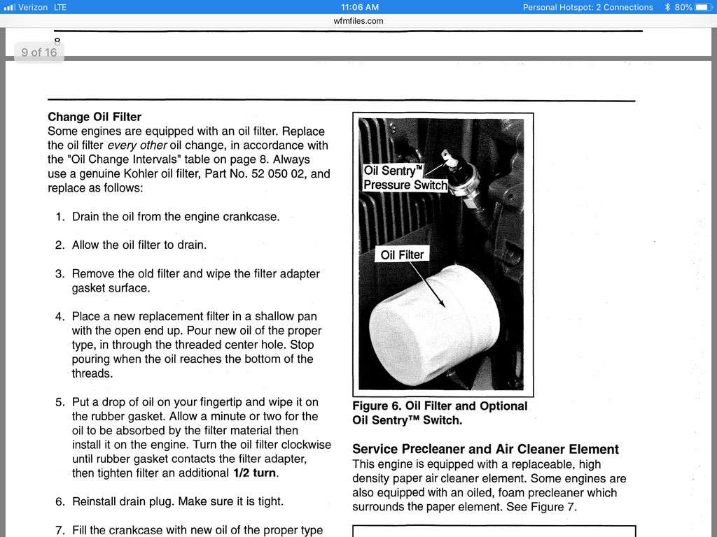

Pullstart 68,761 #2 Posted January 9, 2019 I found this on a google search, then found the manual. do you have a pressure tap above the filter like the picture here? 2 Share this post Link to post Share on other sites

pfrederi 19,790 #4 Posted January 9, 2019 If your engine is an original Spec# 49146 it is a series 1. Manual says it only makes about 5 psi. Not even clear if you have the tap mentioned above that is on SeriesII engines. Keep it topped off stay off hills for xtended periods and don't worry about it. 2 Share this post Link to post Share on other sites
Skipper 1,790 #5 Posted January 9, 2019 (edited) It's a series 1, and it does not have filter but the protrusion where the tap is, is there, just not drilled and tapped. Guess I could go inn that way, but 5 psi ain't much. Doubt I could easily find a gauge to accommodate that low of a pressure. Yeah I know the ground rules on keeping the KT's running just think it could be a neat little thing, being able to monitore the pressure. Edited January 9, 2019 by Skipper Share this post Link to post Share on other sites
Skipper 1,790 #6 Posted January 9, 2019 (edited) So I found all the service and owners manuals for series 1 and 2 and the magnum equivalents. The Series 1 made about 5 psi, The series 2 from 25-50. And the magnums after them made about the same as Series 2. Also notised that the series 2 could be had with an oil filter, that fits the same adapter as the Magnum engine. Meaning that a series 2 can run a standard oilfilter setup, or a relocated oil filter setup from the magnums accessory list, and an oil cooler on that line. I do not think I will bother much more with a pressure gauge setup on a series 1, when the obvious choice would be an engine swap to a newer (but very much almost identical) engine, once the old girl is worn out. Heck, that might even be for the grand children to figure out . Better get some stuff stockpiled Edited January 9, 2019 by Skipper 1 Share this post Link to post Share on other sites
