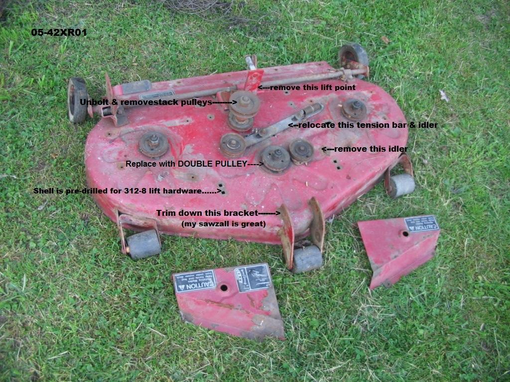

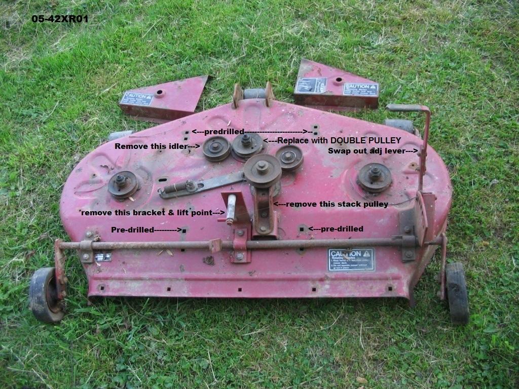

daveoman1966 3,611 #2 Posted January 7, 2019 (edited) The 42" deck for the B-111 is 05-42XR01 (thru05) and the deck for the C-160 should be 05-42MR01 (thru05). Here are a few pics of how to convert the B deck for use on the C-160: The bearings are either # 109966 (top and bottom) IF the shaft does NOT use a woodruff key (the shaft is 5/8 dia on top). If there is a woodruff key in the shaft, then the bearings are #106084 and 106085 and the top end of the shaft is 3/4" dia. Remove a pulley and look at the spindle shaft to be sure. I MAY have a double pulley for the center spindle. I also have some new and good used bearings to fit...either case. Edited January 7, 2019 by daveoman1966 Share this post Link to post Share on other sites

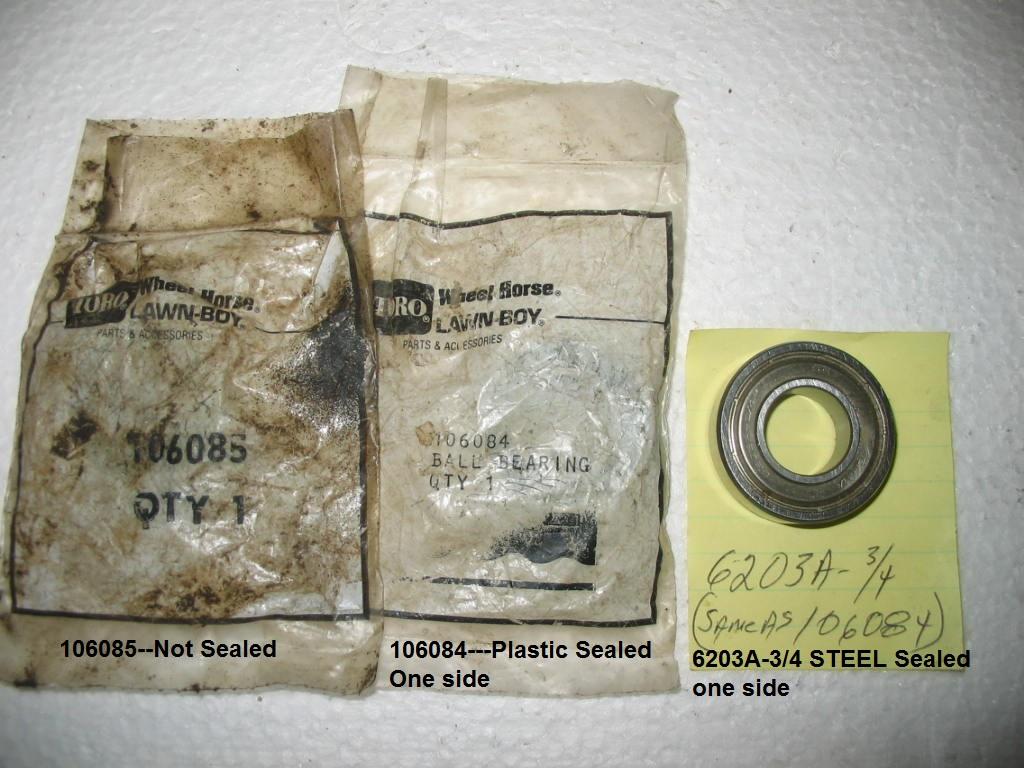

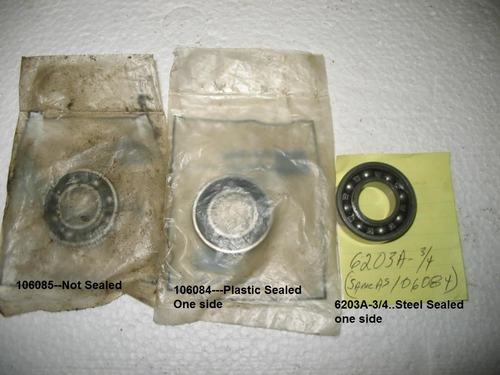

Stepney 2,314 #6 Posted January 8, 2019 Hey, all. After looking into bearings, I found that Toro 106084 and 106085 seem to be the same bearing? What's the difference between them? Share this post Link to post Share on other sites
daveoman1966 3,611 #7 Posted January 8, 2019 106084 is sealed ONE side. 106085 is NOT sealed on either side. Otherwise, the same. I have one NEW set 106084 & 106085 (2 bearings) for $20. I can provide 2 good used sets for $15 (4 bearings). Ship will be $5 bux for any 1 or all of these. Herew is a pic of the two NEW bearings....(not the bearing on yellow paper in these pics). my email is: daveoman@windstream.net 1 Share this post Link to post Share on other sites
