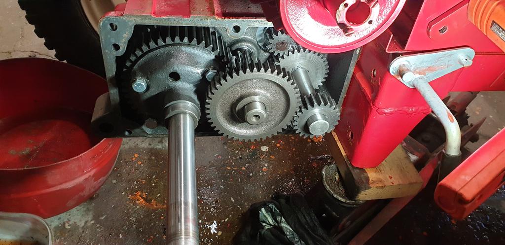

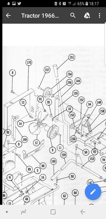

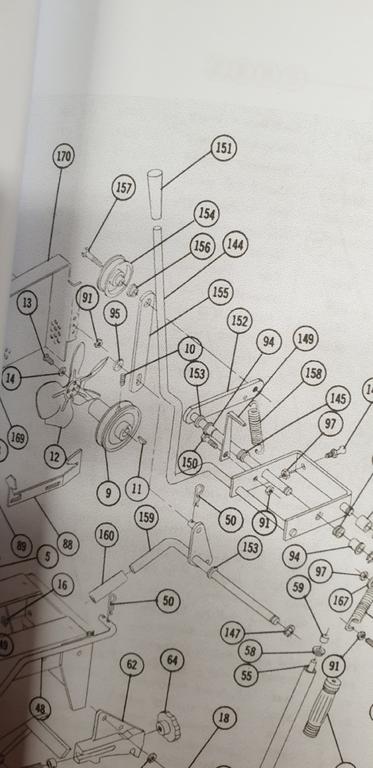

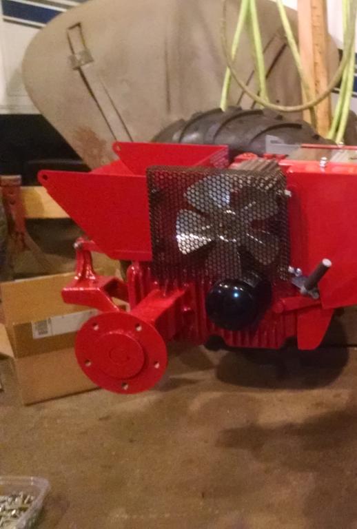

Joan Dorst 41 #1 Posted January 7, 2019 hello I am new on this forum and I own a Wheel Horse 1276 automatic Drive. I am refurbishing this Wheel Horse and now I am running into a few problems. I miss a few parts of the handbrake if I had the measurements I can do it but I do not get that in the Netherlands. I miss part 154, 155 & 156. Now that I am looking for the exact dimensions of part 155, I can make it in the Netherlands. can you help me with that? (See the pictures) Sorry for my bad English. I translated this on Google Translate. 1 Share this post Link to post Share on other sites

gwest_ca-(File Mod) 12,519 #3 Posted January 7, 2019 #154 - MW-8821 flat idler pulley is 2.469" OD x .375" ID x .750 wide. One supplier in Canada https://www.bantasaw.com/catalog/viewproduct.asp?i=&p=609 Garry Share this post Link to post Share on other sites
Joan Dorst 41 #4 Posted January 7, 2019 Thank you Garry! The pulley is not the problem. I am looking especially for the rod where it is attached Share this post Link to post Share on other sites
WHX?? 58,324 #5 Posted January 7, 2019 Joan Yes the pulley and spacer are a common Item but the 155 arm you will have to make. Dan @Achto has a 1076 and might be able to get you the measurements to make one. You can also try emailing http://a-ztractor.com/ as he or others here may have a parts tractor. Others will be along to welcome you and hopefully help out. 2 1 Share this post Link to post Share on other sites

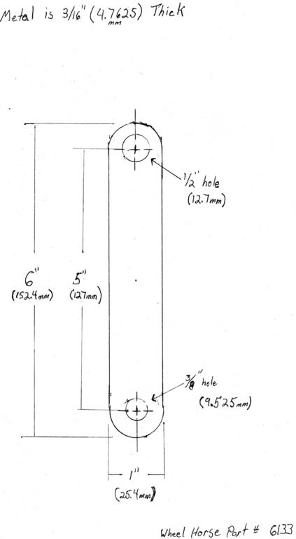

Achto 32,889 #8 Posted January 9, 2019 Here is a drawing to help you make part 155 / Wheel Horse part #6133. 4 Share this post Link to post Share on other sites
Joan Dorst 41 #9 Posted January 9, 2019 Thank you very much!! 1 Share this post Link to post Share on other sites

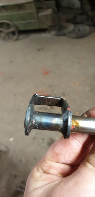

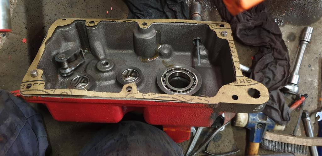

Joan Dorst 41 #14 Posted January 10, 2019 hello I disassembled the gearbox to view and repair the handbrake. but the axle does not look excessively worn? Is this the problem? Share this post Link to post Share on other sites

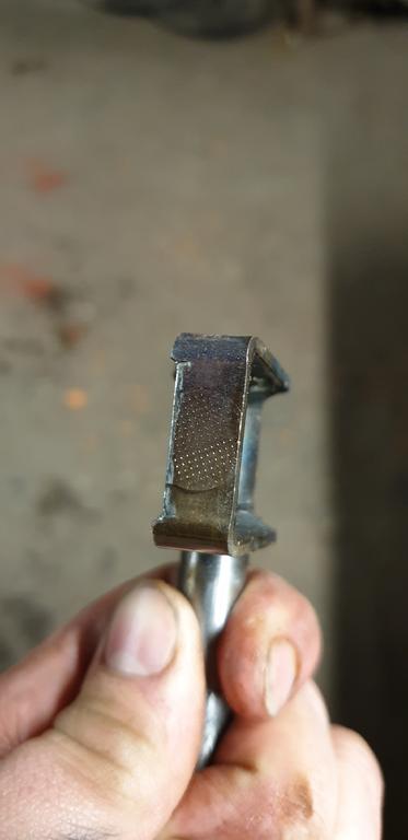

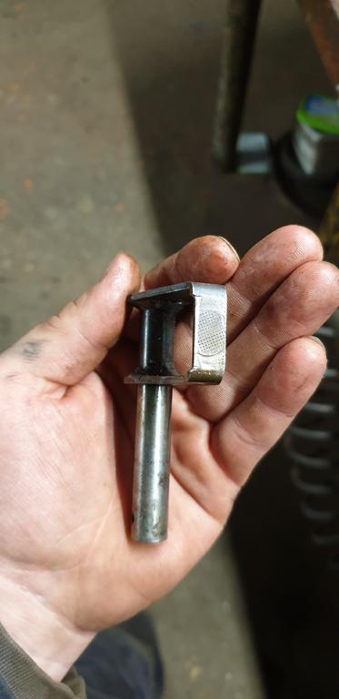

pfrederi 21,274 #15 Posted January 10, 2019 That is probably the best parking pawl I have ever seen!! Most are ground down much further in the area circled. You could lay a bead of weld across it and file/grid it smooth...but in this case I would clean up any roughness and use it as is. 2 1 Share this post Link to post Share on other sites

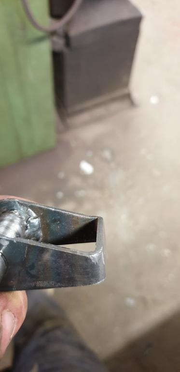

Joan Dorst 41 #16 Posted January 10, 2019 10 minutes ago, pfrederi said: That is probably the best parking pawl I have ever seen!! Most are ground down much further in the area circled. You could lay a bead of weld across it and file/grid it smooth...but in this case I would clean up any roughness and use it as is. I'm going to file it smooth and I will mount it back and then I'll see if the stand is okay. what do you think of this? 1 1 Share this post Link to post Share on other sites
pfrederi 21,274 #17 Posted January 10, 2019 Should work 1 Share this post Link to post Share on other sites
Sarge 3,473 #18 Posted January 11, 2019 The width of the piece that is circled is important - it must be wide enough to engage the gear tooth deep enough to hold the weight of the tractor. I generally cut that piece off and weld a new piece of steel in there to return it back to the original width. That width is the same as the side pieces that are on the shaft. I've only had one that was in good condition other than being rounded off a little - just slightly rounded off meant it would not hold the tractor on anything but flat ground - so it got a new piece welded in and that fixed the issue. Those brake pawls were a less than stellar design and even the later ones with the gear style teeth weren't all that great, either. Sarge 1 Share this post Link to post Share on other sites

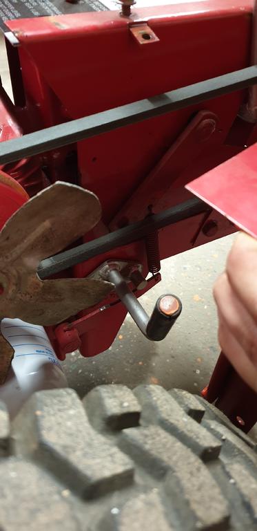

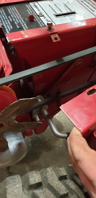

Joan Dorst 41 #19 Posted January 15, 2019 Hello I have made my handbrake and the gearbox closed again but now I have a question what is the size of the v-belt? 2 2 Share this post Link to post Share on other sites
Joan Dorst 41 #20 Posted January 15, 2019 I also look for the sizes of protective cover for the cooling fan (170) 1 Share this post Link to post Share on other sites
WHX?? 58,324 #21 Posted January 15, 2019 V-belt is a 6489 which crosses to a 7927 or 4L780 ( 1/2" wide BY 78" long ). This is a drawing made by Dan @Achto for the guard. double check the dimensions. If I remember right one might have been a little off? fan-guard-2016-04-04.PDF 1 1 Share this post Link to post Share on other sites

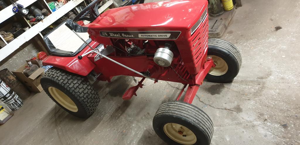

Achto 32,889 #22 Posted January 15, 2019 (edited) 1 hour ago, WHX21 said: If I remember right one might have been a little off? I don't remember either. What can I say, some times I tend to be a little off. The 2 holes in the front bracket can be placed to your liking. the single hole will have to line up with the hole in the drive belt guard. The 2 brackets for the rear mount will have to line up with the two holes in the tool box. I'll get you a picture. Edited January 15, 2019 by Achto 2 Share this post Link to post Share on other sites
Achto 32,889 #23 Posted January 15, 2019 (edited) Here is a picture of what it should look like when done. Let me know if you need more pictures. Edited January 15, 2019 by Achto 1 1 Share this post Link to post Share on other sites
Joan Dorst 41 #24 Posted January 15, 2019 I still have the braces, only the protective cap. thank you very much for the information again! 1 Share this post Link to post Share on other sites
