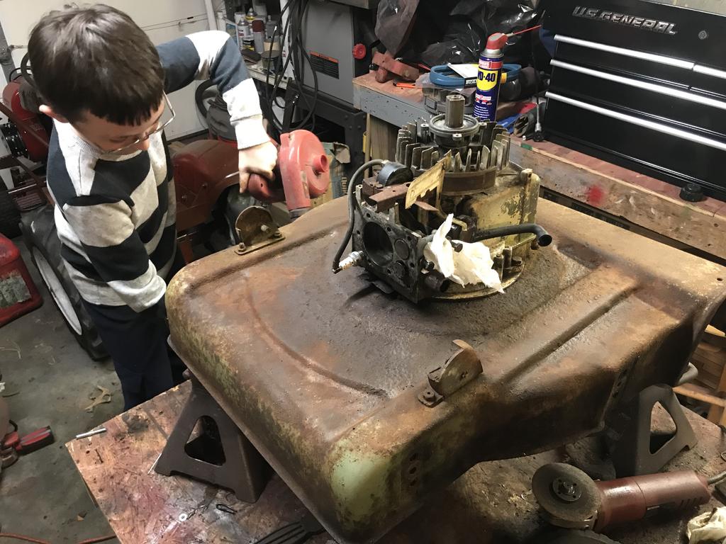

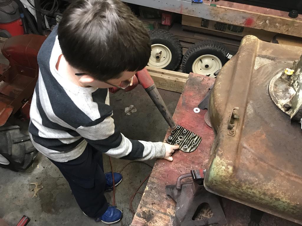

dells68 7,499 #29 Posted January 20, 2019 Couple of pics of Emory working on his push mower. 6 2 Share this post Link to post Share on other sites

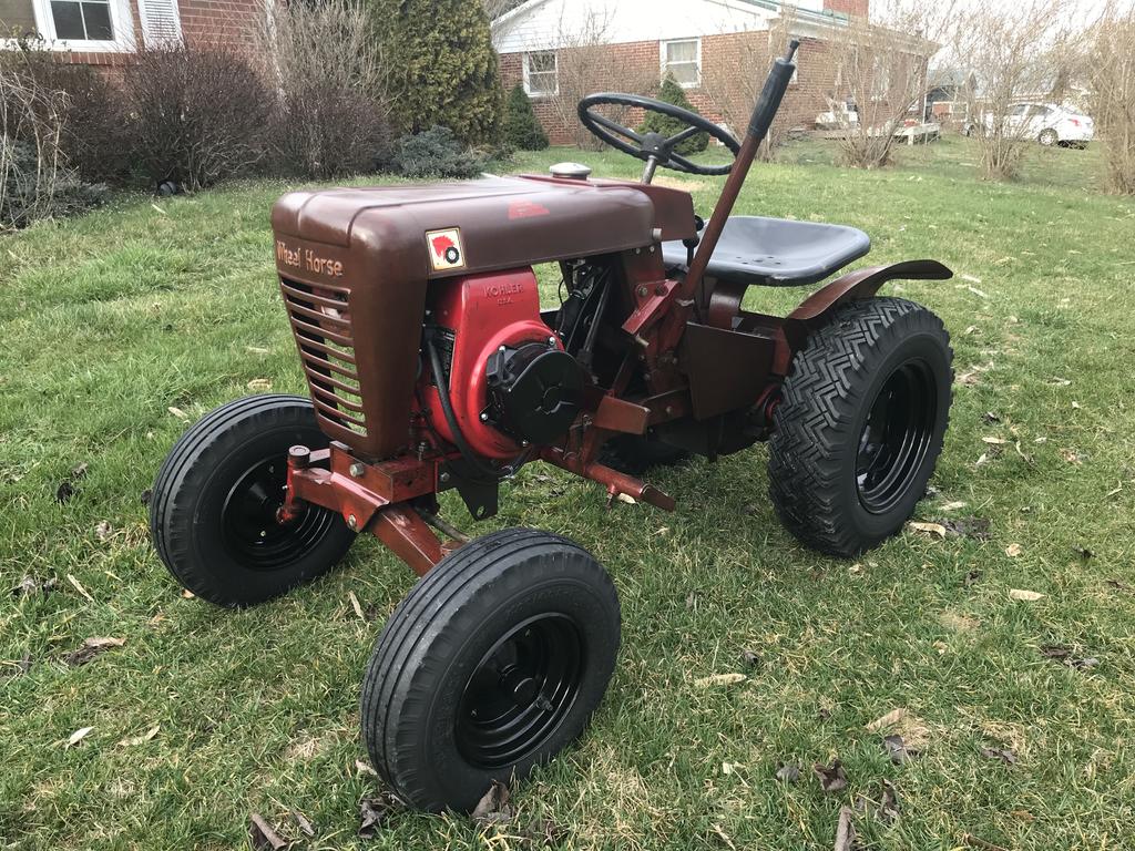

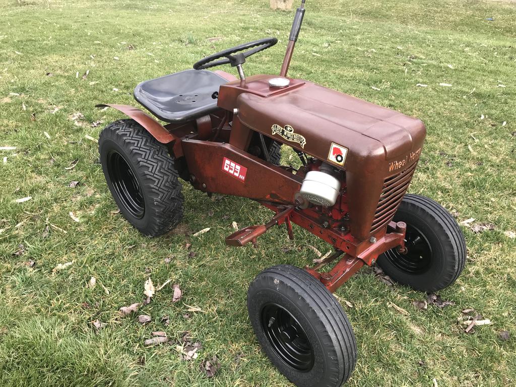

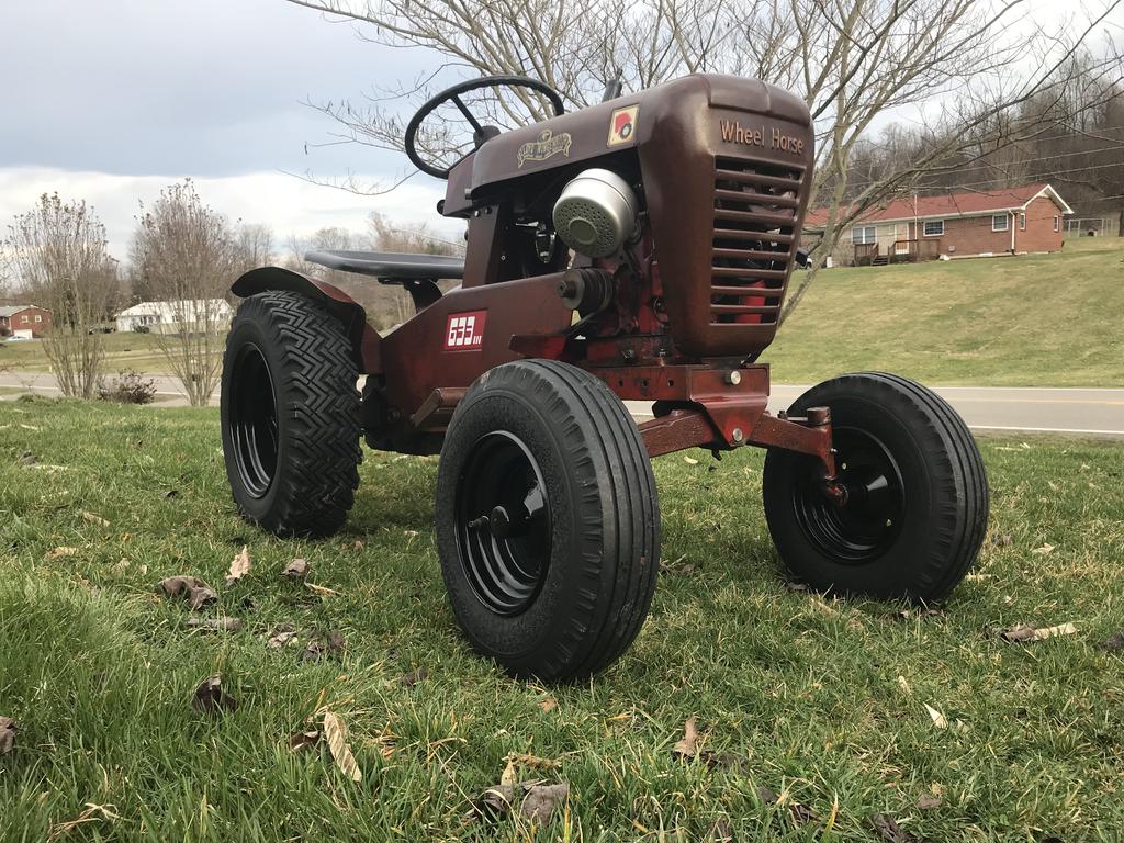

dells68 7,499 #33 Posted March 3, 2019 Well, I finally found time to finish Emory’s 633. I found that the pulse pump will lose its prime after sitting for a while. The crankcase pulse doesn’t seem strong enough to overcome the resulting vacuum lock in the pulse pump. I added a marine primer bulb and bam, problem solved. Once running the pulse pump does it’s job without any problem. 5 5 1 Share this post Link to post Share on other sites

dells68 7,499 #36 Posted March 3, 2019 That is actually an old Pontiac dealer sticker on the hood. We left it because it tells part of the tractor’s history. Don’t know if anyone noticed, but I found a 1 piece tank and put on it. I put a new gasket on the old tank and it still started leaking after sitting a few days. It had a few old repairs and I think there might have been some hairline cracks. I had sealed the tank with sealer and it failed. Someone had made a replacement bottom when they fixed the tank and it seemed to cause the failure. I sealed a 754 tank at the same time and it is fine. I painted a “patina” on the tank and it looks pretty good with the theme Emory picked. I wanted to paint the wheels white, but Emory insisted on black. I can’t take credit for the wheels, that was all Emory. Boy knows what he wants! 2 2 1 Share this post Link to post Share on other sites
