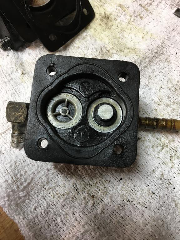

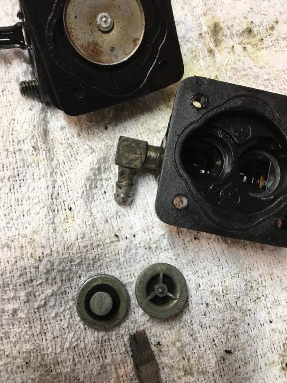

Sparky-(Admin) 25,948 #1 Posted January 6, 2019 Guys...I screwed up, took apart this fuel pump last week and just now geting back to it. Can’t remember which way the two small parts go in that my screwdriver is pointing at. Should have taken a pic or two Share this post Link to post Share on other sites
Sparky-(Admin) 25,948 #2 Posted January 6, 2019 I reached out to John ( @wallfish ) and he set me straight. They go in opposite and are check valves, fuel is incoming thru the right side of my pic, leaves the fuel pump thru the left side with the 90 degree fitting. Learned something today.. thanks John!! 5 1 Share this post Link to post Share on other sites
953 nut 67,500 #3 Posted January 6, 2019 If you put them in backwards the inlet becomes the outlet and the outlet becomes the inlet. 3 Share this post Link to post Share on other sites
Sparky-(Admin) 25,948 #4 Posted January 6, 2019 2 hours ago, 953 nut said: If you put them in backwards the inlet becomes the outlet and the outlet becomes the inlet. Ok...now Ive learned two things today 1 Share this post Link to post Share on other sites
