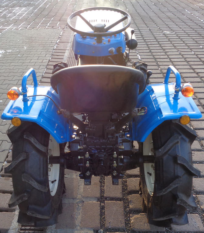

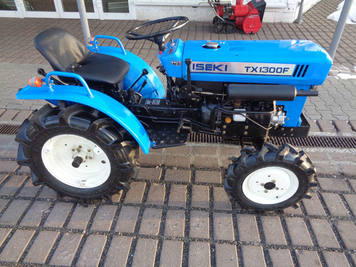

ohiofarmer 3,437 #20 Posted January 20, 2019 Since there was interest in iseki, i will tell you my first hand experience. Iseki tractors were imported by White, now a part of Agco-Allis or whatever they call it today. My dad was getting up in years and he could no longer lever stones on to the stone boat to remove them from the ground. He needed a tractor with a front end loader to help him lift stuff and keep working past retirement age. This tractor was about 60 Horsepower and the thing that struck me was during the dealer preparing the tractor, part of the proceedure was using cloth sandpaper on the pins of the three point hitch. Show me an American tractor with such tight tolerances. Dad always took care of his machinery--always stored inside. the paint on the Iseki was thin and lost whatever gloss was there pretty quickly. everything else on the machine was just great. I would not be afraid of them from a quality standpoint 1 Share this post Link to post Share on other sites
Tractorhead 9,217 #21 Posted January 24, 2019 On 20. Januar 2019 at 12:59 PM, ohiofarmer said: Since there was interest in iseki, i will tell you my first hand experience. Iseki tractors were imported by White, now a part of Agco-Allis or whatever they call it today. My dad was getting up in years and he could no longer lever stones on to the stone boat to remove them from the ground. He needed a tractor with a front end loader to help him lift stuff and keep working past retirement age. This tractor was about 60 Horsepower and the thing that struck me was during the dealer preparing the tractor, part of the proceedure was using cloth sandpaper on the pins of the three point hitch. Show me an American tractor with such tight tolerances. Dad always took care of his machinery--always stored inside. the paint on the Iseki was thin and lost whatever gloss was there pretty quickly. everything else on the machine was just great. I would not be afraid of them from a quality standpoint Thanks to all of you, for your open and honestly answers. i take a decision, will pickup next weekend. .... pic come soon .. Share this post Link to post Share on other sites
