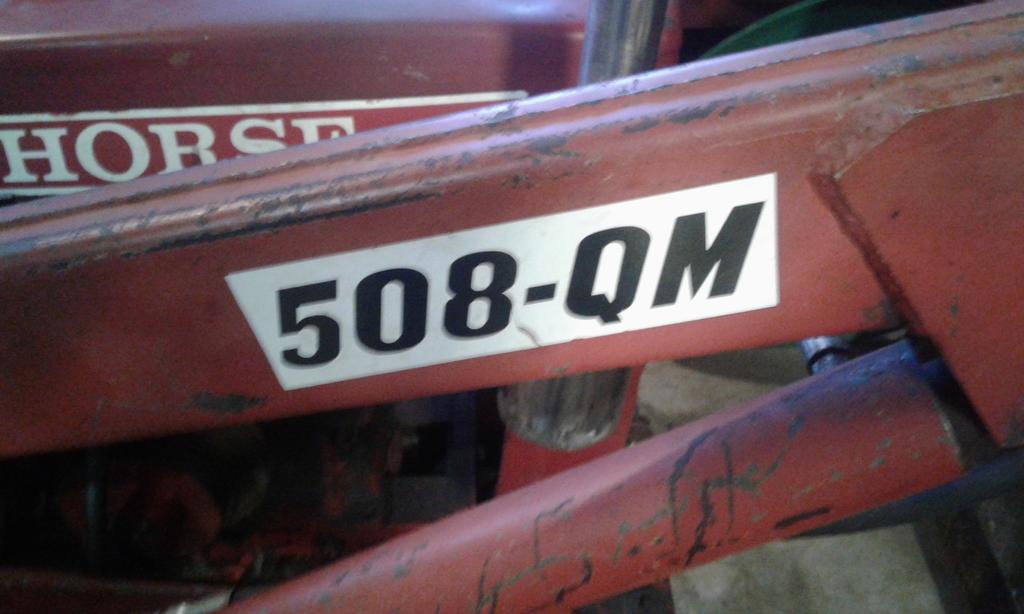

Richwoock 3 #1 Posted January 5, 2019 I JUST BOUGHT a C120 so I'm told It has A ARK frnt endloader the dash shows the shift pattern as fwd- nut - rev but it has A 3spd hi/lo shifters I'm thinken the trans was changed at some time the tag reads 61-12 k 502 16804 s/n 608 that's all I can make out Share this post Link to post Share on other sites

gwest_ca-(File Mod) 12,478 #4 Posted January 5, 2019 Click on the fuzzy picture 14 files on this model https://www.wheelhorseforum.com/search/?&q="61-12KS02"&type=downloads_file&search_and_or=or&sortby=relevancy Garry Share this post Link to post Share on other sites
KC9KAS 4,746 #5 Posted January 5, 2019 (edited) 1 hour ago, Richwoock said: 61-12 k 502 61-12K S 02 is a 1976 C-120 Auto to Got to love a with a FEL! Edited January 5, 2019 by KC9KAS 1 Share this post Link to post Share on other sites

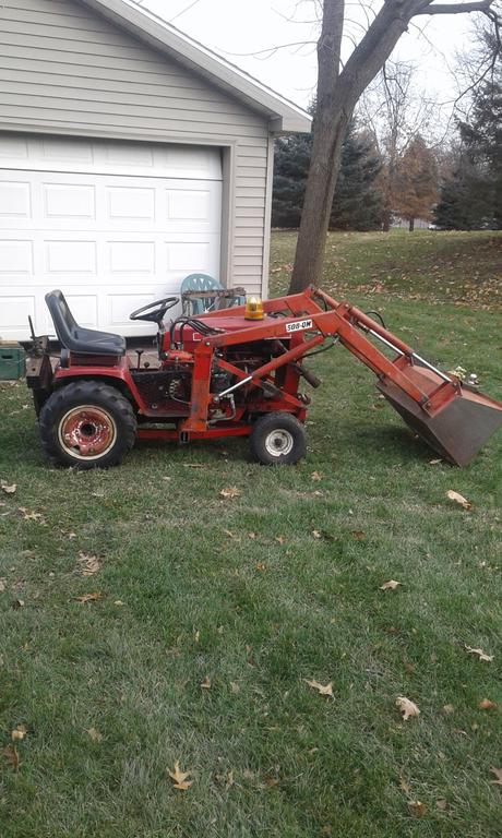

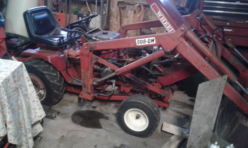

Richwoock 3 #14 Posted February 5, 2019 Just A couple pics of my purchase test drove and loaded on trailer unloaded and played a little parked in shop found No oil on dipst. pulled plug got a puddle about the size of a beerglass coaster Any way A flush with 10-20 running and A fill with 30 w i''m thinking its Ok. would any of you let someoe test drive that Or am I at fault for not checking anyway the hydro punp sqealed like apig had A n A belt in the pto drive pulley 2.5 in. on pump tat made the pump to go over 5000 rpm I fixed that with a new 5 " pulley and A b belt It's getting in good shape would you like to hear more or am I boring you 1 Share this post Link to post Share on other sites

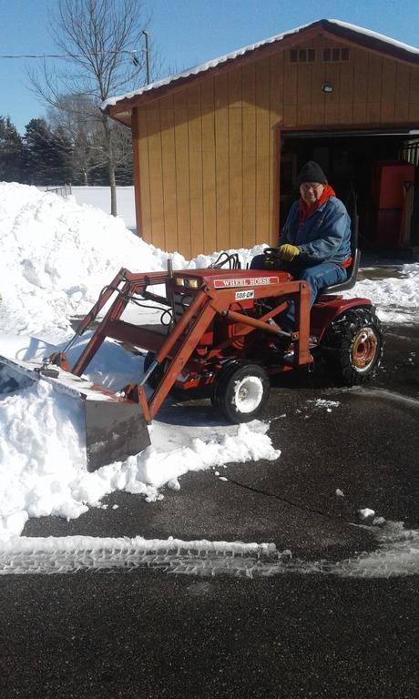

Richwoock 3 #16 Posted February 6, 2019 I DO HAVE aPIC. OF IT OUT IN THE OPEN I will put it on and continue updates thanks Note the rear weights 210 lbs rite behind the seat I moved them out back as the previous pic is showing Also the front wheels 6:00 x 6 gone lite weight lawnmower tires ,w/bushings. replaced with 6.50 x 8, 6 ply cubby wheels w/ brgs 1 Share this post Link to post Share on other sites
953 nut 68,782 #17 Posted February 6, 2019 10 hours ago, Richwoock said: Also the front wheels 6:00 x 6 gone lite weight lawnmower tires ,w/bushings. replaced with 6.50 x 8, 6 ply cubby wheels w/ brgs Good move, the tires on the front end of a loader take a lot of abuse. 12 hours ago, Richwoock said: 2.5 in. on pump tat made the pump to go over 5000 rpm I fixed that with a new 5 " pulley and A b belt It's getting in good shape would you like to hear more or am I boring you Too fast will just over heat the oil, Keep up the good posting. 1 Share this post Link to post Share on other sites
