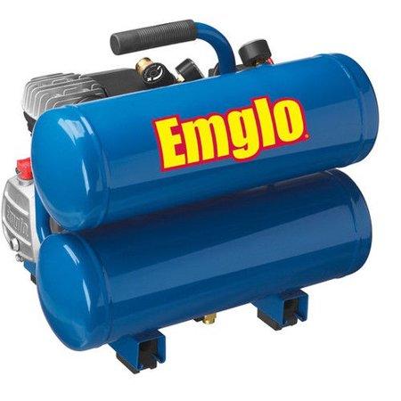

Mows4three 833 #3 Posted January 5, 2019 1 hour ago, OILUJ52 said: Is the air consumption high? The packaging has air consumption recommendations printed on the side. I think it wasn't advised to use with 1-3 gallon compressors, not preferred to use 4-7 and recommended to use 8 or more gallons. I have a duel tank Emglo portable compressor that I have used for years to power my Porter-Cable framing, roofing and finishing nailers. It worked well for me. It is a 4 gallons compressor. Share this post Link to post Share on other sites
