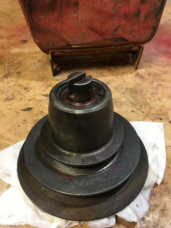

The Tuul Crib 7,354 #28 Posted January 3, 2019 Got home today and cleaned off this PTO clutch and it was so caked with rust that I thought there was no hope. Pulled it out of the electrolysis bucket cleaned it off and Wala ! The bearing spins perfectly and it is the one I will need for this tractor to be correct. I will need the correct drive pulley to put on the motor which didn't come with this tractor. Does anyone know the correct part number for this 1067 for the pulley, and maybe where I can find one? I will also need the PTO control arm and mounting bracket 1 Share this post Link to post Share on other sites

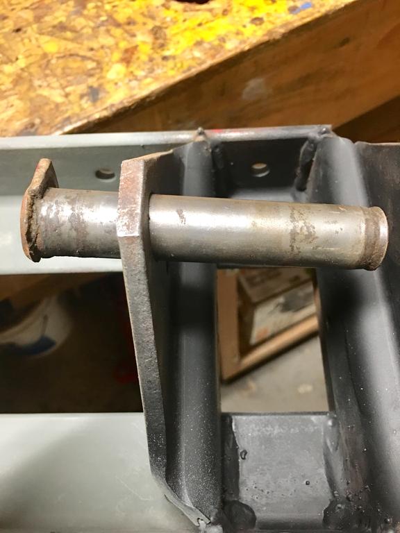

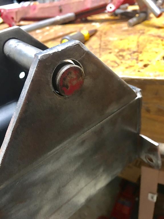

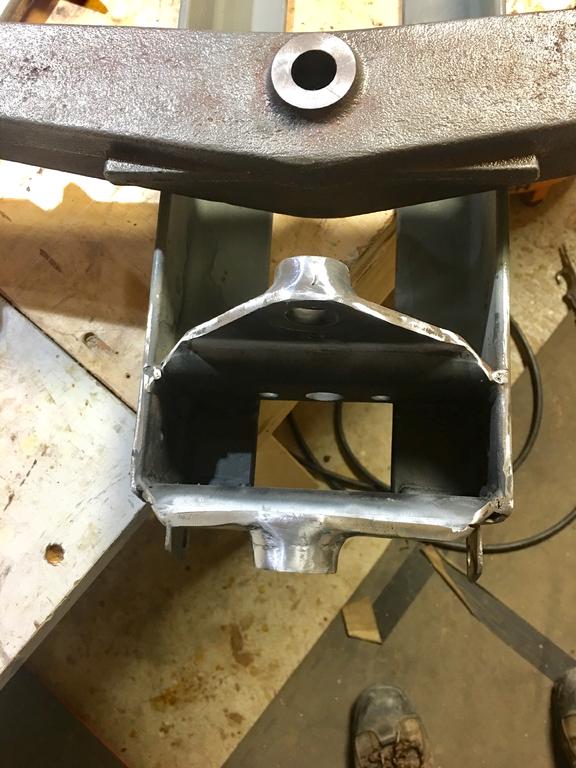

The Tuul Crib 7,354 #32 Posted January 8, 2019 So yesterday I got the frame all cleaned up and mostly primed and came to this point where the pin through the axle was a little warn out. The hole is rather large and will definitely have to address the issue. Thoughts of repair ?? Best solution? Share this post Link to post Share on other sites
ebinmaine 80,449 #33 Posted January 8, 2019 19 minutes ago, The Tool Crib said: So yesterday I got the frame all cleaned up and mostly primed and came to this point where the pin through the axle was a little warn out. The hole is rather large and will definitely have to address the issue. Thoughts of repair ?? Best solution? Randy, look at the thread by @jebbear on his (856?) Restoration. He does some extremely fine work there. Some of it is dedicated to the use of bushings in various places. It's a great read. 1 1 1 Share this post Link to post Share on other sites

jebbear 386 #38 Posted January 8, 2019 12 hours ago, The Tool Crib said: Thoughts of repair ?? Not sure of what all that you have access to in the way of tools (welder, lathe, etc), but as Eric mentioned above, the repair that I did on mine came out rather well if I do say so myself. I can’t figure out how to post a direct link to the page with this crazy iPad, but if you find my thread, it’s on the 3rd page of posts. The fix was pretty basic, but did require torches to braze the bushings in and a lathe to make a new pin. If you need any additional info, be glad to help. 1 1 Share this post Link to post Share on other sites

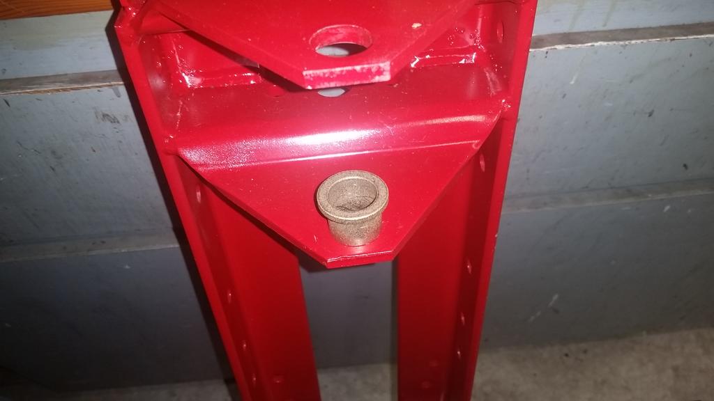

WHX?? 57,879 #39 Posted January 8, 2019 (edited) I did the bushing thing in my 1067 build but with no welding. A welder I am not. I drilled the hole out to 7/8" or 1" and loctited a x 3/4 oil lite bushing in. The pin & plate are available from Toro yet & reasonable. I think it was about 15 from a toro dealer. Other guys here make the pins as well. Edited January 8, 2019 by WHX21 5 1 Share this post Link to post Share on other sites

The Tuul Crib 7,354 #47 Posted January 9, 2019 I have some ideas for this fix on the front axle pin slop .when I get it done I'll post the progress. This will take some thought! Share this post Link to post Share on other sites

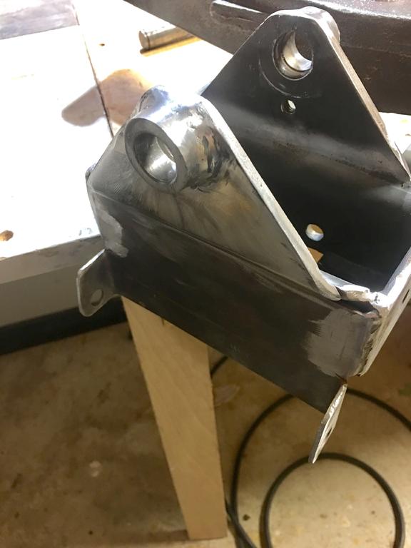

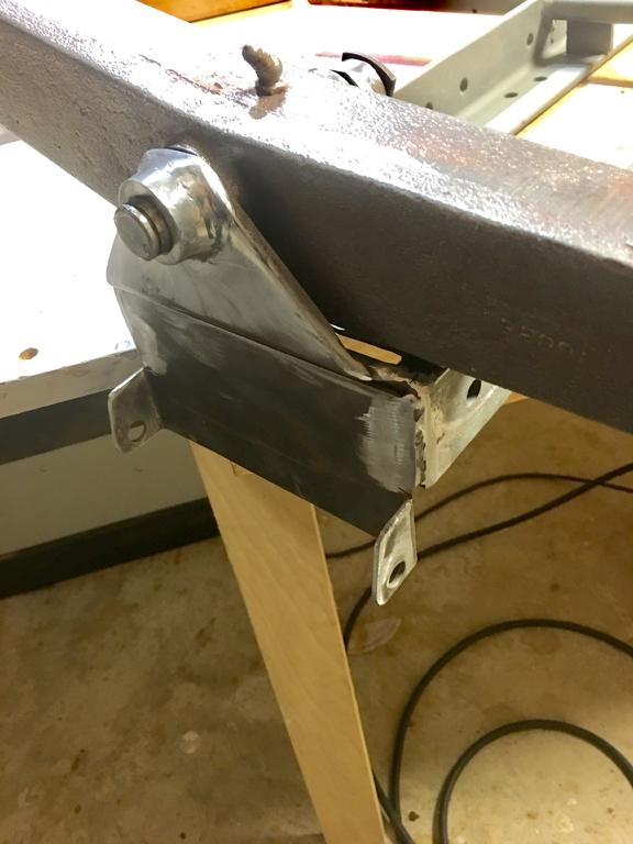

The Tuul Crib 7,354 #49 Posted January 9, 2019 Here is the fix that I come up with for this frame on the 1067 added a collar in front and back and made a new pin which ended up being a little longer but it sure took out the slop! 4 1 Share this post Link to post Share on other sites
WHX?? 57,879 #50 Posted January 9, 2019 First look at that first pic I thought what did that clown do to that rear bracket. 2nd pic shows the first is just the camera angle! Look good and a good fix for another 50+ years. Nice job on smoothing out those welds! 1 Share this post Link to post Share on other sites
