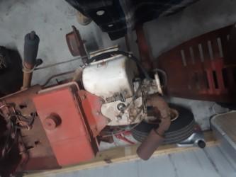

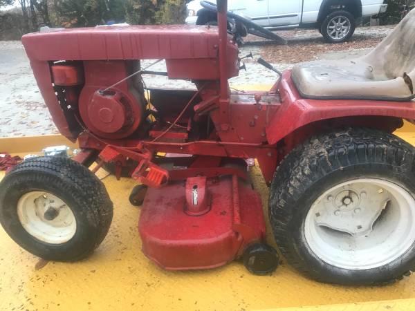

upstate yank 219 #1 Posted December 31, 2018 well guys i did it again ;bought another horse which is less then an hours drive ;i question myself as why i do this but anyways the seller wanted 150.00 for everything i was able to get him down to 75.00 for all '' yes the motor has been changed out and it is a pull cord type ;the seller said it is a 7 horse but i won't be sure till i see it tomorrow ;it is a model 875 according to the decals on the hood' really i'm not sure even if it will start after tinkering with it but parts are always good' check it out and thoughts would be appreciated or should i walk away ;and yes the sifter lever is on the seat not sure if it is busted or just came off ' 4 Share this post Link to post Share on other sites
JERSEYHAWG / Glenn 4,590 #2 Posted December 31, 2018 Nice patina on that one, price was right. Glenn 1 Share this post Link to post Share on other sites
The Tuul Crib 7,354 #3 Posted December 31, 2018 We all question ourselves and there is no definitive answer to it. It's the thrill of the hunt and when you get home the fun begins! All you can do is knock a wall on the shed and add more square footage for another ! Looks like it originally had a Tecumseh engine to begin whith by the color of the tank.Congrats keep us updated!' 1 Share this post Link to post Share on other sites
upstate yank 219 #4 Posted December 31, 2018 thanks guys and yes i am going to have to build another shed as now this makes 8 will it ever end ;sure better then the scrap yard ' as far as the motor once i get it home i can have more time to check it out ;at times we need to be in the right place at the right time ; i will keep you posted Share this post Link to post Share on other sites

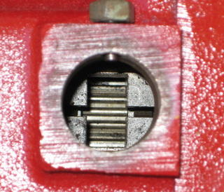

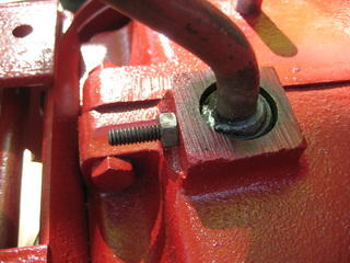

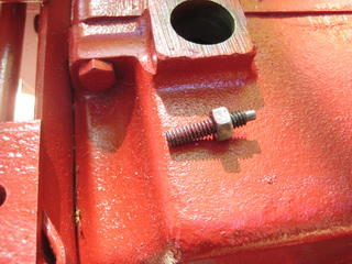

953 nut 70,344 #5 Posted December 31, 2018 You got a good deal there. Don't worry about your new found addiction, you are in good company! 49 minutes ago, upstate yank said: sifter lever is on the seat If it has just pulled out there is an easy fix. If your shift lever comes out of the transmission or is stuck in one gear first back out the “Dog-point” screw that retained the shifter. Take a look in the hole the shifter came out of to be sure it is in neutral as shown above. Inspect the dog-point to be sure it is in good condition and back off on the locking nut a couple of turns. Insert the shifter and run the dog-point into the dimple in the shift lever collar snugging it up with an allen wrench, don’t tighten it. Be sure the shifter works smoothly then tighten the lock nut while holding the dog-point steady with the allen wrench. 2 Share this post Link to post Share on other sites

upstate yank 219 #8 Posted December 31, 2018 3 hours ago, 953 nut said: You got a good deal there. Don't worry about your new found addiction, you are in good company! If it has just pulled out there is an easy fix. If your shift lever comes out of the transmission or is stuck in one gear first back out the “Dog-point” screw that retained the shifter. Take a look in the hole the shifter came out of to be sure it is in neutral as shown above. Inspect the dog-point to be sure it is in good condition and back off on the locking nut a couple of turns. Insert the shifter and run the dog-point into the dimple in the shift lever collar snugging it up with an allen wrench, don’t tighten it. Be sure the shifter works smoothly then tighten the lock nut while holding the dog-point steady with the allen wrench. 3 hours ago, 953 nut said: You got a good deal there. Don't worry about your new found addiction, you are in good company! If it has just pulled out there is an easy fix. thanks for the input i will know more about the shifter tomorrow once i get it back home and yep i think i did good as well with the price of everything ;i will keep you posted If your shift lever comes out of the transmission or is stuck in one gear first back out the “Dog-point” screw that retained the shifter. Take a look in the hole the shifter came out of to be sure it is in neutral as shown above. Inspect the dog-point to be sure it is in good condition and back off on the locking nut a couple of turns. Insert the shifter and run the dog-point into the dimple in the shift lever collar snugging it up with an allen wrench, don’t tighten it. Be sure the shifter works smoothly then tighten the lock nut while holding the dog-point steady with the allen wrench. Share this post Link to post Share on other sites

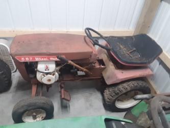

ol550 879 #9 Posted December 31, 2018 Maybe it's my eyes, but I see 657 0n the hood. An 875 would be a hydro. 1 Share this post Link to post Share on other sites
upstate yank 219 #10 Posted December 31, 2018 5 minutes ago, ol550 said: Maybe it's my eyes, but I see 657 0n the hood. An 875 would be a hydro. yep you are correct it seems my old eyes are bad as i thought i read 875 ;boy its though getting old ;thanks for bring that to our attention Share this post Link to post Share on other sites
stevasaurus 23,884 #11 Posted January 1, 2019 I was seeing 657 also...good eye Mike. The 657 would have had the 6 hsp Tecumseh. Nice horse, put a K-181 8 hsp Kohler on it and change the sticker to say 857. The 657 is more on the rare side though. 1 Share this post Link to post Share on other sites

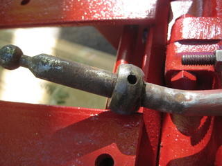

upstate yank 219 #12 Posted January 1, 2019 thanks guys and for sure it is rare but it seems pictures at times do not show everything as i did leave this morning to pick it up as it was only about a 45 minute ride but i came home with out it as i mentioned the gear shift was laying on the seat so after raising the seat i noticed the shiftier was busted right off where it sets inside ;there is no way to fix it as it is so rusted even the dog point screw that holds it in and trying to remove it for sure that would bust as well ;i checked the tires and the fronts were good but the back ones well split around the rims torn apart really ;the owner said he would try to weld the shiftier back on but really i have my doubts ; now if he can repair it for sure i might consider going back ;the pull cord cover is busted as well ; the rope will not go back in as he says the spring might be busted inside ;again some just show pictures of the good things not the bad things ;plus there is a battery tray but no starter on the motor or wires even if there is a key switch ;sure it is old and the price was right but the cost to bring it back to life would be quite steep ; dragging it out of the woods after 20 years of sitting well weather does bad things to this oldies ; 1 2 Share this post Link to post Share on other sites

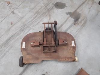

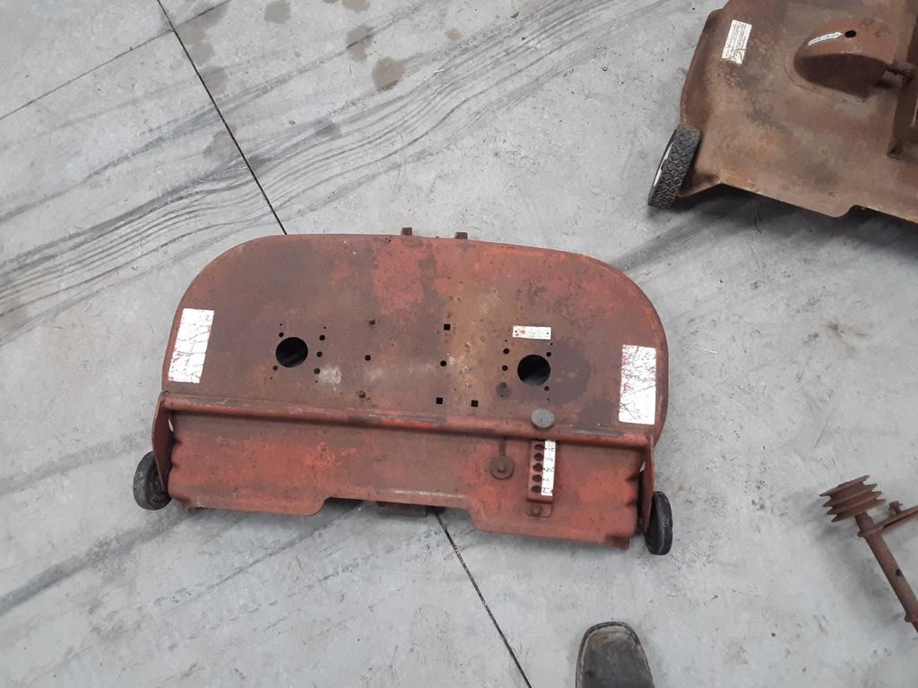

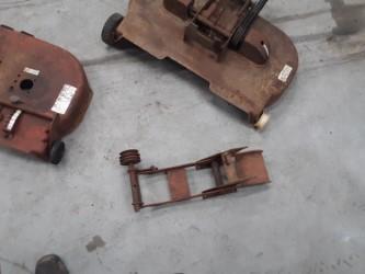

WHNJ701 4,173 #14 Posted January 2, 2019 (edited) 75 bucks for all that and you didn't buy it? it's still a great buy just for the parts, the 2 mower decks are worth it Edited January 2, 2019 by jabelman Share this post Link to post Share on other sites
upstate yank 219 #15 Posted January 2, 2019 the offer is still there as the owner is going to try to fix the shiftier and let me know; so it is not a wash out just yet; besides sure the pans might have been worth it and i am sure they were but really what good is the tractor if you can't shift it and the pull start is busted ;and there were really no parts i could use on my others i have being a 6 horse; plus not knowing if the motor is any good ;tires are shot as well ;again it is not a wash yet ;the pans sure i could use the parts but it was a package deal ' 1969-charger 10 automatic 1998-14 horse magnum standard with a tiller -chains and deck 1974-B-80-2 decks complete 1972-commando 8 with deck 1967-model 1076 with deck and plow -automatic model unsure ;8 horse briggs with the deck pictures attached 1 Share this post Link to post Share on other sites

stevasaurus 23,884 #18 Posted January 3, 2019 I'm sure one of our vendors...A to Z would have the shifter. Easy find and inexpensive. I would drain the trans, take it off the horse and open it up. Even a badly rusted transmission can be salvaged with electrolysis. It will take about $150 to replace all the bearings and seals. Open it first and show us some pictures. 1 Share this post Link to post Share on other sites

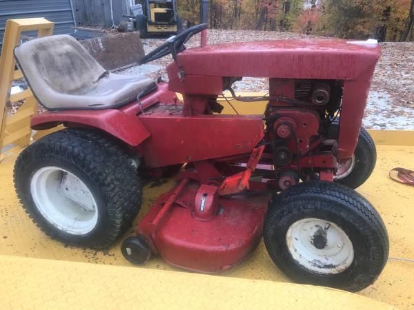

upstate yank 219 #21 Posted January 5, 2019 well guys the old girl is here it sure is going to take a lot of elbow grease to clean it up' the carb for sure will have to be rebuilt'the seat well frame rusted to bits but at this time that is the least of my worries as trying to get the busted part of the shiftier out and not busting the dog screw as it is rusted really bad ;oh for sure it will keep me busy ;but at least it isn't going to the scrap yard ;the decks are alright but the pulleys are froze up 'again in time ;Rome wasn't built in a day as the old saying goes ' 1 Share this post Link to post Share on other sites
upstate yank 219 #22 Posted January 6, 2019 59 minutes ago, upstate yank said: well guys the old girl is here it sure is going to take a lot of elbow grease to clean it up' the carb for sure will have to be rebuilt'the seat well frame rusted to bits but at this time that is the least of my worries as trying to get the busted part of the shiftier out and not busting the dog screw as it is rusted really bad ;oh for sure it will keep me busy ;but at least it isn't going to the scrap yard ;the decks are alright but the pulleys are froze up 'again in time ;Rome wasn't built in a day as the old saying goes ' i forgot to mention also that at one time there was a starter on the motor as the bolt holes are there so many once i get a few things cleaned and hopefully fix the recoil i will find a starter for it .and yes fix the shiftier ; good things come to those who wait 1 Share this post Link to post Share on other sites
The Tuul Crib 7,354 #23 Posted January 6, 2019 6 minutes ago, upstate yank said: i forgot to mention also that at one time there was a starter on the motor as the bolt holes are there so many once i get a few things cleaned and hopefully fix the recoil i will find a starter for it .and yes fix the shiftier ; good things come to those who wait That's a Tecumseh I may have a starter for you send me a PM Share this post Link to post Share on other sites
953 nut 70,344 #24 Posted January 6, 2019 21 hours ago, upstate yank said: i forgot to mention also that at one time there was a starter on the motor as the bolt holes are there so many once i get a few things cleaned and hopefully fix the recoil i will find a starter for it .and yes fix the shiftier ; good things come to those who wait Make sure the flywheel has teeth for an electric starter. I had a generator with a pull start Tecumseh, bolt holes were there but no teeth on the flywheel. Share this post Link to post Share on other sites
upstate yank 219 #25 Posted January 7, 2019 3 hours ago, 953 nut said: Make sure the flywheel has teeth for an electric starter. I had a generator with a pull start Tecumseh, bolt holes were there but no teeth on the flywheel. thanks so much for the input 'i have not yet checked that but i will 'as now i am soaking the linkage for the carb as they are frozen up plus the brake pedal and the dog screw on the shiftier ;plus the pedal that engages the deck what a mess really ;the cables we all know after time get rusted so bad they need to be changed but that is normal ;the seat which is no good i tried to remove it but it seems the previous owner used a block of wood and attached it to the seat pan ;the bolts are so rusted and even with heat from a torch they are so stripped 'i am going to take this slow;i should had looked closer even the deck as the pulleys are frozen up and they will not turn even trying to remove the blades ;even though it is a rare horse made only one year the best thing was for the seller to keep it in the woods for another 20 years as i am so disappointed ;i might remove the motor and scrap the rest as it is not really what i expected even though so many here mentioned that i would be foolish not to take it for 75.00 ; but only if they really knew the issues ;'but i am not a quitter ;in time it will work out as again Rome was not built in a day ; i really appreciate you being so helpful Share this post Link to post Share on other sites
