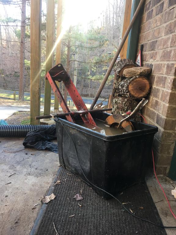

The Tuul Crib 7,354 #29 Posted January 6, 2019 I don't have before pictures on this particular cleaning but here is during tomorrow I'll pull it out and get it after picture 1 Share this post Link to post Share on other sites

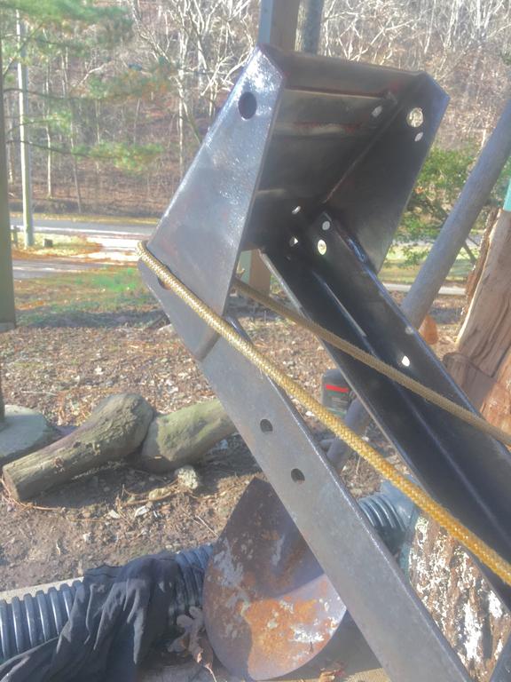

The Tuul Crib 7,354 #32 Posted January 6, 2019 OK I pulled it out of the solution this morning that being the washing soda it sat in it for around 15 hours. Not sure if you can tell by the picture but I took the wire wheel and it was effortless to clean the metal . No rust no paint! 1 1 Share this post Link to post Share on other sites

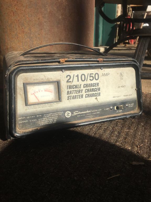

AMC RULES 37,259 #33 Posted January 6, 2019 Looks awesome... can we see the charger you're using too? Which works best... salt, or the soda? Share this post Link to post Share on other sites
The Tuul Crib 7,354 #34 Posted January 6, 2019 It's hard to tell lmo which works better . Makes sense that salt would be a little harder on the metal. I think from now on tho I will probably use washing soda, and as for the charger here it is! Nothing special but it is 27 years old and still works great! 2 Share this post Link to post Share on other sites

formariz 12,381 #36 Posted January 6, 2019 Try it on the Start position. Share this post Link to post Share on other sites
