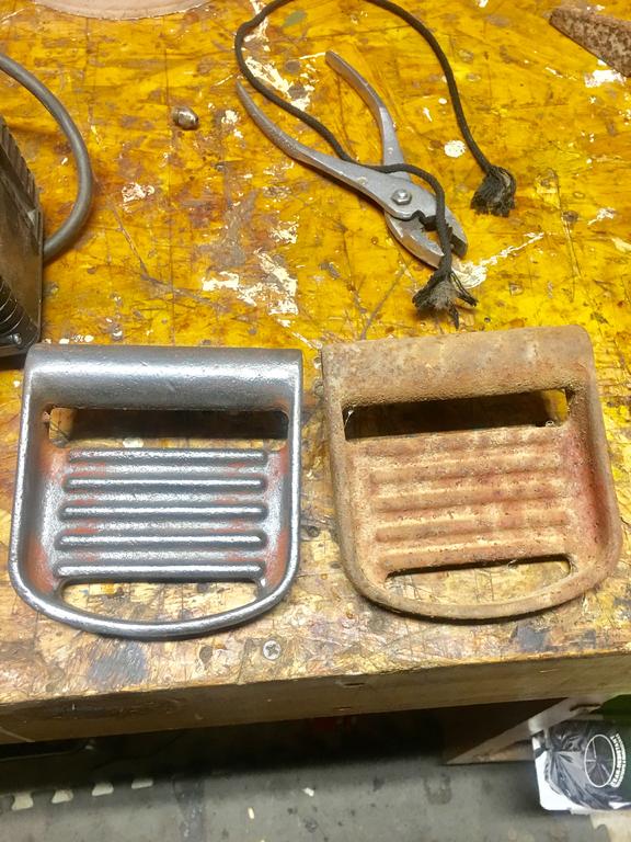

The Tuul Crib 7,354 #1 Posted December 30, 2018 (edited) Wow what a process this is. I built a 5 gallon bucket with five rods of half-inch rebar connected together and water and salt 10 hours to clean this stirrup! Cost me seven bucks! I just touched the wire wheel to it and BARE metal! So easy! Edited December 30, 2018 by The Tool Crib 2 3 Share this post Link to post Share on other sites
AMC RULES 37,260 #2 Posted December 30, 2018 Being in that salt bath is going to make it flash over with rust again overnight. Best to get into some primer with the quickness. Share this post Link to post Share on other sites
The Tuul Crib 7,354 #3 Posted December 30, 2018 I took it out of the bucket blew it down with my air hose. And it hasn't rusted over yet that's been two hours ago now the inside of the tank might be a little different that's my next set up . 1 Share this post Link to post Share on other sites

cleat 9,403 #6 Posted December 31, 2018 4 hours ago, The Tool Crib said: Wow what a process this is. I built a 5 gallon bucket with five rods of half-inch rebar connected together and water and salt 10 hours to clean this stirrup! Cost me seven bucks! I just touched the wire wheel to it and BARE metal! So easy! Can you go into more detail on exactly what you did and the salt mix ? Cleat Share this post Link to post Share on other sites
The Tuul Crib 7,354 #7 Posted December 31, 2018 3 minutes ago, cleat said: Can you go into more detail on exactly what you did and the salt mix ? Cleat I have a five gallon bucket with five one foot long rebar attached to the bucket around the perimeter .Ran copper wire to each one of them all the way around . This is the positive connection. Fill the bucket with water to the top of the rebar. suspend piece to be cleaned with wire attached and connect that wire to the negative. As far as salt amount I added about a teaspoon. As soon as I clean out the bucket on my next go around I will try and take a picture and post it Share this post Link to post Share on other sites

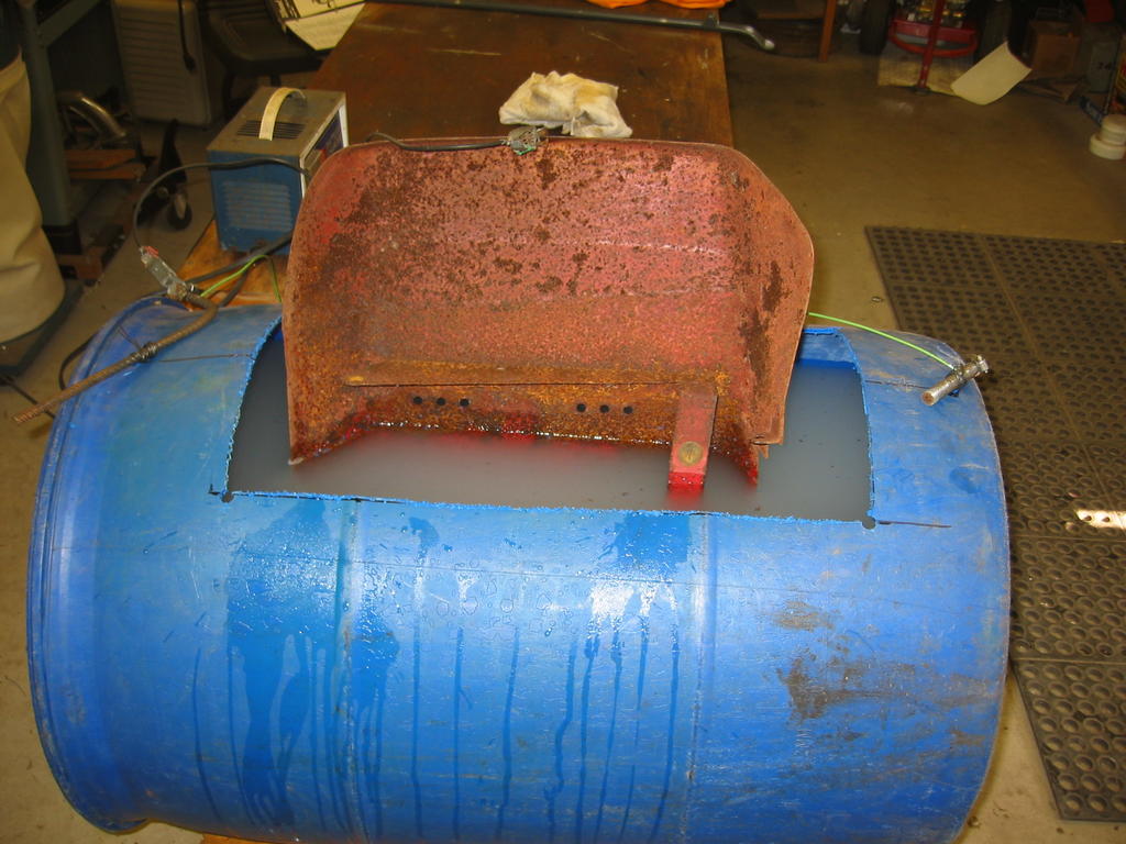

pfrederi 21,274 #17 Posted January 4, 2019 For bigger stuff... I use old disc brake rotors (free at most any service station) one on each end of the tank, washing soda and an old battery chargerf. She sits on a movers dolly so I can move it about as it is a bit heavy 2 Share this post Link to post Share on other sites
