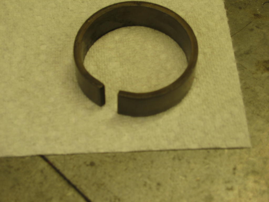

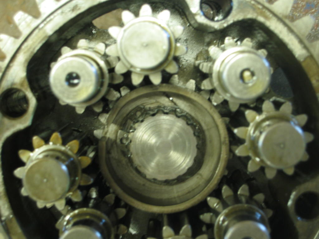

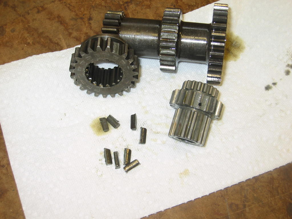

pfrederi 19,941 #1 Posted December 30, 2018 A couple months ago my C-141 8speed locked up. Swapped it out and put the bad one on the shelf. With all this talk about making 8 pinions Ltd Slip I decided we needed a little more action so I opened her up fix it and run a test. 8 teeth had broken off 3 gears. Found all the teeth and lucked out to find replacement gears in my tranny spare parts. Put one of Lowell's springs in the 8 pinion and put her back together. I did notice it was a lot easier to get his spring in the 8 pinion than when I put springs in 10 pinion units. Hooked up my tranny tester and filmed the results. MVI_0273.AVI MVI_0272.AVI 4 Share this post Link to post Share on other sites

953 nut 64,278 #5 Posted December 30, 2018 The spring you were using was a new spring from Lowell, right? Correct me if I am wrong, but aren't the axle gears in the four pinion, eight pinion and ten pinion units all the same outside diameter? Kind of odd that it wouldn't go in the eight pinion as tightly as the ten. Share this post Link to post Share on other sites
pfrederi 19,941 #6 Posted December 30, 2018 Yes it was a brand new spring. The extra pinions on a 10 make for a tighter circle for the spring to fit into. Share this post Link to post Share on other sites

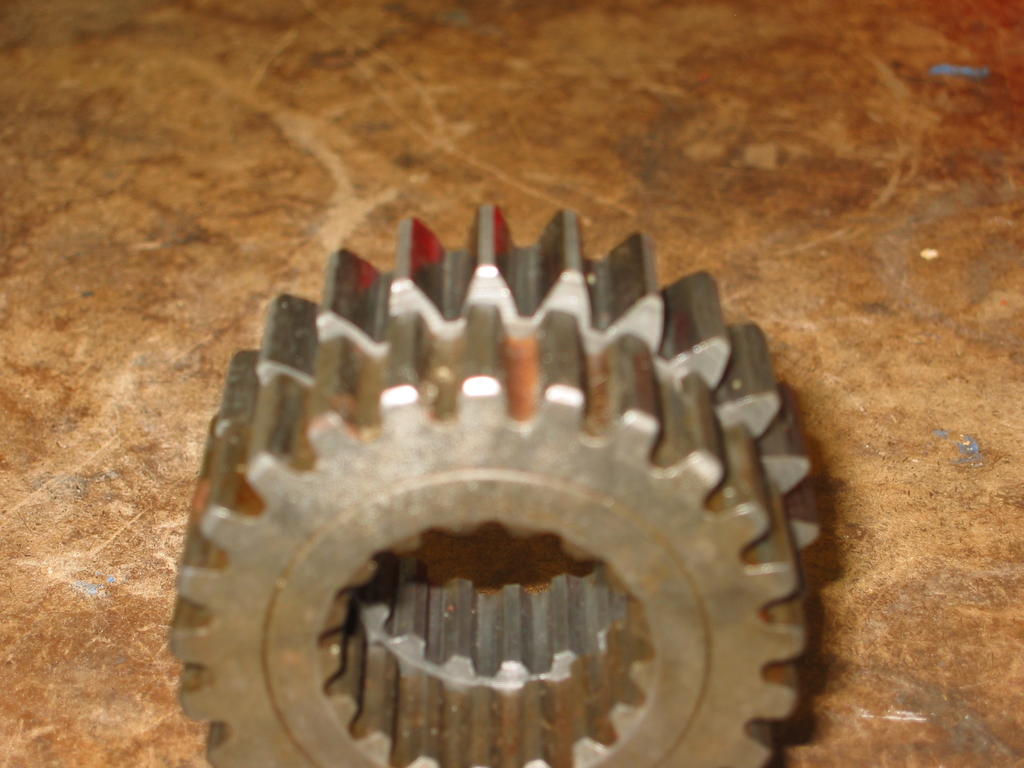

stevasaurus 23,620 #7 Posted December 30, 2018 I think the outside of the axle gears in the 8 and 10 are the same...not sure about the 4 pinion axle gear. They have different part numbers, but then they would. the 4 pinions are 1" axles. 1 Share this post Link to post Share on other sites

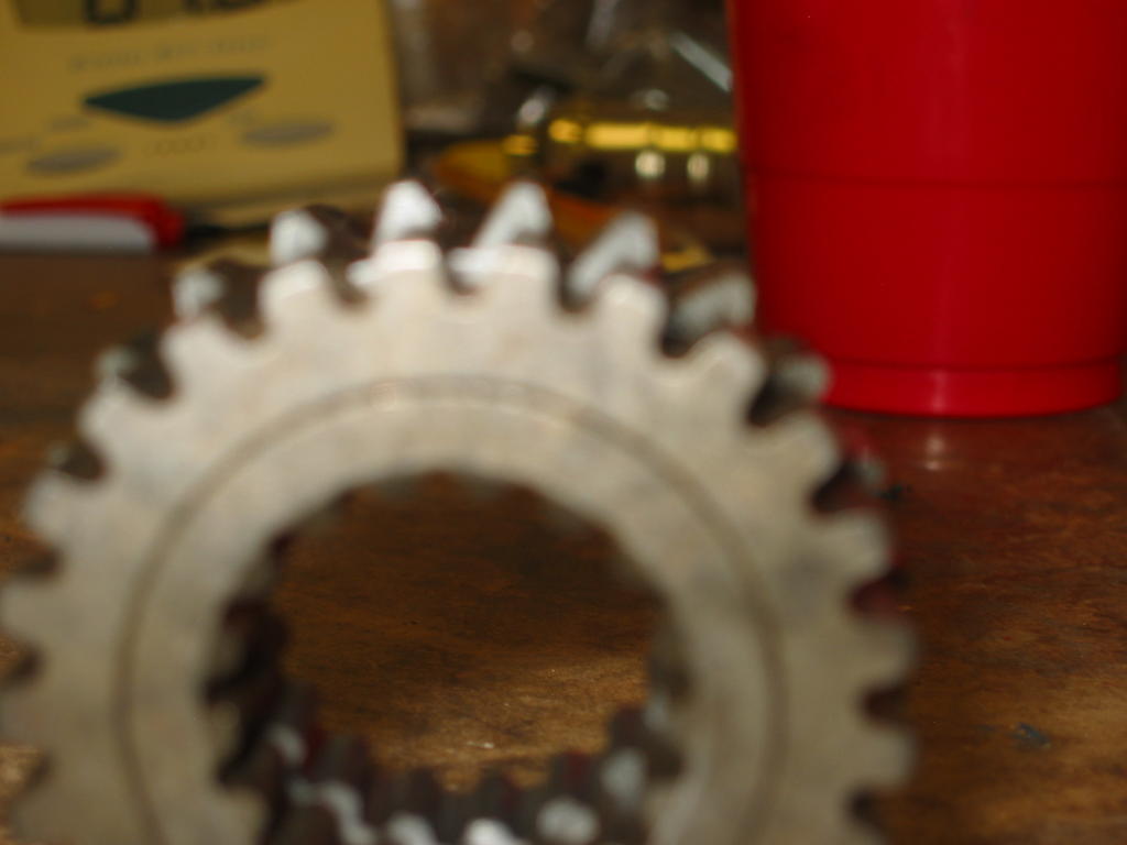

pfrederi 19,941 #8 Posted December 30, 2018 The axle gears for 10 pinions are different than the 8 speed. The have a different gear tooth design and are slightly small outside diameter (front gear in Picture is 10 pinion) Also I tried putting a used 10 pinion spring in an 8 pinion it went in easily just like Lowell's. i also tried one of Shawn's and it went in easily as well. As I said getting the spring in a 10 pinion is much harder., 1 Share this post Link to post Share on other sites
stevasaurus 23,620 #9 Posted December 30, 2018 You know Paul, it looks like if you put both of those axle gears on the end of one axle, they would fit the axle and the difference would be the length of the teeth. The bottom of the teeth in both gears might line up. I think the jerking that you were getting is that part of the spring that is open hitting one of the pinions. It might be catching a little as it goes by. 3 Share this post Link to post Share on other sites
pfrederi 19,941 #10 Posted December 30, 2018 (edited) The 8 speed is bigger. 10 pinion OD 2.156 Valley to valley 1.864 8 Speed OD 2.248 Valley to valley 1.890 Looking at my [picture above I think the jerkiness may be a result of the sort of flattened ends of the spring. Leaves a big space away from the pinion teeth as it passes..not snagging slipping.... Edited December 30, 2018 by pfrederi 3 Share this post Link to post Share on other sites

Cetan08 311 #12 Posted December 31, 2018 So we have concluded that you cannot make an LS out of an 8 pinion with the spring from a 10 pinion if I am reading this correctly. It is my idea then to redesign the spring so that we can achieve our goal of making the 8 pinion an LS. I agree with the gap in the spring causing the jerking and the ease of installation indicating the need for a larger and stronger spring for the 8. 3 Share this post Link to post Share on other sites
pfrederi 19,941 #13 Posted December 31, 2018 (edited) 10 minutes ago, Cetan08 said: So we have concluded that you cannot make an LS out of an 8 pinion with the spring from a 10 pinion if I am reading this correctly. It is my idea then to redesign the spring so that we can achieve our goal of making the 8 pinion an LS. I agree with the gap in the spring causing the jerking and the ease of installation indicating the need for a larger and stronger spring for the 8. That is what I believe now. Wish you good luck with the fabricating a new spring. I will stick with the 10 pinions...they work for me. Haven't broken any and now with replacement springs available they will probably outlast me. Edited December 31, 2018 by pfrederi 2 Share this post Link to post Share on other sites

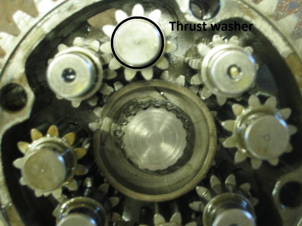

wallfish 19,379 #14 Posted December 31, 2018 1 hour ago, pfrederi said: That is what I believe now. Wish you good luck with the fabricating a new spring. After your hands on testing and actually working with those parts, do you believe a properly sized spring with more tension applied to the pinions could possibly work? Like most other members I have no need (at the moment) for a limited slip differential and my horses work perfectly fine the way they are now. My interest is more for the challenge of finding a simple way to make it work, if possible. That being said, hope people don't mind just throwing $&!# against the wall to see what sticks. Like using thin thrust washers on the shoulders of the pinions? or in conjunction with a spring? Recently had to work on a clutch slip system in the gearbox of a concrete core drill. The clutch action is accomplished by a thrust washer pinched between 2 gears. The clutched gear just spins on the shaft and only turns the other gears through the tension created by the pinched thrust washer. Once it reaches the friction limit, the gears slip. Tension and friction between those 2 gears can be adjusted by turning the nut that holds them together. Could this same principle be used on the shoulder edges of the pinions? Certainly some trial and error involved to find the "sweet spot" like thickness of washers,1 washer each pinion, 2 per pinion, only on 1/2 the pinions, tightening of the nuts, ect. ect. ect. 1 1 Share this post Link to post Share on other sites

R. L. Addison 300 #19 Posted January 1, 2019 The gap in the spring is a disaster in its self. That will wipe out pinions & sun gears (on ends of axles). 1 Share this post Link to post Share on other sites
Cetan08 311 #20 Posted January 2, 2019 13 hours ago, R. L. Addison said: The gap in the spring is a disaster in its self. That will wipe out pinions & sun gears (on ends of axles). I agree. That gap may be close on the 10 pinion but any gap is prone to catching on teeth and chipping. I will try one without a gap and a different shape. Share this post Link to post Share on other sites
Skipper 1,791 #21 Posted January 2, 2019 (edited) The spring is Originally bend a bit inwards in the gap, so it is supposed not to catch. Just info And you will want a small gap to allow the spring to flex a little bit, but clearly as little as possible. I may be getting a rear end with a 10 pinion soon. If so, I will take it apart and start experimenting on adapting to 8 pinion too Edited January 2, 2019 by Skipper 2 3 Share this post Link to post Share on other sites
R. L. Addison 300 #22 Posted January 2, 2019 It will need to be longer, & chamfering corners would help I think. 3 Share this post Link to post Share on other sites
