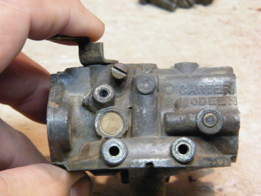

stevasaurus 23,884 #7 Posted December 30, 2018 See the adjustment screw in the left in this picture?? It is the Screw on top of the carb. Gently, bottom out this screw while counting the turns. Back the screw all the way out and spray it with carb clean. See the 2 holes in the shaft of this screw?? Make sure they are clean...carb clean and a very small piece of wire. Put screw back in and gently bottom out. Then back out the same number of turns. Should be 2 turns. Start up and let warm up...turn that screw about 1/4 to 1/2 turn in each direction while listening for the best engine RPMs...put screw at that point. Sometimes this is all that is wrong and you may not have to clean the carb. 1 1 Share this post Link to post Share on other sites
