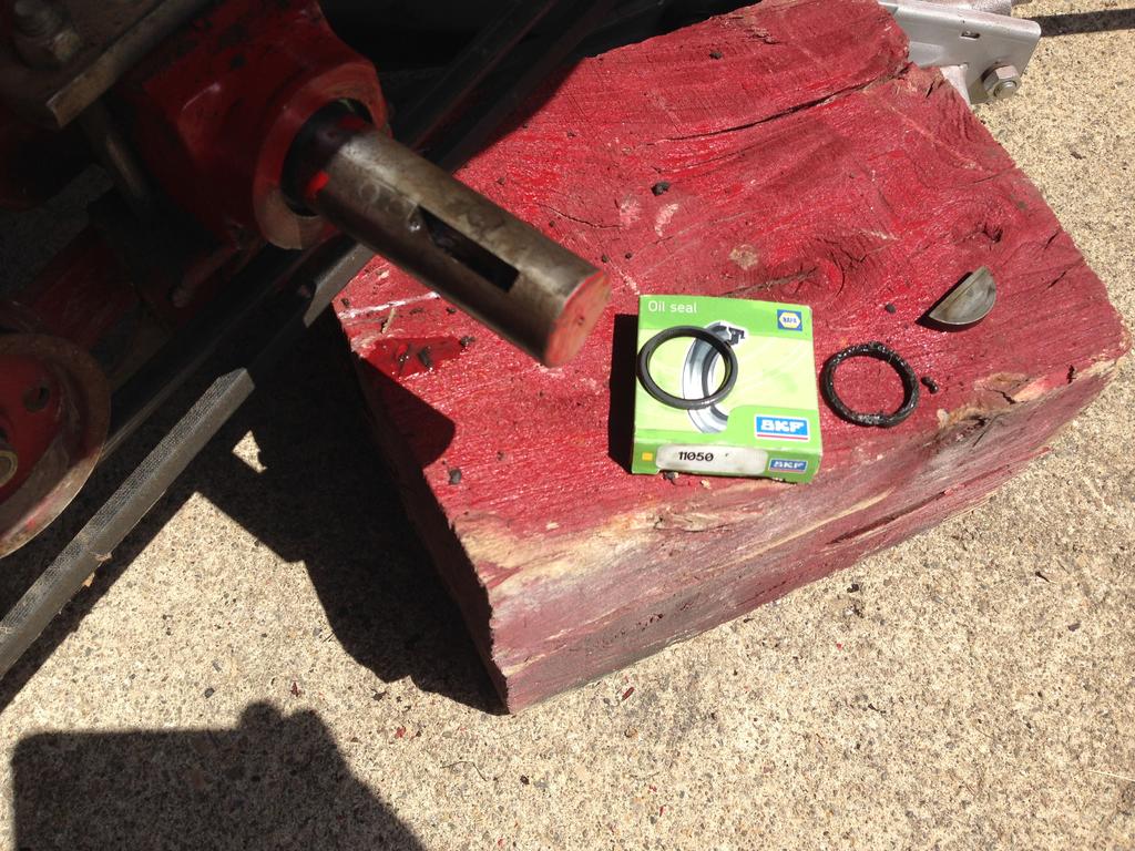

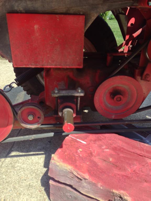

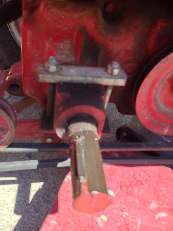

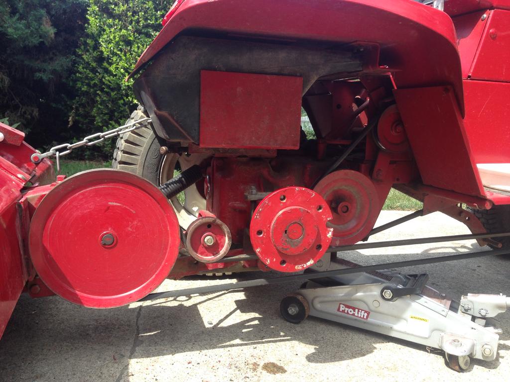

ebinmaine 77,516 #1 Posted December 30, 2018 I'm looking for tips and tricks or some kind of odd sized piece of pipe or tubing or whatever it is that you may find works well on 1" or 1-1/8" axle seals. Right now my only known method is not quite correct I'm sure but works okay. I very very patiently drive very very lightly with a small flat screwdriver and eventually it just goes into place. Share this post Link to post Share on other sites

ebinmaine 77,516 #14 Posted December 30, 2018 2 hours ago, OILUJ52 said: I have one hub that is slightly worn and marked as such. 1 1/8, I only have one machine with 1" axles and its good. I use a piece of electrical tape on the keyway, slide on the seal, of course with a little oil on the shaft, remove the tape and use the worn hub to tap the seal in place. This is the method I ended up using this morning. Took a couple minutes to sand down the axle shaft a little more which I was going to do anyways and then cleaned up and sanded out the hub that I was using as a puller. Deburred the groove and slid the seal mostly into place. The Hub works as its own Slide Hammer as well. Excellent method. Thank you for sharing that. 3 Share this post Link to post Share on other sites
