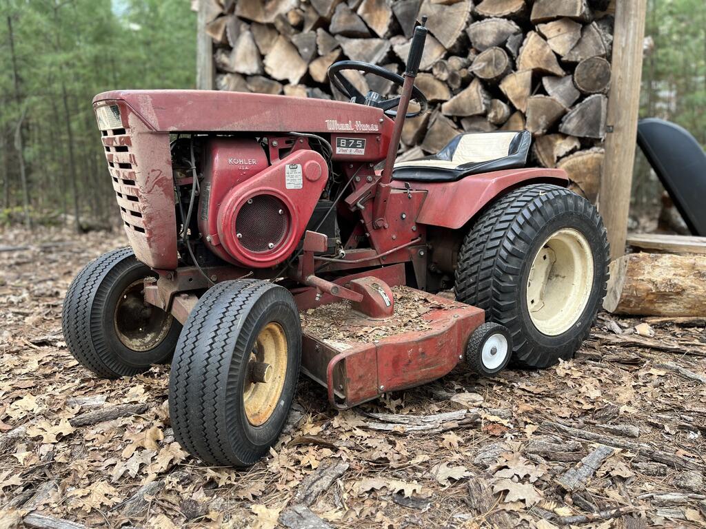

Pullstart 70,445 #201 Posted May 10, 2025 19 hours ago, Pullstart said: thoughts on this Briggs 16 miss? Ignition or fuel? the plugs are super wet and dark after maybe 15 minutes of run time. The Amazon carb naturally has zero adjustment. The fuel pump was leaking and missing some spring components. I ordered a carb rebuild kit, a replacement fuel pump and have the original one in my Berryman carb dip. Time to rebuild the original! Share this post Link to post Share on other sites
Pullstart 70,445 #203 Posted May 15, 2025 First real rides happened! Wiring is roughed in too! I’m fighting fuel issues, so no more test runs until the big show. I rebuilt the original carb, but the fuel adjustment screws were a different thread pitch and it instantly stripped out the pot metal body. Thanks @TonyToro Jr. and @Sparky in advance for the parts supply! @wallfish needs more show projects anyway! 1 3 1 Share this post Link to post Share on other sites

Pullstart 70,445 #210 Posted May 18, 2025 It’s with a heavy heart, I have found the turbulence inside that slim intake is a hindrance. It cannot be utilized, even though it literally took an 11 hour period to build! 1 Share this post Link to post Share on other sites
953 nut 67,224 #211 Posted May 18, 2025 2 hours ago, Pullstart said: I have found the turbulence inside that slim intake is a hindrance. It cannot be utilized, even though it literally took an 11 hour period to build! I bet @fast88pu could recommend a turbocharger that would breath (pun intended) new life into the old B&S. 1 Share this post Link to post Share on other sites
Pullstart 70,445 #212 Posted May 18, 2025 50 minutes ago, 953 nut said: I bet @fast88pu could recommend a turbocharger that would breath (pun intended) new life into the old B&S. He already has the crazy thing, is I can’t even get this to start (with the stock carb) with the intake on. A turbo would not fix that, as it needs to run in the first place to build boost, then the magic happens. 1 Share this post Link to post Share on other sites

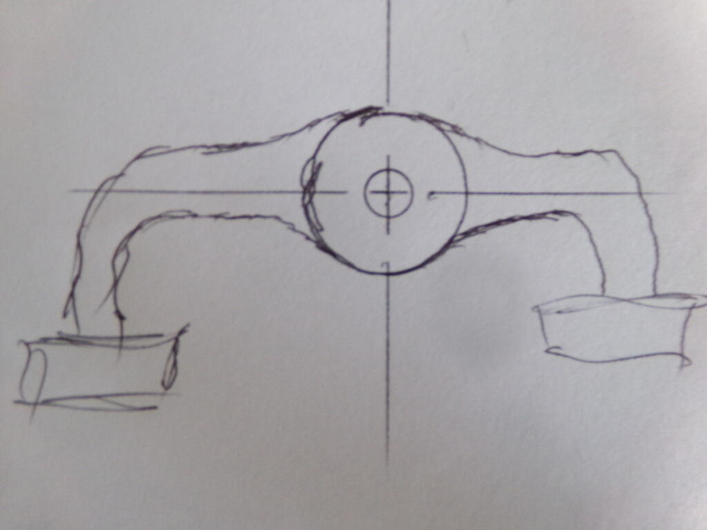

Ed Kennell 46,464 #213 Posted May 18, 2025 A spiral intake would probably work. 2 Share this post Link to post Share on other sites
Pullstart 70,445 #214 Posted May 18, 2025 Could you send me a cardboard aided design of that Ed Dog? 1 Share this post Link to post Share on other sites
953 nut 67,224 #215 Posted May 18, 2025 3 minutes ago, Pullstart said: cardboard aided design Well, now I know what CAD actually stands for. 1 1 1 Share this post Link to post Share on other sites
Ed Kennell 46,464 #216 Posted May 18, 2025 16 minutes ago, Pullstart said: Could you send me a cardboard aided design of that Ed Dog? I don't have Cad, but here's my EDD (Ed Dog Design. Using your existing round plate on the carb intake, build a dual intake spiral case to evenly distribute the air flow around the intake. With this larger area, the velocity will be much lower where it must make the 90 degree turn from horizontal to vertical. 2 Share this post Link to post Share on other sites
